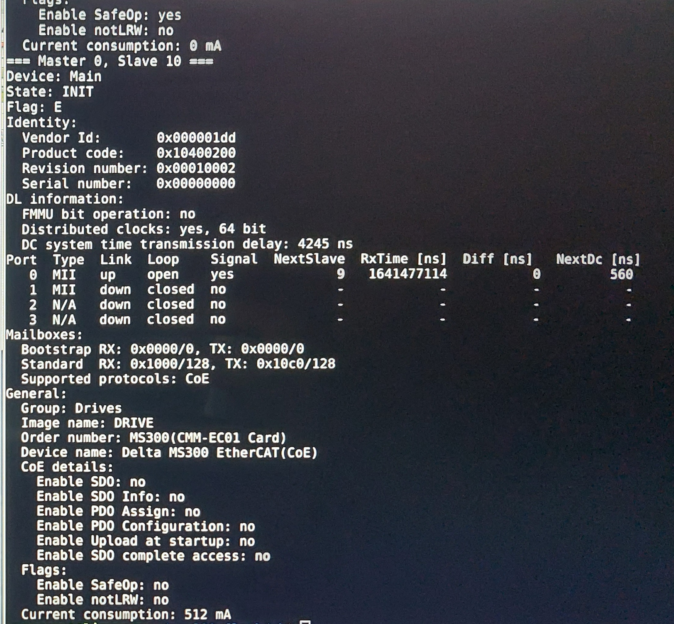

I'm trying to set up a MS300 ethercat card (CMM-EC-02) and a have some questions you may be able to answer.If I check the pdos with "ethercat pdos" there are no SM shown at all. If i check it with "ethercat slaves" the interface shows up but it stays in Init and the error flag "E" is shown. I guess the Sii is not configured propperly? So I installed Siitool and tried to generate the sii .bin file based on the deltas .xml slave description file. I can upload it to the interface card but it still stays in the preop state. Is there something I have to change in the .xml slave description before generating the sii .bin file? I'm trying to set it up with db1981's device specific driver (thanks for that!). Do I understand it correctly, that with the device specific driver I do not need a cia402 component to link the ms300 pins to hal like Twour tried to do in his first approach? Would be interesting to see how you linked it in hal.
I would realy appreciate any help or some example files I can have a look at. =)
I attached a picture of the "ethercat slaves -v" output and the .xml file (It's named EC-01 even though I downloaded the one for the EC-02 card)

hi,
no cia420 is needed.
I created sii data with twincat. (try to check the with twincat or ethercat configurator and the xml from delta website, if it still gots not preop or op then hardware bug...)
on this machine delta ms300 is used:
github.com/steup-engineering/sbs625-cnc-...r/tree/master/config
there is also an working sii bin file....

Thank you very much for you inputs! The example project helped me a lot to get it working!
How I got it running:
- First I downloaded your Sii .bin from the SBS625 project file onto the Ethercat interface card with "ethercat sii_write".
- Checked that the SM and PDOs are configured correctly with "ethercat pdos".
- Then i realized that the Ms300 card is still in init and the error flag is shown.
- I tried to get some more debugg information by attaching the USB cable. As soon as I touched the lid, the red error led disappeared ^^ So there was also a connection issue between the interface cards connector and the cable to the vfd..
- With your driver it worked perfectly (after I realized that the start up time is in ms and not seconds ^^)
Falls irgendwie möglich db1981, würde ich dir gerne einen Kasten Bier spendieren
Habe einige Abende mit debuggen verbracht. Danke!
