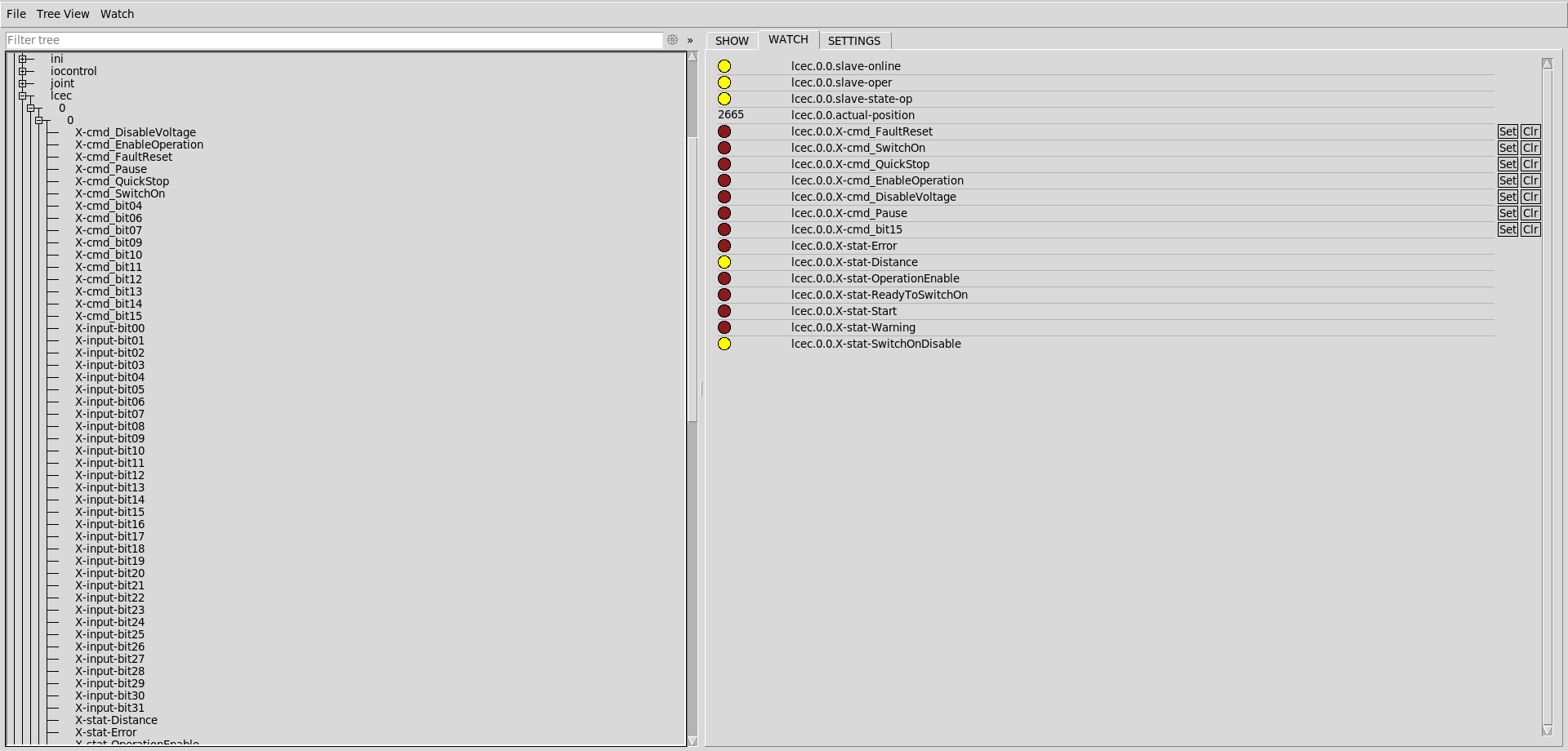

03 Dec 2022 23:24 #258462 by petervg
@ewax: I got the CS3E-D1008 working up to the point I can see all registers of the drive in linuxcnc using ethercat (see screenshot attached).
But Leadshine motion studio is buggy as hell and some items have not even been translated from chinese. You can't resize any windows to suit the text displayed and connecting to the drive is a hit or miss (but stable once it is connected). It's not an usb connection as you would think, but the drive has an internal usb-serial convertor and the software needs to connect as if it is a serial port.
In the background of motion studio (I have the latest version) it says "Ver 1.3.10 Alpha - for internal user only"...
So far the pc software is really rough but performs the basic tasks of setting up ethercat doable. Not a cheerfull experience, but besides setting the current to 6amps I didn't have to actually change anything so far. Standard settings allow you to use the drive over ethercat. I haven't tried tuning the motors yet, but since thy are closed loop steppers this should be a lot easier than servos.
I have cobbled together a working XML file for the drive, and the next thing is to figure out how to wire it up in the HAL file. I have attached my XML file for the C3SE-D1008 in this post.
One sidenote: I was able to testrun the steppers, and using a 48V powersupply I was able to reach 2000rpm without a load. So for a stepper that's nice, certainly because I'm only using half the allowed voltage on the drive.
