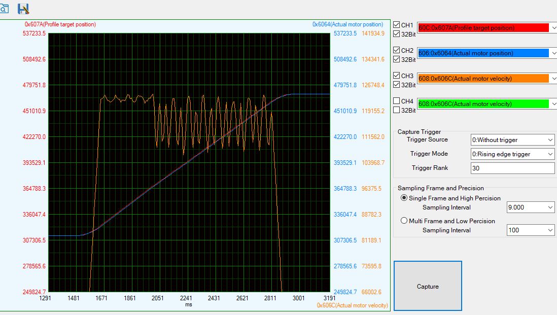

I'm using a fresh install of debian 11, RT kernel running (5.10.0-19-rt-amd64) compiled all from source and ethercat seems to work as it should (with an officially supported network card). I only have 1 drive and motor to test, so I took the sim_axis example and modified the X axis configuration to test the motor. When I try to jog the motor, the ramp up and first milliseconds of the coasting work great, but then the motor starts making funny noises and the rpm drops.
This is a graph from the motion control studio software where I can graph the internals of the drive, and you can clearly see the speed starts to fluctuate as in the video.
I've taken a look at the ethercat communications, but I have no TX errors and only 2 lost frames.
Could this be a ethercat configuration issue? If I run the motor using motion control studio (usb), the motor runs perfectly.

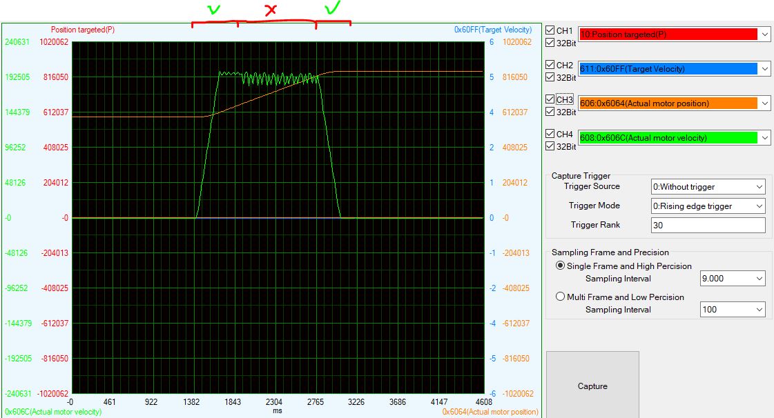

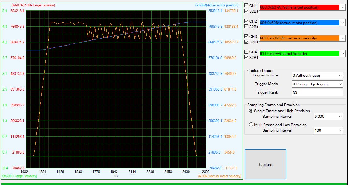

08 Dec 2022 21:31 #258913
by petervg
Replied by petervg on topic Leadshine CS3E-D1008 not running smoothly
I'm using position control by linuxcnc (CSP). Looking at the screenshot below, you can see the screenshots I took in leadshine motion studio for the target position (CH1 - 0x607A, in the XML file and commanded by linuxcnc) is set properly, and the actual motor position (CH2 - 0x6064) is following this relatively accurate even though the speed (CH3 - 0x606C) is quite erratic after approx 200mS being stable.
I took the same plot including the target velocity, and this stays at 0 because linuxcnc is set to use CSP.
In linuxcnc I can see exactly the same in the HAL scope...

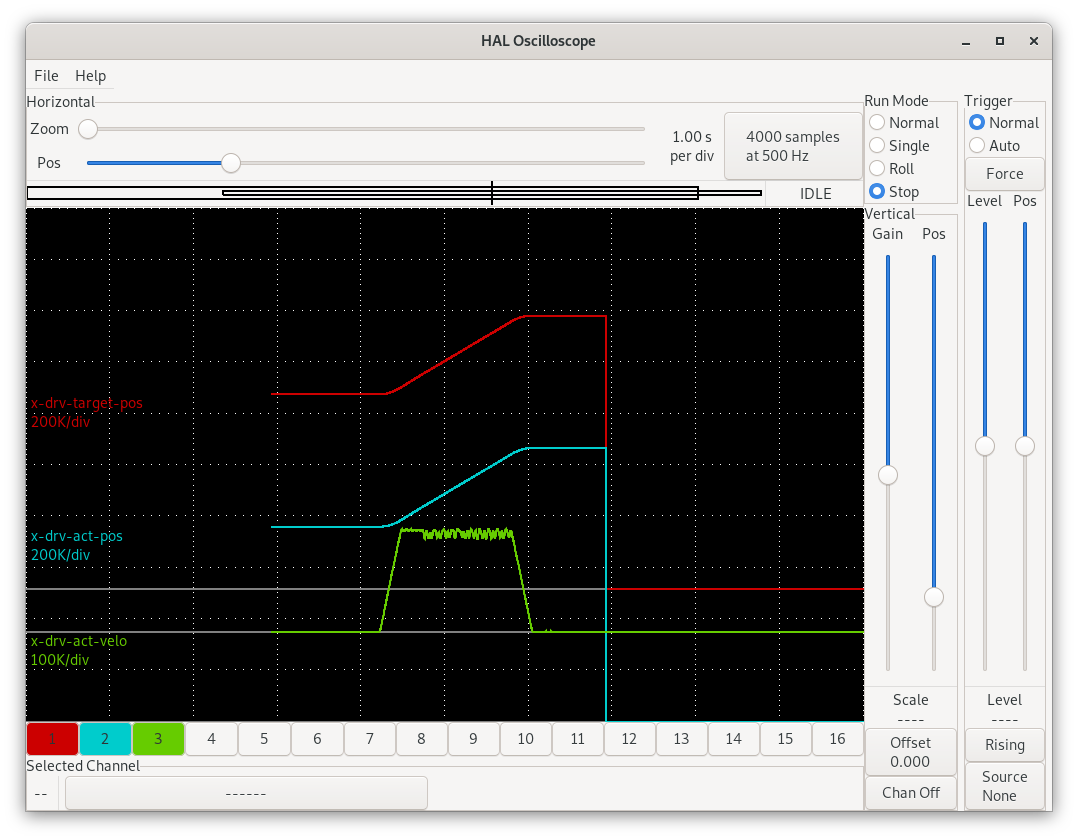

So what I think (and please do correct me if I'm wrong) is that this has to be a problem

Ok, just made an important discovery!
During the tests below, I was using the arrow keys to jog the motor. I now tested exactly the same using MDI commands, and with the MDI commands the motor runs as expected! I also tried running the axis demo file (the one "not intended for actual milling"
and the motor behaved as expected.
I also notice the time it takes for the motor to start behaving weird is always the same when I press the arrow keys. It doesn't matter if I set the speed to 45mm/min or 3000mm/min.
On to finding what makes the jog keys behave differently from MDI commands...
