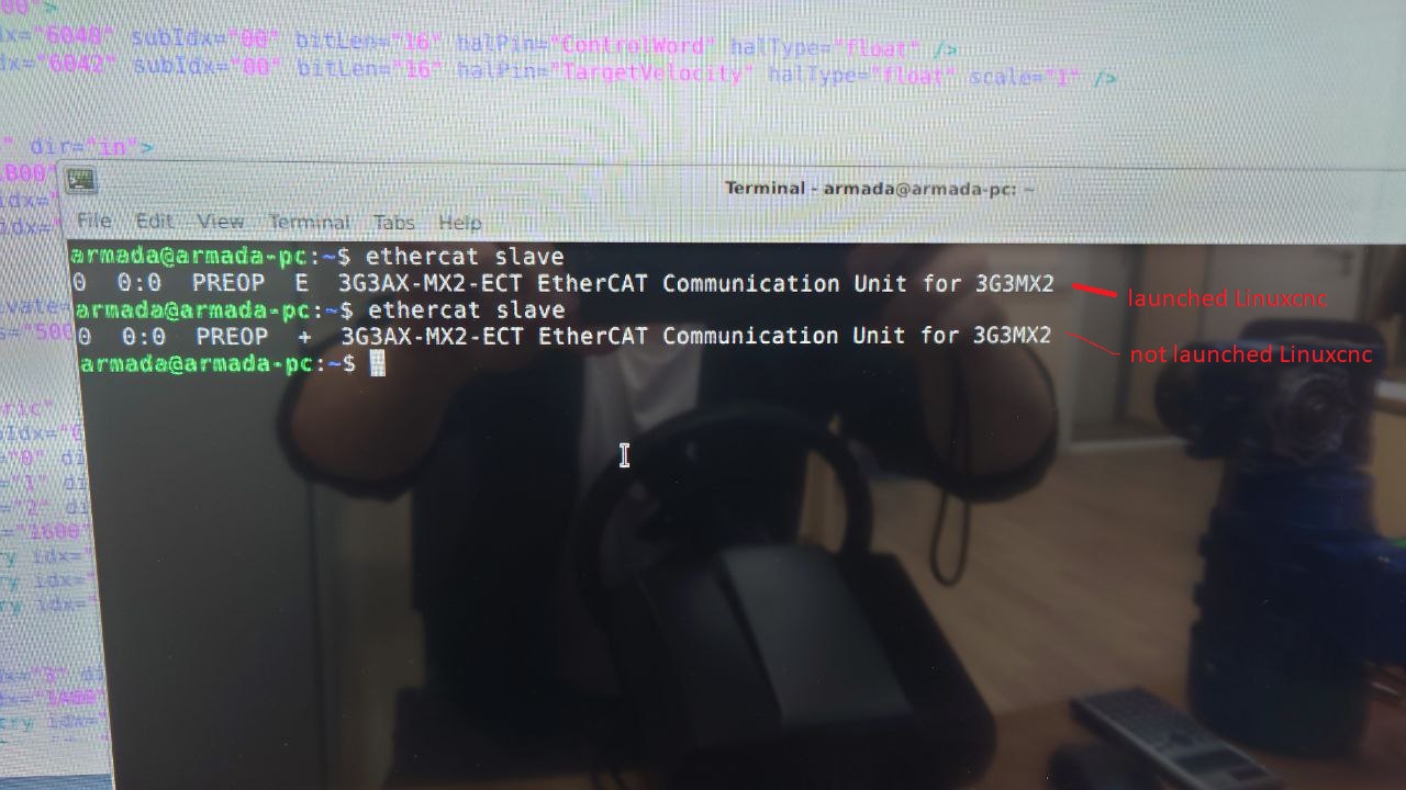

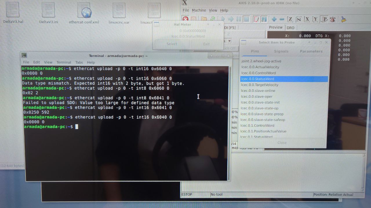

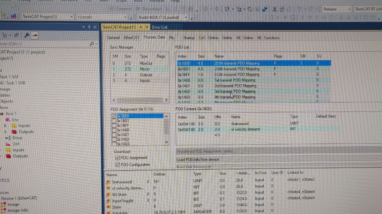

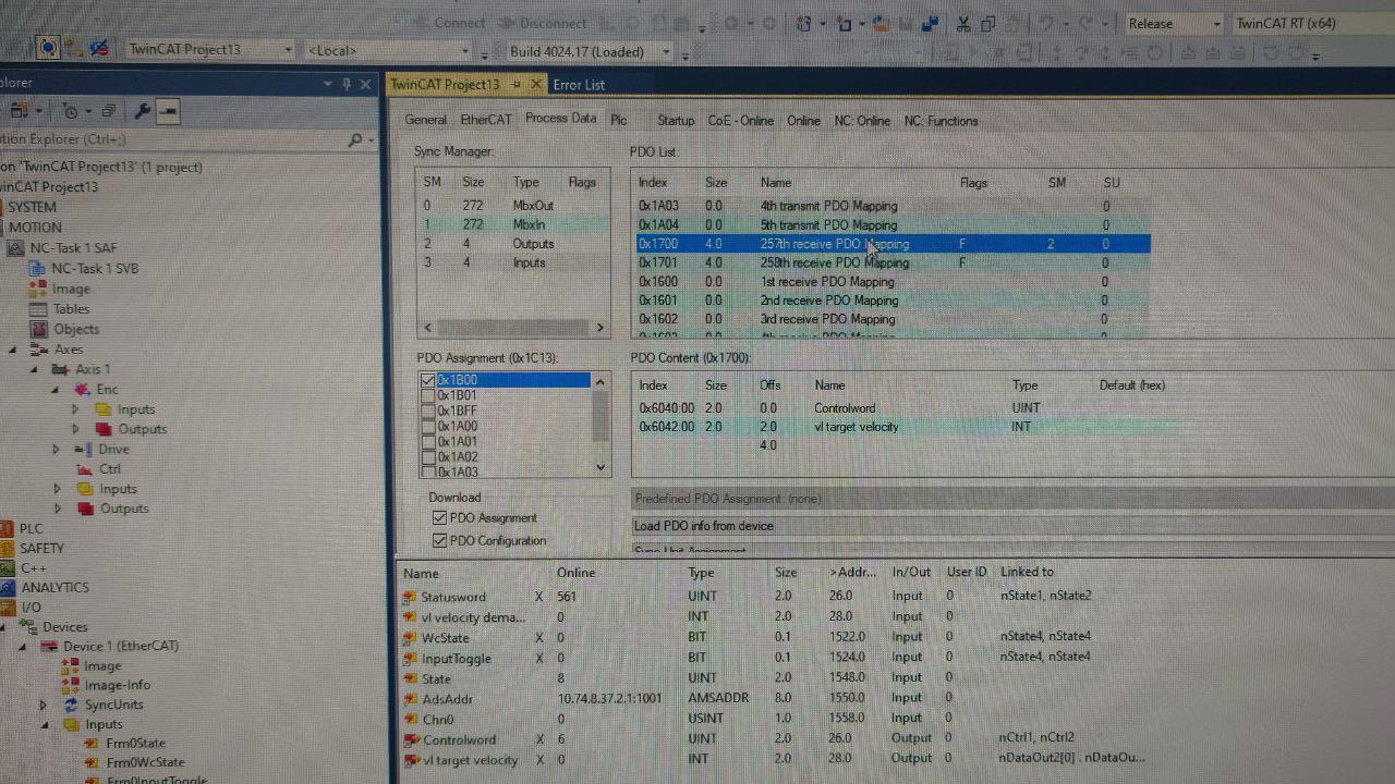

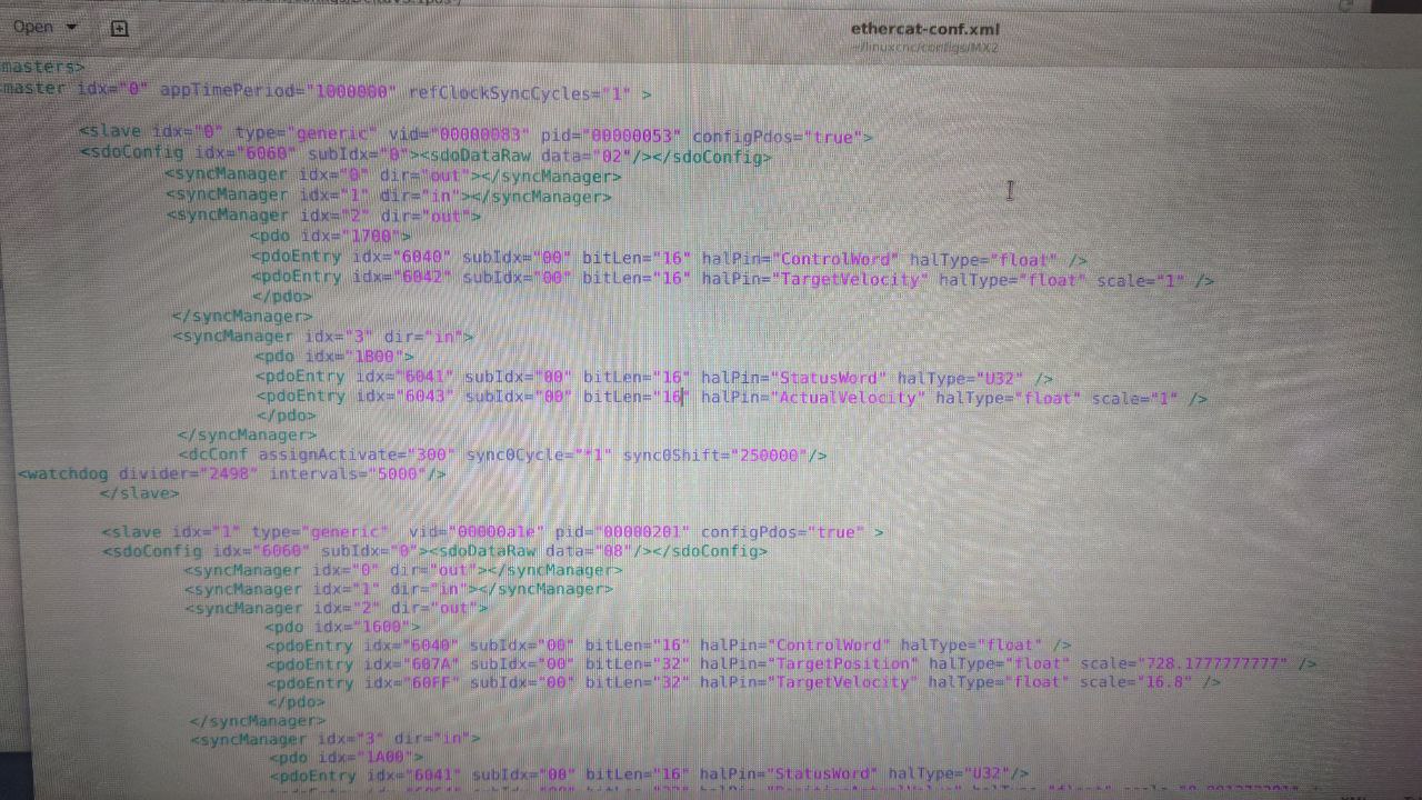

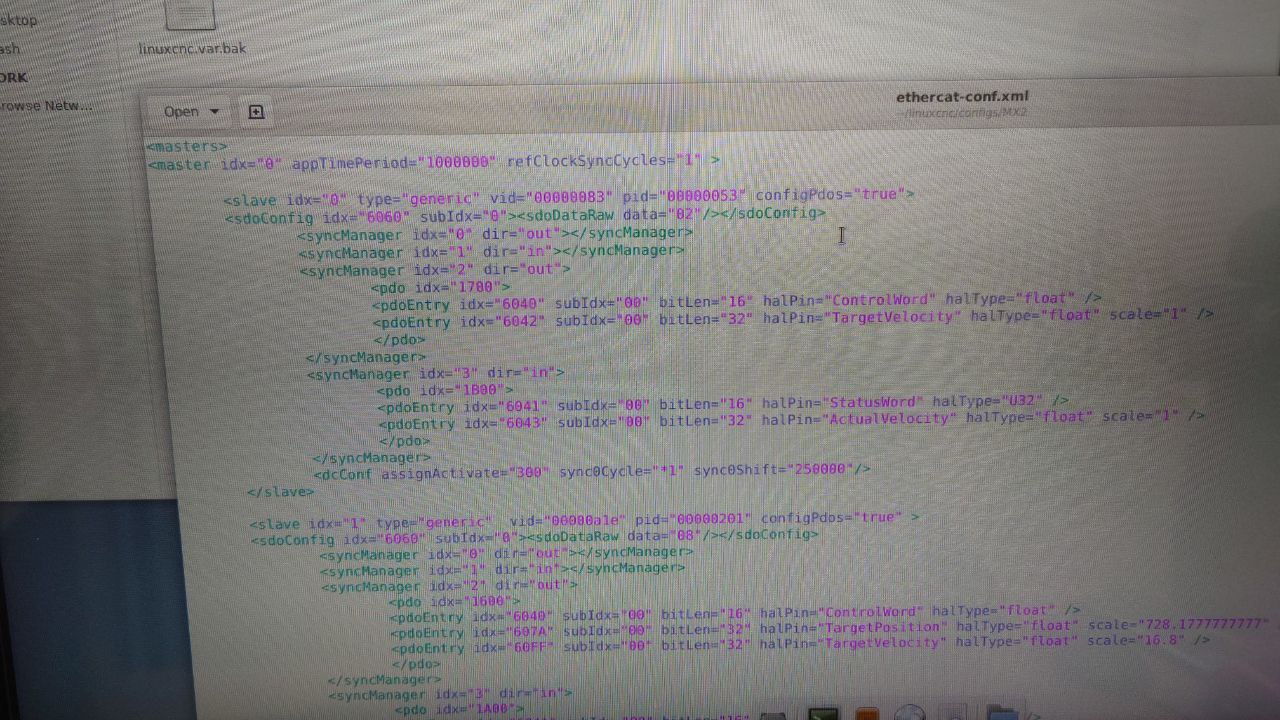

Hi everyone.
Has anyone been able to configure the Omron MX2 VFD for EtherCAT?
I was able to do it in TwinCAT 3, where everything is working fine.
However, I'm having trouble connecting the PDO variables in LinuxCNC.
The values are being sent through sdoRaw, but I've tried with and without dfcon and it still doesn't work.

target velocity / actual velocity should be Bitlen 16 (2 Bytes) you did set 32 bit.
Control word , should be S32 for haltype.
- TheRoslyak
- Posts: 238
- Thank you received: 37
12 Apr 2023 07:50 #268875
by TheRoslyak
Replied by TheRoslyak on topic Omron MX2
I already tried switching from 32-bit to 16-bit, but it didn't help. With controlword in float, everything is fine - I always do it that way and it works. There's no need to use a converter in *.hal. I'm tracking the connection via statusword.

maybe i missunderstood the problem.
please descripe your actual errors in detail.
Does the slaves reaches op state?

"Does the slaves reaches op state?"
No.
UPD
Everything worked.
With 16 bits and no Dfconf - everything works.
Last time I just tried to do it separately)
No.
UPD
Everything worked.

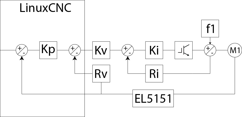

Now the question is about the control system of this drive.
I want to try and set it up so it works like any other servo. By vector control. (Target position).
I can control this drive only by velocity (there is also a frequency, but this is not my case).
The position I can read with another device (For example EL5151)
By register Actual velocity. I can get the velocity by driving but I'm not sure if it's correct and how it is calculated in terms of physics in the drive itself.
I have the ability to read the velocity and position by EL5151.
Can linuxcnc give me the velocity according to the diagram.
Now I use " joint.0.vel-cmd => lcec.0.0.TargetVelocity "
Has anyone solved this task?

is this for anxis or spindle control?
if for axis , just handle this drive as any other velocity controlled drive.
- TheRoslyak
- Posts: 238
12 Apr 2023 12:54 #268896
by TheRoslyak
Axis
The question here is whether the drive works out the desired position, whether it is necessary to receive signals from the encoder and how linuxcnc will calculate this.
- db1981
- Posts: 790
- Thank you received: 276
12 Apr 2023 14:16 #268898
by db1981
Replied by db1981 on topic Omron MX2
this is the same case as using analog 0-10V Drive with velocity control.
Lcnc Axis -> pos_cmd -> pid -> velocity_cmd -> drive
Encoder Position Feedback -> Lcnc Axis
Important is the correct PID scaling to machine units.
