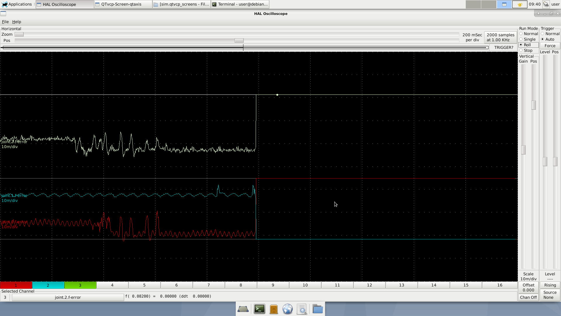

hello,
anybody knows how can be added e1000e.ko driver or 8190too.ko driver beside generic.ko driver of ethercat control network adapter?

WARNING: output may be incomplete or inaccurate, you should run this program as super-user.
Ethercat is on enp16s0 = rtl8139 and should be at enp25s0 = e1000e.
I have just probem with jerking during movement... It looks like hardware problem but I do not know on which side... If it is on slave side or master.
I have just benchtop setup for experimenting purposes and error runs through all axis in the same time...
I have checked everything from slave DC, custom component code, shielding of cables, core isolation, etc....
I am controling the servos with this component

13 Aug 2023 21:46 #277882 by CORBETT
Replied by CORBETT on topic Jerking during movement
@foxington
The only way I am aware to change from generic is if you built the IgH ethercat from source.  I am not sure how to change from "generic" other than simply trying your device in the ethercat conf file when you "sudo pico /etc/ethercat.conf".  I think what you are looking for would need to be done from a source build as I have not changed anything under the repo build that Rod Webster put up.
I really think this is a configuration problem but that does not mean it isn't a hardware problem as you believe.  I have not seen Dominik here in a bit to give any input.
When I do the IgH build, I disable the rtl8139.  Give me a few hours and I will post you a set of instructions to do the source build.  I am busy, but have a set of instructions I was going to post anyway.  That way you can try it out and see if it helps you.
Thanks,
Robert

14 Aug 2023 11:53 #277949 by endian
Replied by endian on topic Jerking during movement
hello,
I think I should found the problem of jerking... It was probably like everyone from you said DC.
There is
</pdo>
</syncManager>
<dcConf assignActivate="300" sync0Cycle="*1" sync0Shift="0"/>
</slave>
section with active window
and this I just edit to "600" and it runs more smoothly and without jerking. I do not know it should help anybody... but it should :)
