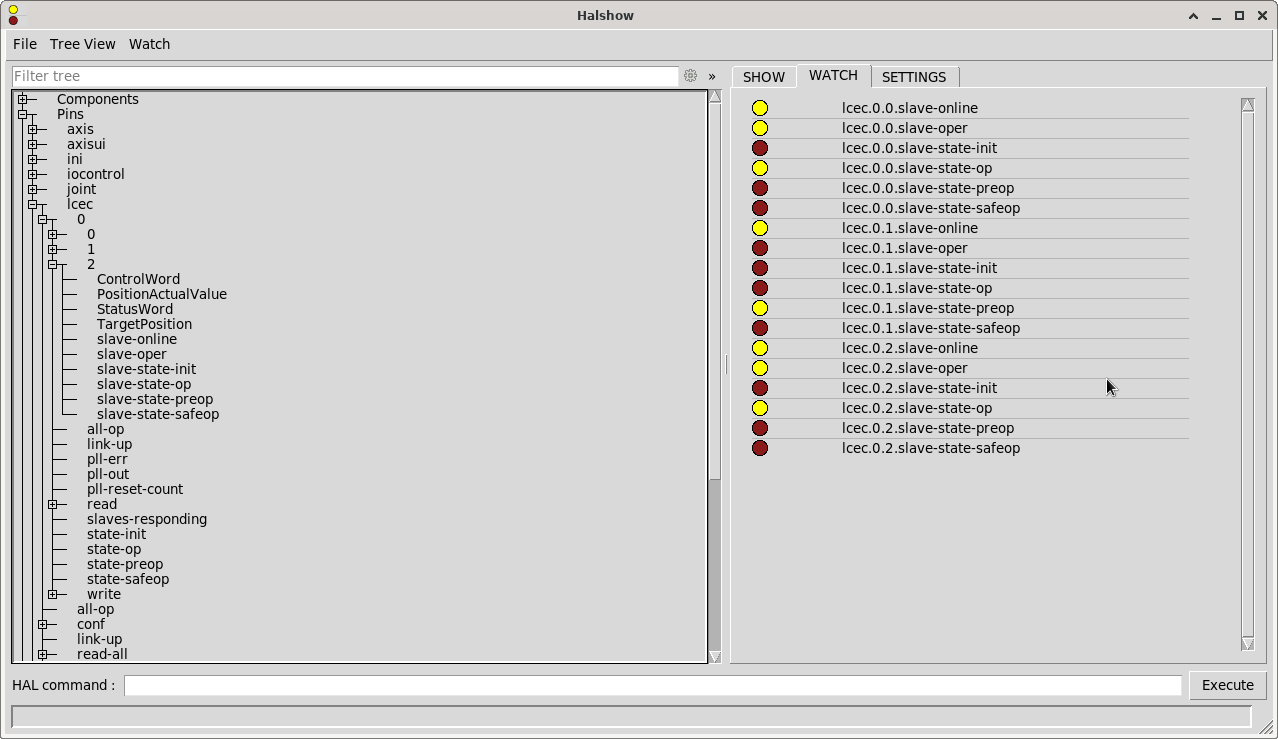

I need some advice: I want to change the controller parameters dynamically. I've added the corresponding register in the XML file.As soon as I add this parameter, my drive stops connecting. (It doesn't switch to the required mode) Does anyone know how to solve this?
<pdoEntry idx="2088" subIdx="00" bitLen="32" halPin="PB08" halType="S32" />Please Log in or Create an account to join the conversation.

I would expect a 2xxx register to require configurationĀ via SDOs so check your drive's docs.
Its outside the CIA402 range but maybe that does not apply.

What type of EC device is that?
What parameter are you trying to change?
Terminal:
sudo dmesg -wH
start you machine
Watch for error messages.
Enable more debugging:
Terminal:
ethercat debug 1
sudo dmesg -wH
start your machine.
Post debug or dmesg output
Terminal:
sudo dmesg -wH
start you machine
Terminal:
ethercat debug 1
sudo dmesg -wH
start your machine.
