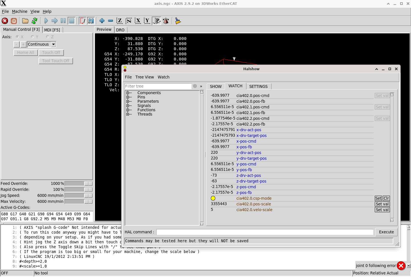

i am using cia402 component to control ASD-B3-E drives.
I get joint X following error if I jog too far on axis to either side.
I dont know where the problem is but the position value seems like it can not get past the value 2 147 475 XXX.
Could I have reached the maximum variable value?
Is it possible to scale down resolution of the cia402 component?
I tried to set E-gear in servo drive, but cia402 component seems to default it to 1.

you have reached max of int32 of encoder variable, and it is overflow,
i use scale from init in HAL file as well, and gear ration in driver is 1 to 1
so in INI
SCALE = 3355443.2 (presumably it is correct ration of encoder bit/screw pitch)

but I believe I have the same setting in HAL:
I have router with working area 800x800mm
setp cia402.0.csp-mode 1
setp cia402.0.pos-scale 3355443.2
setp cia402.0.velo-scale 5
setp cia402.1.csp-mode 1
setp cia402.1.pos-scale 3355443.2
setp cia402.1.velo-scale 5
setp cia402.2.csp-mode 1
setp cia402.2.pos-scale 3355443.2
setp cia402.2.velo-scale 5I have router with working area 800x800mm

+ you have different scale in INI 200, make them same, and for this it is better to use one value from INI file, just for ease of usageĀ

are you sure it is not used anywhere else in linuxcnc? if it is not mapped anywhere why you have it?
in my setup with 23bit encoder and 5mm pitch, i can reach up to 1200mm in one direction, before it trips in same problem of int32 overflow

Your calculation is right, but since home position for my machine is top rear right corner, and linuxcnc starts with 0 at position value. I would have only ~600mm of travel to the left.
So I would have to shut down machine with axes in the middle of the machine to cover 800mm range, which is not acceptable.
And what would be the solution for somebody with larger router and b3 servo?
But anyways.

you can use
MAX_LIMIT = 400
MIN_LIMIT = -400
HOME_OFFSET = -400
you can use
MAX_LIMIT = 400
MIN_LIMIT = -400
HOME_OFFSET = -400
