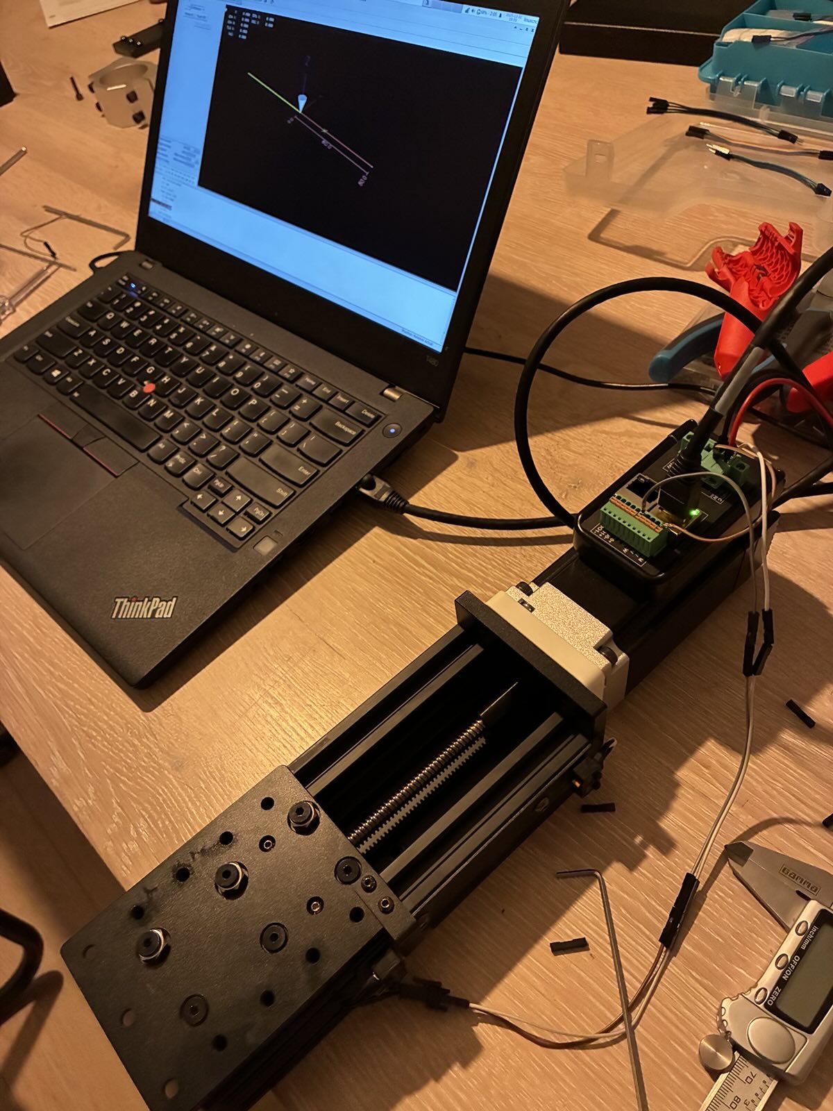

- RoKoTer
- Posts: 3
31 Dec 2025 13:08 #340791
by RoKoTer
Replied by RoKoTer on topic JMC Servo in PP mode
Hi! I've just successfully completed my initial test setup with a single JMC IHSV57. See github.com/rokoter/LinuxCNC/tree/main/ethercat/ihsv-homing. Hope it helps!
Launch LinuxCNC with cia402-ihsv-home-variant.ini
The Z startup error can safely be ignored
