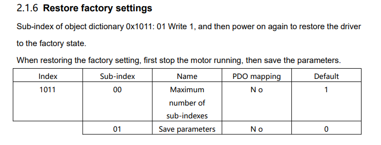

21 Mar 2025 19:31 #324446
Replied by rodw on topic Rtelligent ECT86 Closed Loop Stepper Driver Encoder Setting
- TijsVP
- Posts: 3
24 Mar 2025 09:52 - 24 Mar 2025 10:02 #324739
by TijsVP
Replied by TijsVP on topic Rtelligent ECT86 Closed Loop Stepper Driver Encoder Setting
Indeed, I just tried it and I got the same result. I think this is an out of the box problem with these drives. I have a batch of 7 drives all having the same issue, while before they never had this issue.
I also checked, all the settings/parameters are the same with the working and not working drives. After opening them up, also internally they look the same.
