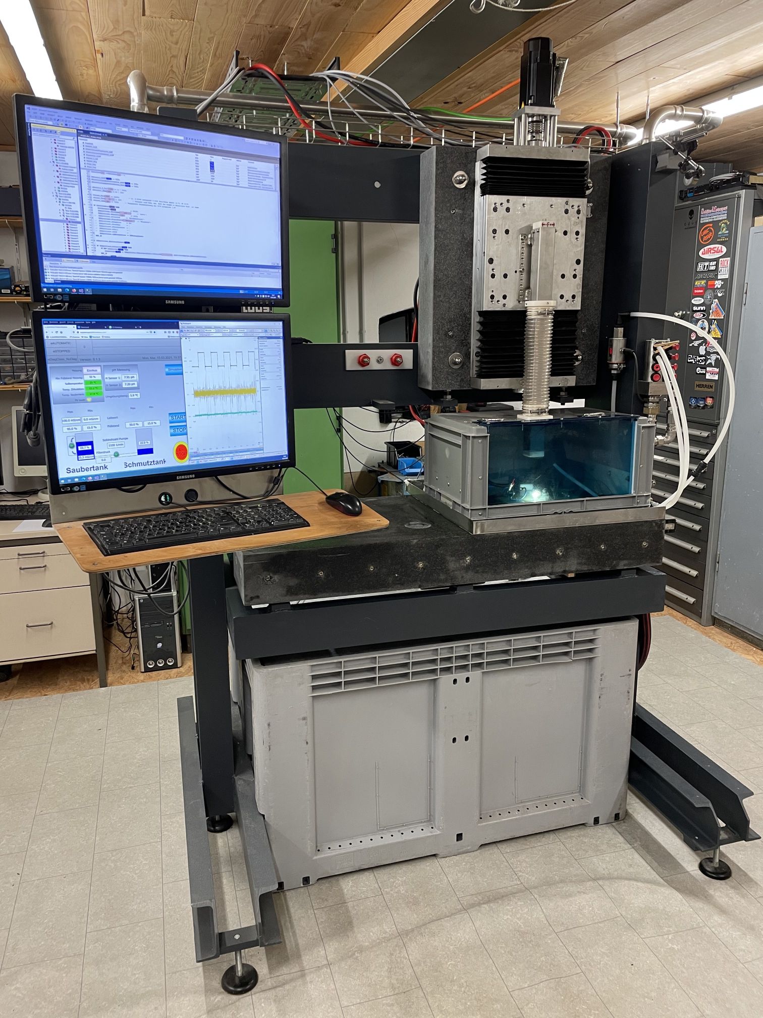

by deedee
Replied by deedee on topic LinuxCNC and Beckhoff AX5000 servo drives
i've got the AX5106 and A5203 up and running. db1981 helped al lot regarding the homing and pos_mode issues.
The project itself is still work in progress, but the main features are working. See attached files. These are the relevant snippets from *.hal:
#*******************# NOT AUS#*******************net estop-loopout iocontrol.0.emc-enable-in <= estop-latch.0.ok-outnet estop-loopin iocontrol.0.user-enable-out => estop-latch.0.ok-innet estop-reset iocontrol.0.user-request-enable => estop-latch.0.resetnet remote-estp estop-latch.0.fault-in <= lcec.0.1_EL1018.din-2-not#*******************# AXIS Z#*******************# Skalierung 10mm Weg entspricht 1 Motorumdrehung; Minus da Z-!setp lcec.0.16_AX5106.srv-scale -0.1net Zaxis_enable joint.2.amp-enable-out => lcec.0.16_AX5106.srv-enablenet Zaxis_fb lcec.0.16_AX5106.enc-pos-abs => joint.2.motor-pos-fbnet Zaxis_cmd joint.2.motor-pos-cmd => lcec.0.16_AX5106.srv-pos-cmdnet Zaxis_torque <= lcec.0.16_AX5106.srv-torque-fb-pctnet Zaxis_home_sw lcec.0.16_AX5106.srv-dig-in-2-not => joint.2.home-sw-innet Zaxis_index_enable lcec.0.16_AX5106.enc-index-ena => joint.2.index-enable

18 Jun 2025 18:03 #330462
by endian
Replied by endian on topic LinuxCNC and Beckhoff AX5000 servo drives
hello,
I see the TC3 on your screen .. I did TC3 master to lcnc master configurator but it is not tested with the SoE drives ... maybe it will help you
let me know if it helped
regards
regards
