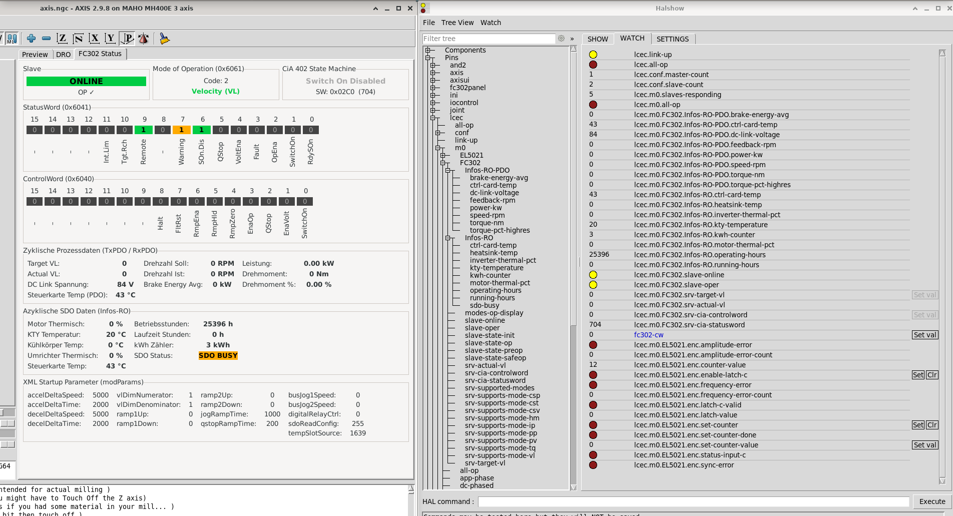

31 May 2026 12:51 - 31 May 2026 13:04 #346810
by PedPEx
Replied by PedPEx on topic LCEC creating Danfoss VFD config
Hello guys :DAfter a lot of troubleshooting - and even trying out another motor driver (Festo CMMT-AS), which I found out wayyyyy too late was not suited for the planned use case - I ended up settling back on the Danfoss VFD. I finally got it working after over a year of trying! In case anybody wants to use a Danfoss VFD like this in their CNC mill or a similar setup, they are really cheap on eBay right now. This one is even equipped with the required EtherCAT communication module (MCA124 - quite hard to find). eBay link:
www.ebay.de/itm/327118691814The files can also be found in my fork of the linuxcnc-ethercat project. I'm not sure whether I will make a pull request for these implementations, due to vibe-coding reasons. GitHub repo: github.com/PedPEx/linuxcnc-ethercatA detailed 'manual' is attached in the form of a Markdown file. You will just have to manually remove the .txt file extension.In case you need further details or anything similar, just let me know :)
Last edit: 31 May 2026 13:04 by PedPEx. Reason: Added picture of Glade FC302 diagnosis panel
