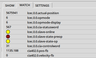

04 Nov 2024 03:37 #313741
by jadid
Replied by jadid on topic Homing lichuan
Using Marco custom-homing, got this following hal-show, but motor didn't move.
You can see that opmode already change from 8 to 6.
