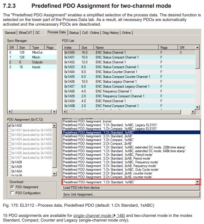

I've been struggling with getting an EL5112 encoder to work. I've spent most of the day battling this and i think i need some input/assistance.
The module is this one: www.beckhoff.com/da-dk/products/i-o/ethe...surement/el5112.html
The manual is here: download.beckhoff.com/download/Document/...rminals/el5112en.pdf
The module is an encoder ane it can run as either "1xABC" or "2xAB" encoder(s). I need it to run as "1xAB" encoder, not using the 2nd channel. However, its factory default set to "1xABC". If i look in the manual i find this regarding the "Predefined PDO assignment":
...and what i can gather from the manual is that i need to use 0x1A02 for input and 0x1602 for output. I've tried that with this configuration:...and if i run a command to see the pdos i also get what i expect with regards to "0x1600/0x1a00" vs. "0x1602/0x1a02"(1xABC vs 2xAB):
...so far so good....but it ain't working:(note the "PREOP" at pos 1)
If i look at dmesg this is what i get:
..."Invalid input configuration"...
So my question is: Does this "PDO assignment" in TwinCAT do anything else behind the scene that i need to do in my setup aswell? I don't use/have TwinCAT anywhere and i actually don't have a PC that can run it in my workshop, otherwise i would have testet it. But i was hoping others have had similar issues, maybe with other devices that support multiple "modes"...
Have i missed anything obvious?

<slave idx="1" type="generic" vid="00000002" pid="13F83052" configPdos="true" name="ENC1">

[ 5922.350569] EtherCAT ERROR 0-1: Failed to set SAFEOP state, slave refused state change (PREOP + ERROR).
[ 5922.351567] EtherCAT ERROR 0-1: AL status message 0x001E: "Invalid input configuration".
[ 5922.353905] EtherCAT 0-1: Acknowledged state PREOP.
[ 5922.821510] EtherCAT 0: Slave states on main device: PREOP, OP.
[ 5923.009501] EtherCAT WARNING 0: 8 datagrams UNMATCHED!..."Invalid input configuration"...
/Thomas

...or maybe there is a way of configuring devices that i don't know of? The manual does not seem to mention ANY configuration apart from this PDO assignment...

However! I restart the module(power off/on) then the new config worked! I'm not quite sure why though, which annoys me quite a lot! I even managed to change the pdos to use 2xAB(with 0x1602/0x1A02) and it still works...and i'm getting proper data from my encoder... I ran a diff between the two configs and apart from the type-error and naming they are identical...
My current/best theory is that one of the configurations i've made yesterday somehow made the module go into an "error mode" of sorts and only a physical powercycle could get it out again. So i might have had it correct in one of my attempts, but since i never powercycled the modules i somehow kept getting "old errors" or something along those lines...jezz... anyways, it is working, so thanks!
/Thomas
