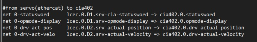

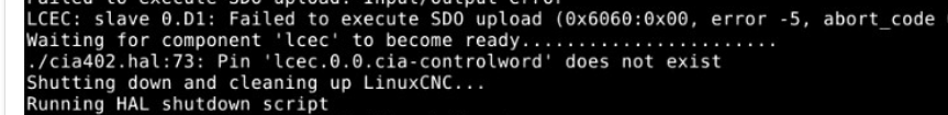

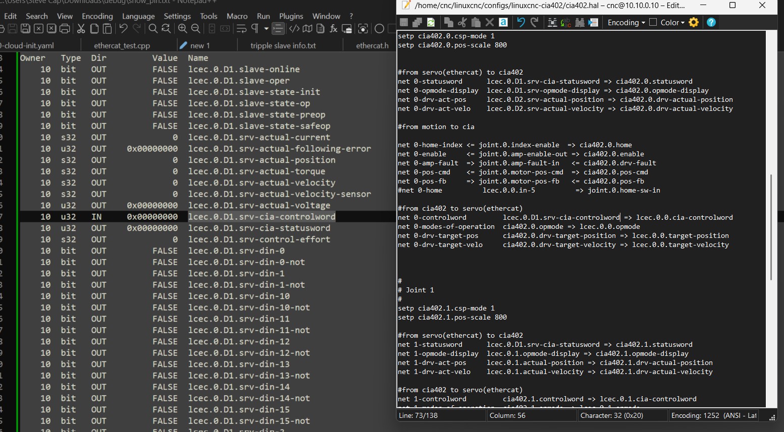

I have attached the output of those commands. I am having a hard time understanding what information to take from the `show pin` output and where (cia402.hal?) to put it exactly. for that line regarding statusword it shows:
" 10 u32 OUT 0x00000000 lcec.0.D1.srv-cia-statusword"
and I could not find any reference to 0x6041 anywhere.
Also, after running `halcmd loadrt lcec` , the ethercat network activity stops, where usually it's blinking. not sure if that is expected or not.

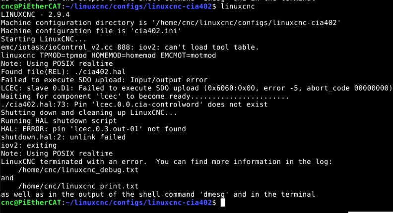

There it is, that's the name lcec.0.D1.srv-cia-statusword instead of lcec.0.0.cia-statusword you have in the hal file.
Replace in cia402.hal file and you should come one step further, to the next variable.
The index 0x6041, you don't seem to need that now when the naming pattern is so obvious from the listing.

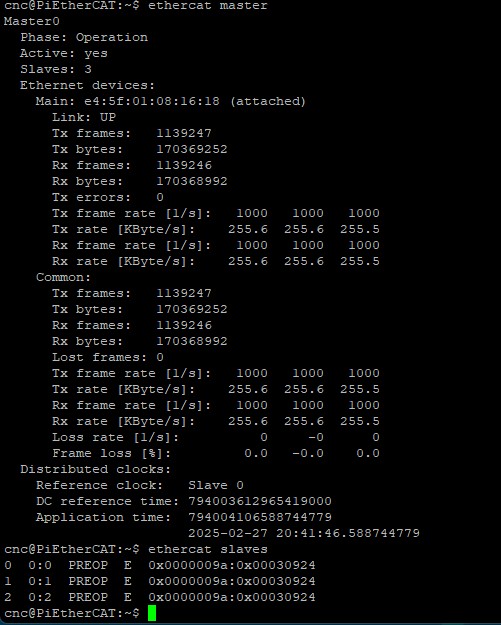

I guess EtherCAT went out of OP mode, to INIT or PREOP. No harm done. You have started linuxcnc in a very rudimentary state. If you like to, you can stop it with "halrun -U". Optional. EtherCAT continues to work and linuxcnc will make it enter the state it needs to be in.

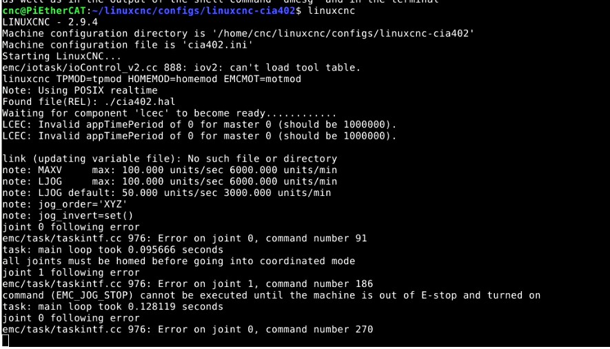

Have to act on appTimePeriod message.
Check line two in this file github.com/dbraun1981/hal-cia402/blob/ma...le/ethercat-conf.xml and well you can copy that line to your file.
You can add line 4 as well if it isn't there already. Pay attention to placements, line 2 in the master line. Line 4 under slave, for the three drives.

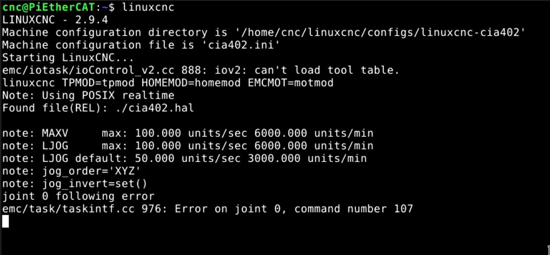

Sorry for the long delay, have been battling a nasty bug of the human variety. I have added line 2 and line 4 to my xml and it has resolved the appTimePeriod errors. I also simplified the .xml and .hal file to only deal with one ethercat node for the time being until i manage to get my head around all this, lol. Once linuxcnc loaded with no errors I clicked the power button and tried to home all axis. This resulted in `joint0 following error`.
