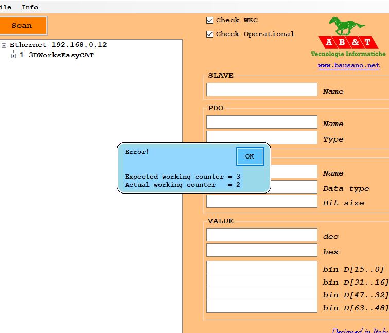

- laurentl38
- Posts: 35
04 Jul 2025 20:25 - 04 Jul 2025 20:25 #331266
by laurentl38
Replied by laurentl38 on topic IO Questions around mixing IO between Ethercat and Pi 5?
Hello zmrdko,
I just found your great work with the easycat card.
I'm starting to play with it, and it works great for digital input and output. With 1 encoder, no problem.
However, with 2 or more encoders, it doesn't work... As soon as I change the "QUADENCS" value to greater than 1, I can no longer connect to the easycat card. I get an error with the "easynavigator" software.
Have you ever had this problem?
Do you have any leads?
regards
Laurent
regards
Laurent
Last edit: 04 Jul 2025 20:25 by laurentl38.
- zmrdko
- Posts: 186
- Thank you received: 49
07 Jul 2025 14:28 #331449
by zmrdko
Replied by zmrdko on topic IO Questions around mixing IO between Ethercat and Pi 5?
have you edited the Arduino sketch as well?
there is only one encoder defined:
github.com/zmrdko/3DWorks_EasyCAT/blob/m...orks_EasyCAT.ino#L93
lines 98 and 120/121
- laurentl38
- Posts: 35
07 Jul 2025 16:07 - 07 Jul 2025 16:11 #331456
by laurentl38
in first time, yes i modified line 98 and add line 121
in second time, i mak a little modification at line 454 :
but the same error still occurs.
Last edit: 07 Jul 2025 16:11 by laurentl38.
- laurentl38
- Posts: 35
07 Jul 2025 17:20 #331465
by laurentl38
it's very strang
I think I found the problem:
If I replace "QuadEncMp[0];" with "4" line 430, 435, ..
it's working.
replace for each encoder
#if QUADENCS >= 1
EncCount[0] = Encoder0.read()/QuadEncMp[0];
by
#if QUADENCS >= 1
EncCount[0] = Encoder0.read()/4;
it's working.
#if QUADENCS >= 1
by
#if QUADENCS >= 1
