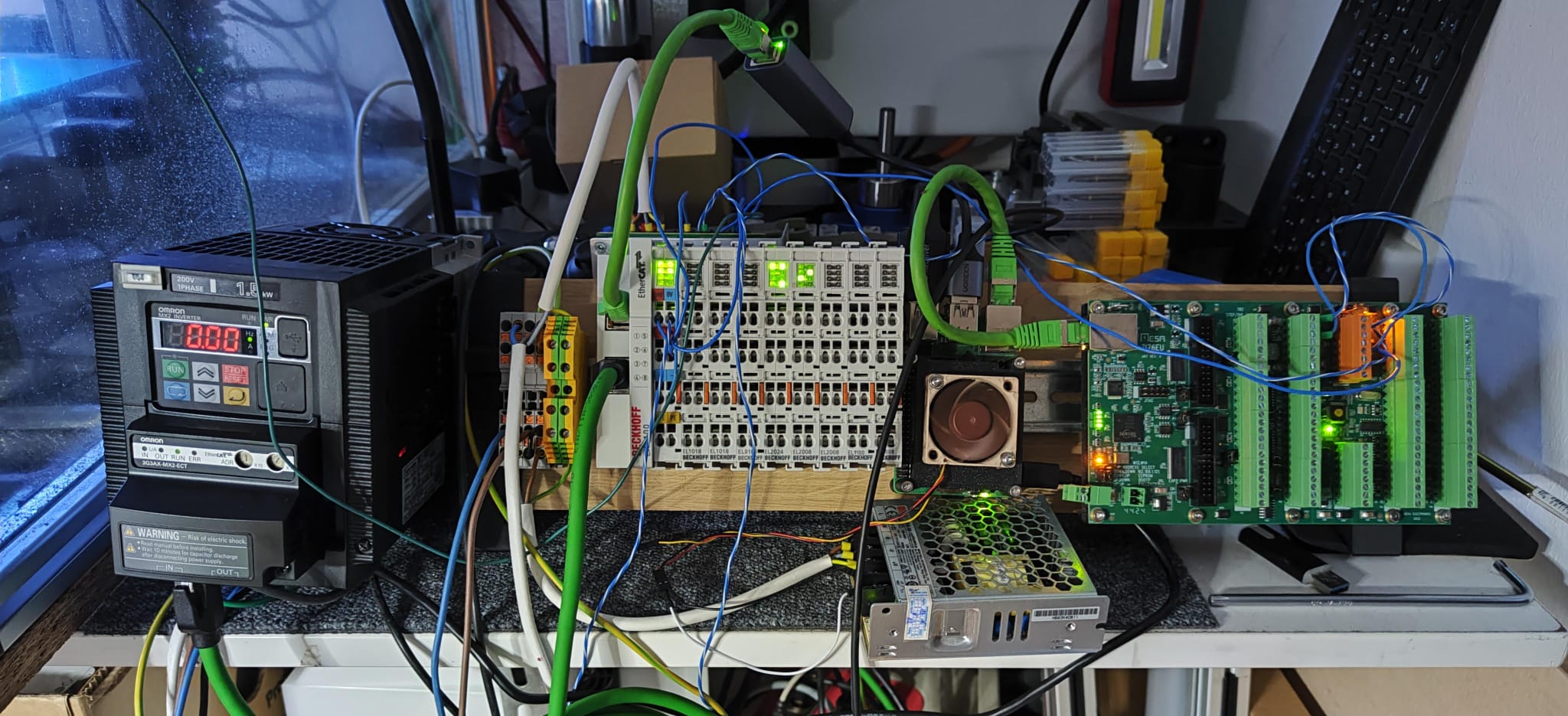

what do i have?
i´m running a RPi 5 with LinuxCNC (latest Preempt Version)
a Mesa 7i76EU (everything working)
a Pendant WHB04-6 (everything working)
and some Beckhoff EtherCat modules (everything working)

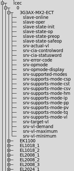

and last i got my self an EtherCat Module for the Omron MX2 (partial working)
I can´t figure out how to drive the Omron MX2, there is some mismatch in the type of the controlword
my ethercat xml has only the Modulelist, no special entries like syncmaster and so on...
the Device shows up in the HalShow under lcec, all "Pins" are viseble, ethercat slaves shows the device... so i think its just a small config problem in the xml

hey i got it working... wasnt that hard as i thought...
here my solution...
the ethercat.xml file first... thats the easy part...
with this you get all the pins into halshow
then you need to load the main ethercat stuff before the main ui... (ethercat.hal)
then go to your machine halfile and add the nets and pins
this works for me
thanks again for all the done work in the past to make this so easy nowadays!
cheers miniwini
here my solution...
Code:
<masters>
<master idx="0" appTimePeriod="1000000" refClockSyncCycles="1">
<slave idx="0" name="EK1100" type="EK1100"/>
<slave idx="1" name="EL1018_1" type="EL1018"/>
<slave idx="2" name="EL1018_2" type="EL1018"/>
<slave idx="3" name="EL2024_1" type="EL2024"/>
<slave idx="4" name="EL2008_1" type="EL2008"/>
<slave idx="5" name="EL2008_2" type="EL2008"/>
<slave idx="6" name="EL2008_3" type="EL2008"/>
<slave idx="7" name="3G3AX-MX2-ECT" type="OMMX2"/>
</master>
</masters>
