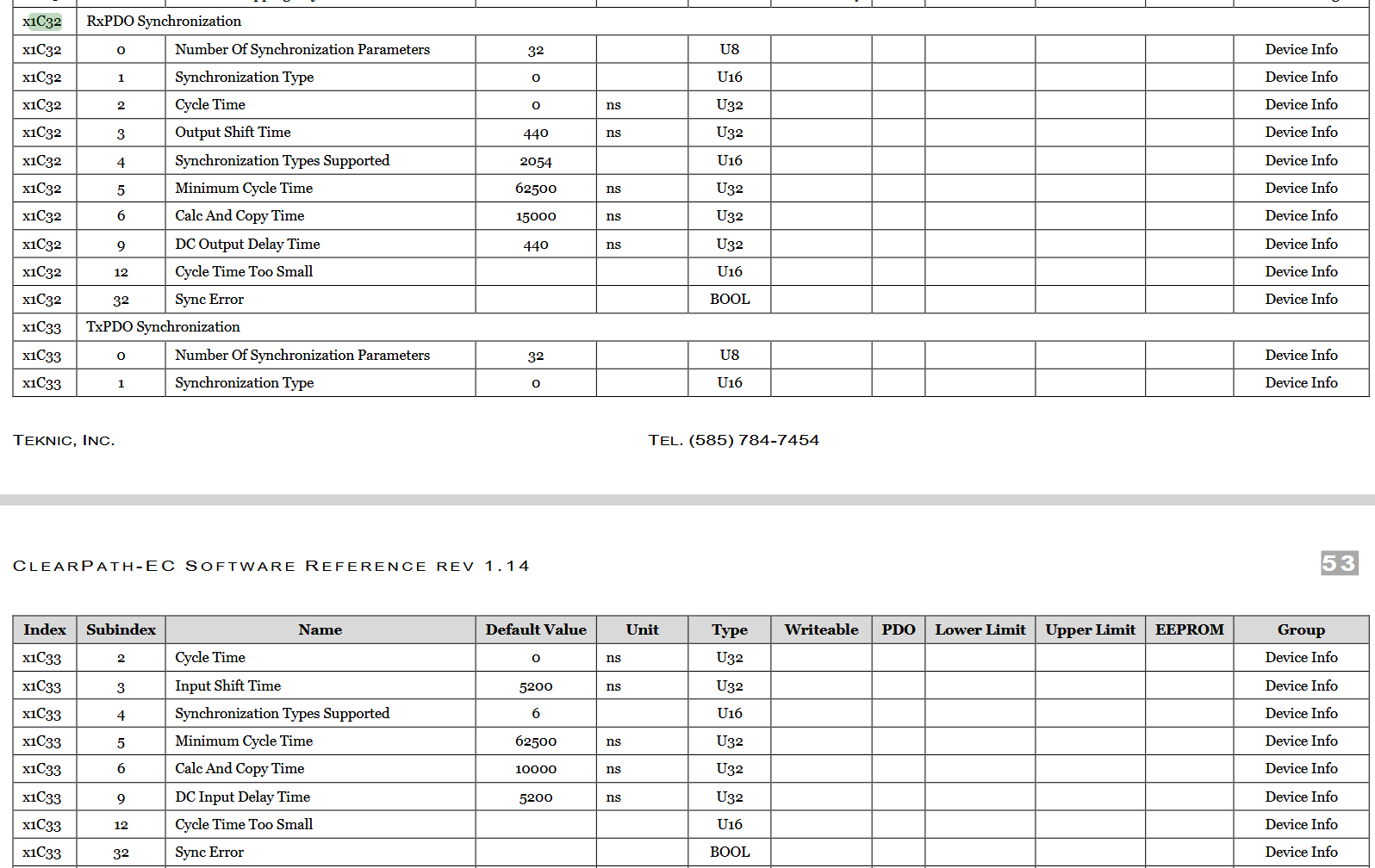

I've been working on an EtherCAT build for a couple of months now, and wanted to avoid posting here, but it seems I have hit a wall.
For some background: I am completely new to LinuxCNC but wanted to build an EtherCAT AXYZ cnc with Cia402 drives. I got an EK1100, EL1008, and EL2008, and my brother gave me a ClearPath-EC Teknic Cia402 (CoE) drive. I had a raspberry pi 5 available, so I am testing my configuration on that right now. I used the Pre-packaged rasp-pi install (Debian 12) with LinuxCNC from the linuxcnc website, and had very little trouble following Rod's installation from repositories. From there I had a lot of trouble, but got a configuration based off of the sim.axis config working with the EtherCAT slaves, and was able to test I/O with no trouble.
Now, as I am attempting to incorporate the drive, but I can't get it into the OP state. The EtherCAT master recognizes it, and I can define pdos, but sdo 0x2000 and 0x2011 seem to just not exist, which I currently think has to do with the problem. I'm still having trouble wrapping my head around this, so let me know if there's anything else you need to help me. I would really appreciate the help!
teknic.com/files/downloads/ClearPath-EC_User_Manual.pdf

Ok, to understand a bit better, post the error you get.
If it is just that the device doesn't go to OP, please post the, say, 40 last lines of the output of "sudo dmesg".
Please also post you ethercat-conf.xml and the output of the "ethercat sdos" command.
I want to see the error from EtherCAT master which come in the syslog.
And match your config with the actual sdos the drive have.

dmesg:
ethercat sdos:
The vid, pid and SM2 idx and SM3 idx are all correct.
I hope everything is readable. Let me know if there are tools I should use to make things easier to read.

[ 328.066961] EtherCAT ERROR 0-3: Failed to set SAFEOP state, slave refused state change (PREOP + ERROR).
[ 328.068961] EtherCAT ERROR 0-3: AL status message 0x001E: "Invalid input configuration".
[ 328.070960] EtherCAT 0-3: Acknowledged state PREOP.
[ 328.076386] EtherCAT 0: Slave states on main device: PREOP, OP.

Do you know what
"(PREOP + ERROR) could be caused by? or "Invalid input configuration"?
Also, did you take a look at the .hal and .ini file? There are a few things in the .hal file that I don't know the purpose of, yet LinuxCNC doesn't run without them, so I'd appreciate an explanation of why they're necessary-if you're willing.
Do you know what
[69236.509163] EtherCAT 0: Slave states on main device: PREOP, OP.
[69240.307732] EtherCAT ERROR 0-3: Failed to set SAFEOP state, slave refused state change (PREOP + ERROR).
[69240.309731] EtherCAT ERROR 0-3: AL status message 0x001E: "Invalid input configuration".
[69240.311730] EtherCAT 0-3: Acknowledged state PREOP."(PREOP + ERROR) could be caused by? or "Invalid input configuration"?
This could be correct as these are from a manufacturer specific range so not CIA402 registers. . You need to review the manual for your drive

Okay, so would the equivalent allow it to become operational?
Do you have a little more guidance as to what I'm looking for, because I still don't really understand what I'm looking at or for. I have a list of seemingly all of this drives pdos/sdos and their descriptions.
The manual says the drives conform to CiA402, but I don't know what all that standard includes-I assume based on your comment that the registers are separate from the standard?
Thanks Rod
Thanks Rod

Replied by rodw on topic Trouble with Cia402 drive configuration
Clearpath should have good docs. Typically the CIA402 registers are > 6000.
Its not a one size fits all.

It's not obvious what's wrong. Forget the 0x20xx SDOs, you are not using them, they are not mentioned in ethercat-conf.xml.
Let's look at the error message in syslogIf you look at the subindices that are listed, they agree with the documentation
(From teknic.com/files/downloads/ClearPath-EC_Software_Reference.pdf)
Some subindices ARE missing and I don't know why the EtherCAT master makes a big deal of that. If it needs that info or what?
I think the Invalid input configuration is a consequence of those errors but could be something else also.
Almost out of ideas, but there are two things you can try. Set configPDOS="false" or remove the option altogether.
If that doesn't help, increase debug level on the ethercat master to hopefully get some ideas on what's going wrong.for example, try to start linuxcnc and list the messages in syslog again.
Can you also show the content of sdo 0x60c2:1 and 0x60c2:2 (interpolation time) Use commandCompare with table in manual.
[ 331.671725] EtherCAT WARNING 0-3: SDO information error response while fetching SDO entry 0x1C32:07!
[ 331.671732] EtherCAT ERROR 0-3: SDO abort message 0x06090011: "Subindex does not exist".(From teknic.com/files/downloads/ClearPath-EC_Software_Reference.pdf)
ethercat debug 1Can you also show the content of sdo 0x60c2:1 and 0x60c2:2 (interpolation time) Use command
ethercat upload 0x60c2 1Attachments:
