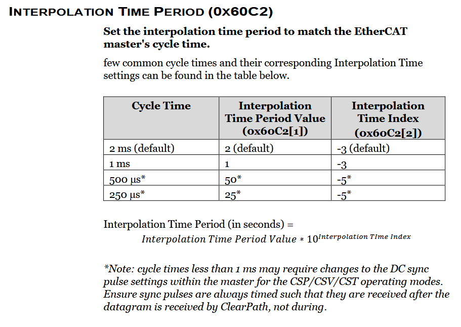

I set configPDOS="false" and set debug level to 1 then started linuxcnc and did dmesg:
[ 5955.390588] EtherCAT DEBUG 0-3: Sync after 2916 ms: 10723 ns
[ 5955.391589] EtherCAT DEBUG 0-3: 9904 ns difference after 2920 ms.
[ 5955.391591] EtherCAT DEBUG 0-3: ref_time=812044903503955000
[ 5955.391592] EtherCAT DEBUG 0-3: app_time=812044909343879717
[ 5955.391593] EtherCAT DEBUG 0-3: start_time=812044909442878936
[ 5955.391594] EtherCAT DEBUG 0-3: cycle=1000000
[ 5955.391595] EtherCAT DEBUG 0-3: shift_time=0
[ 5955.391596] EtherCAT DEBUG 0-3: remainder=923936
[ 5955.391597] EtherCAT DEBUG 0-3: start=812044909442955000
[ 5955.391598] EtherCAT DEBUG 0-3: Setting DC cyclic operation start time to 812044909442955000.
[ 5955.393588] EtherCAT DEBUG 0-3: Setting DC AssignActivate to 0x0300.
[ 5955.396589] EtherCAT ERROR 0-3: Failed to set SAFEOP state, slave refused state change (PREOP + ERROR).
[ 5955.397588] EtherCAT ERROR 0-3: AL status message 0x001E: "Invalid input configuration".
[ 5955.399588] EtherCAT 0-3: Acknowledged state PREOP.
ethercat upload 0x60c2 1
0x02 2
ethercat upload 0x60c2 2
0xfffffffd -3
Don't know what this means; could you explain what interpolation time is?

It's from the ethercat manual, I put a link there a post ago.
This is unique for this servo
You have a 1 ms cycle time in axis.ini. According to the manual you have it set to 2 ms. Change that withand check the value again with ethercat upload.
The error comes from the drive, it thinks the config is wrong.
The only thing to do is to follow the manual.
One thing I can think of is that it doesn't like variable PDOS.
But there aren't any complains about that.
You can as a next step test to define the receive and transmit PDOS
as on page 9 and 10. Include all pdo entries even the ones you don't use.
ethercat download 0x60c2 1 1The error comes from the drive, it thinks the config is wrong.

After reading Note under the table, you can set "sync0Shift=700000" in ethercat.xml
