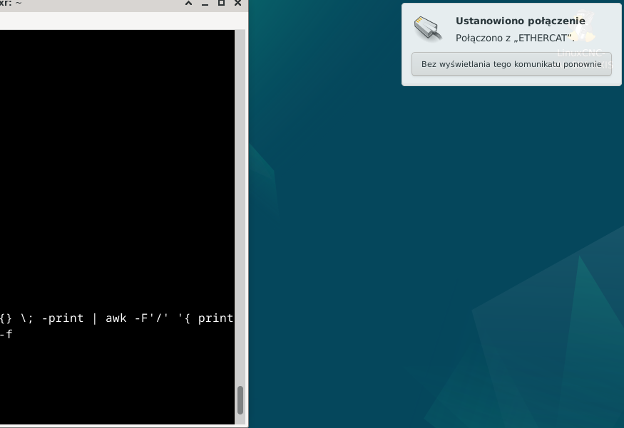

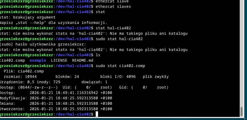

Hallo guys , at the begining I woud like to thanks for that great forum.I'm trying to connect ethercat device like ORIENTAL MOTOR AZD4A-KED but with no lack.At first i run ethercat on ek1100 and some io -> evrything is working fine ,therefor I know that System is working properly also lan card .Second step connection Oriental drive , but there is no connection , when I type in terminal Ethercat slaves there is nothing.I know that unit is able to work properly because I tested it under Twincat3.Some info about thesystem:drive : oriental motor azd4a-ked compatibility cia402.system : Linux grzesiekzxr 6.1.0-30-rt-amd64. Thank you in advance for your help.

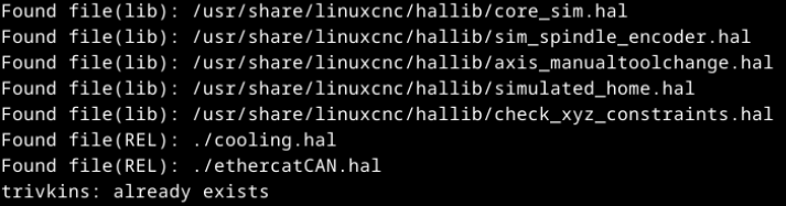

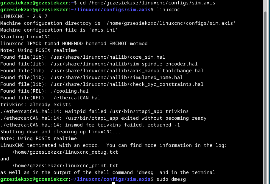

Hallo Hakan, thanks for Your response .I do like You sad but after removing sim files there is another problem like in the picture
Only for another try i create separate second config, files like .hal , .xml are exactly the same as before., but there is simlar problem like in the picture
My goal for that moment is only confirm that drive is talking to LCNC.Thanks again.

You see the problem? lcec.0.0.cia-statusword
Numbering is lcec.<master id>.<slave id>.variable-name
Your slave id is number 1, at least that's what it says in ethercat-conf.xml
Must match numbering from "ethercat slaves"

Wow, You are amazing Thank You .Drive is communicating with LCNC.
Next step is to create proper config.I will do an update in a few days.

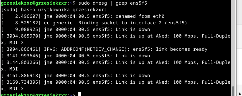

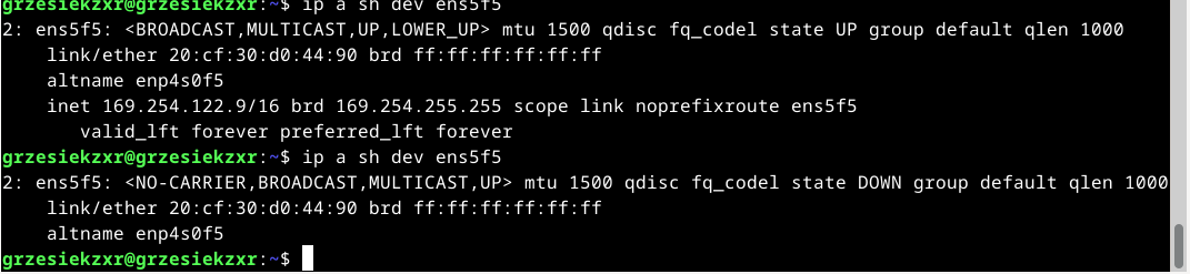

Hallo, a litle explanation and update. Altough LCNC is starting but ethercat connection is not activated.Normaly when I work with Beckhoff EK1100 i see small icon ethercat up on the screen and also i can write terminal command Ethercat Slaves it showing me active participiants.
Also when I try ...ip link set dev ... down / up it doesnt work to.It looks like driver dont try to start at all when I try to connect oriental motor.
What can I do more ,how to test why eth driver dont start/trying to run.
Thanks.
Thanks.

Sounds like you forgot to enable ethercat service and it didn't start at boot.
Some 30 lines down in this post
forum.linuxcnc.org/ethercat/45336-etherc...step-by-step?start=0
tells you how to check status of the ethercat service and, if needed, enable it for automatic start at boot.
