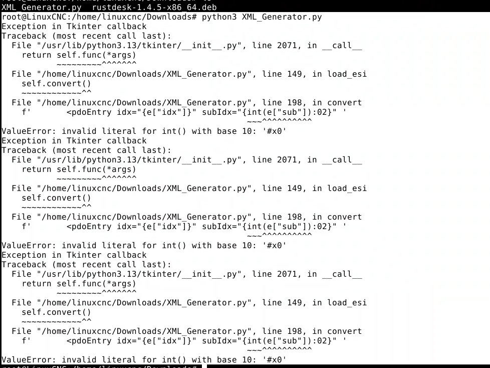

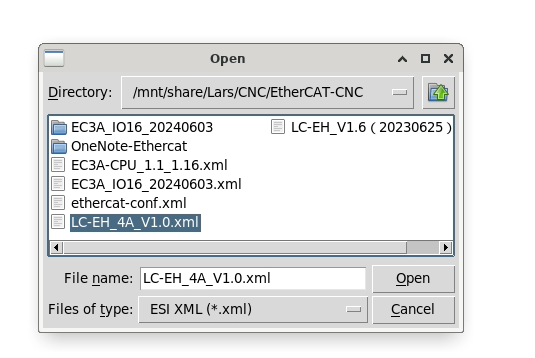

01 Mar 2026 09:49 #343683 by Eisbaeeer
Hi Szolkaa
I own two Lichuan closed loop ethercat controllers. One with 4 motors, one with 1 motor.
Technical specs:
- Lichuan CL57E-4A (4 x closed loop)
- Lichuan OLCE-57H (1 x closed loop)
I tried your genius configuration tool. By importing the xml I get an error.
Did you see any chance to get the both controllers running with linuxcnc?
Greetings Lars
root@LinuxCNC:/home/linuxcnc/Downloads# python3 XML_Generator.py
Exception in Tkinter callback
  File "/usr/lib/python3.13/tkinter/__init__.py", line 2071, in __call__
    return self.func(*args)
  File "/home/linuxcnc/Downloads/XML_Generator.py", line 149, in load_esi
    self.convert()
  File "/home/linuxcnc/Downloads/XML_Generator.py", line 198, in convert
    f'       <pdoEntry idx="{e["idx"]}" subIdx="{int(e["sub"]):02}" '
ValueError: invalid literal for int() with base 10: '#x0'
    self.convert()
    self.convert()
