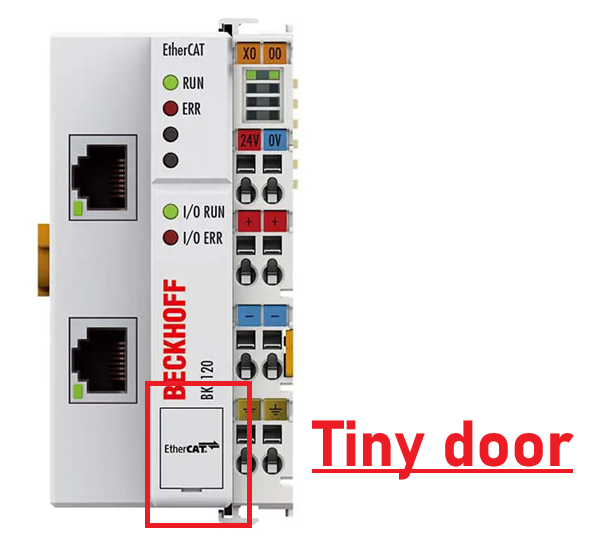

08 Apr 2026 11:59 - 08 Apr 2026 12:09 #345312
by endian
For every problem exist solution ... you have K-bus, something like profi-bus
you need USB to TTL serial communication then open small doors which are for this connection, then you will need buy or made custom cabling for 4x2,54mm pins ...
you need to have KS2000 paid software which will allow to configure your EEPROM of KL1120 for existing/present members of Kbus because they are not self-identifing itselfs ... You will create configuration of whole Kbus members behind KL1120 in KS2000 and every bus member has some lenght of data .. everything in WORDs
then done mapping for ethercat PDOs and each SMs and then you can list your config over terminal build configuration tool ... then create .xml file
finally you should run some KL stuff with non DC mode without synchronization
