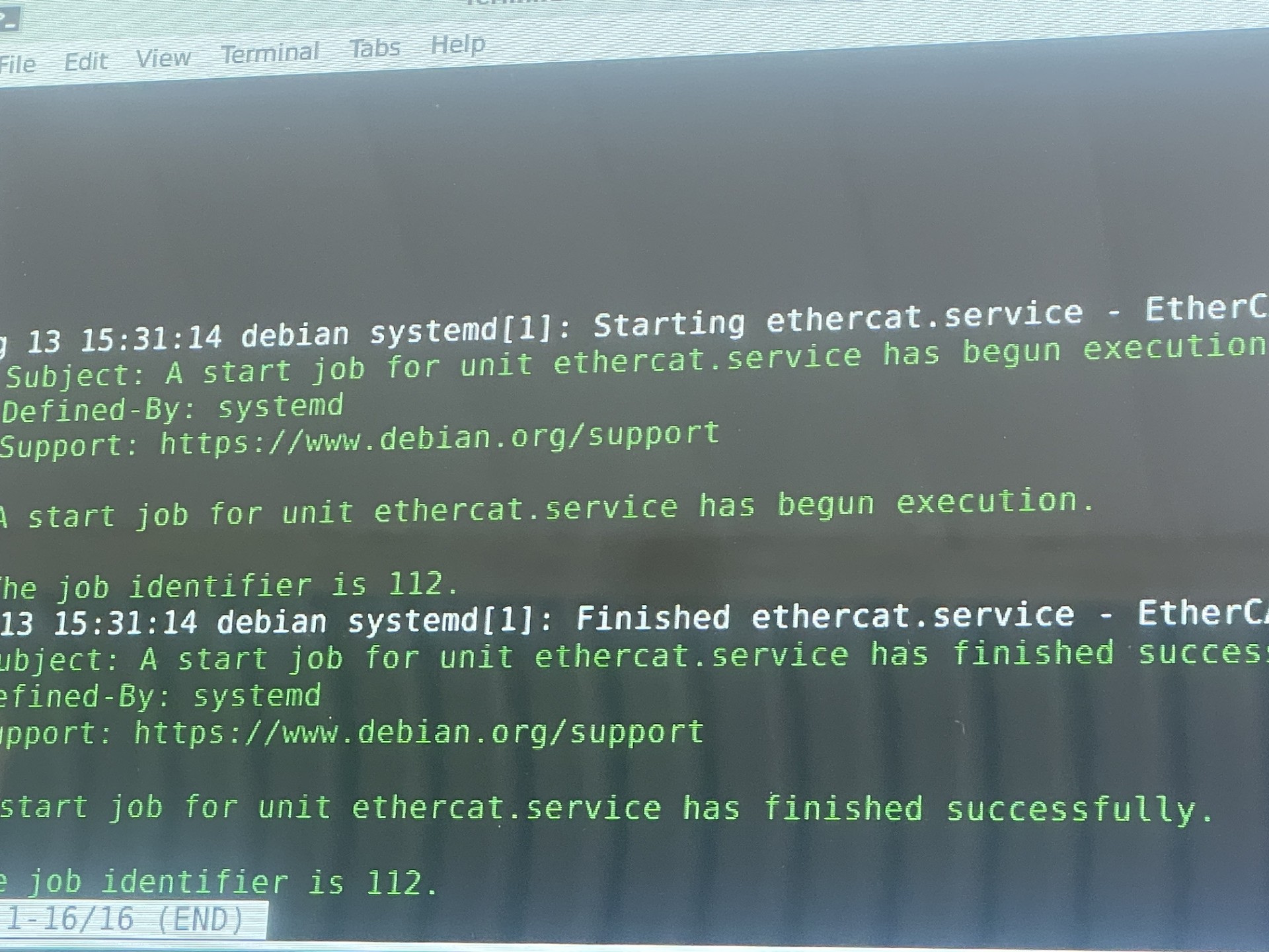

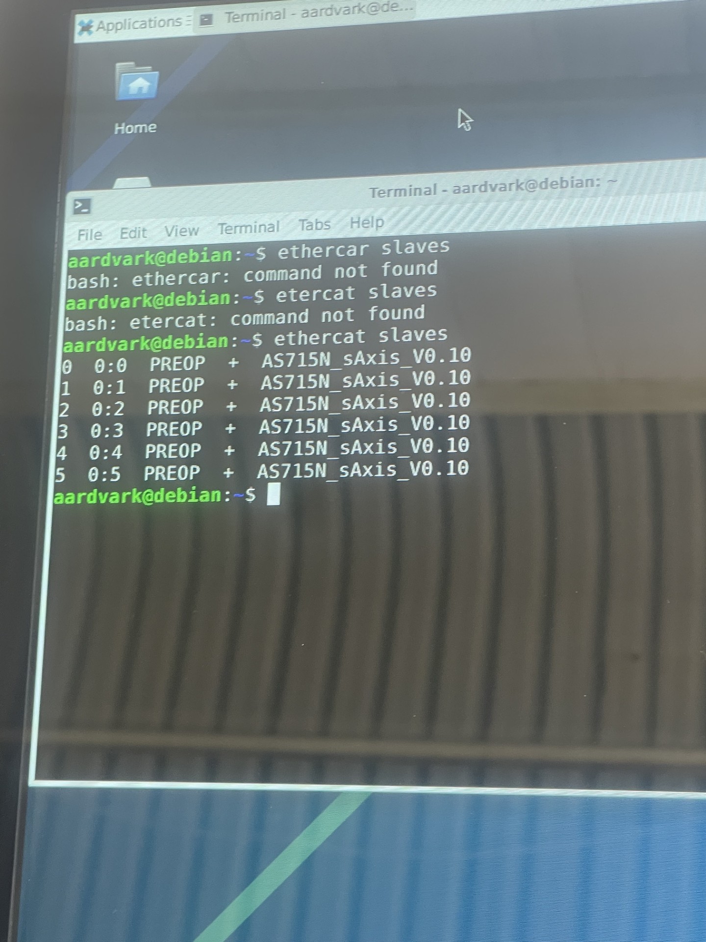

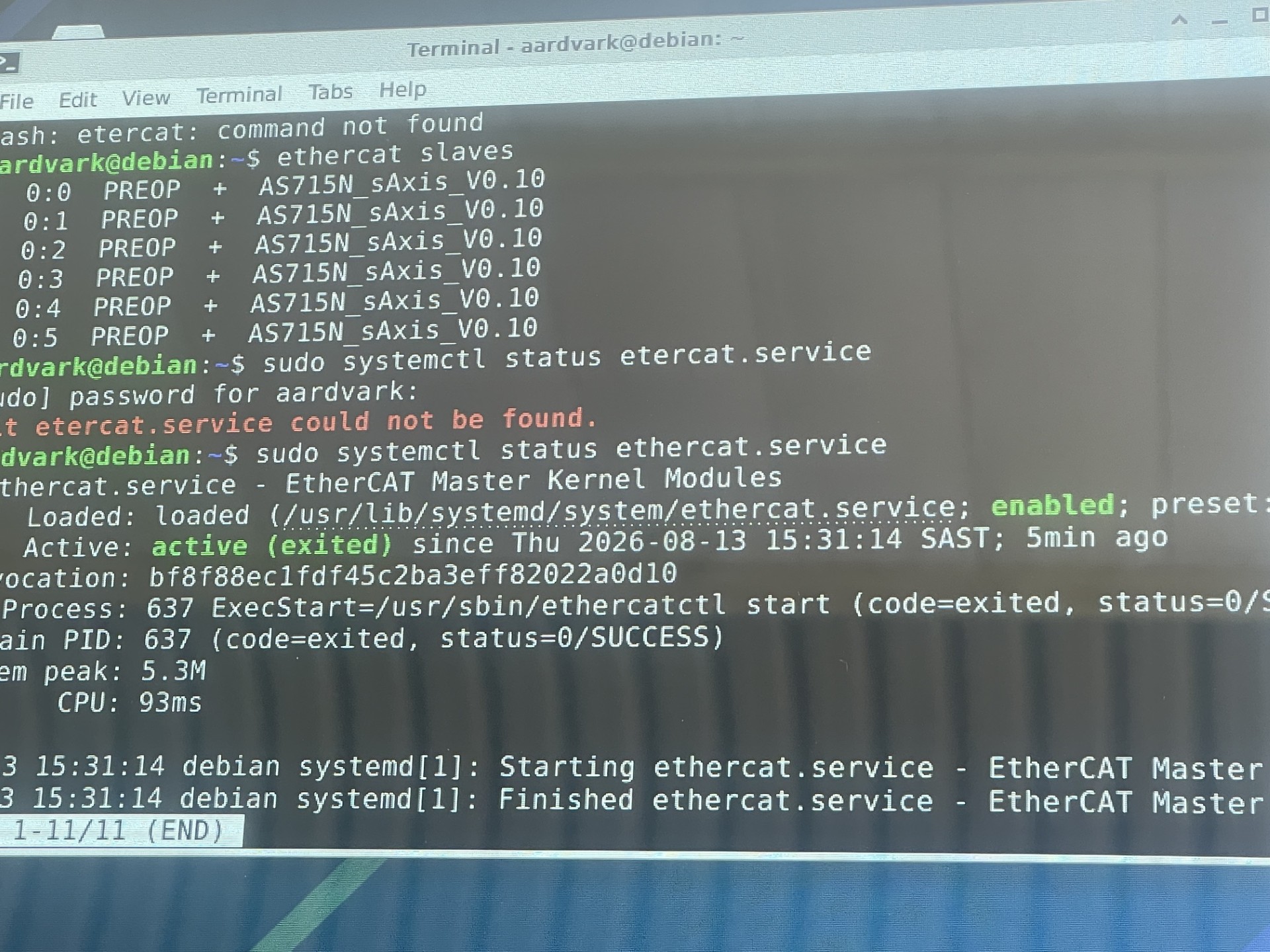

Hi All so i have a question
so how do i know if my Ethercat install is successful, I check the Master is active the Slaves are there
I now need to do the HAL files and config xml
i have this not sure if it is correct
i have 6 servo motors ,

If ethercat reports your six slaves, its properly installed. The next step is to build a xml file which lcec_configgen does the heavy lifting for and then configure then move on to the ini and hal files.
