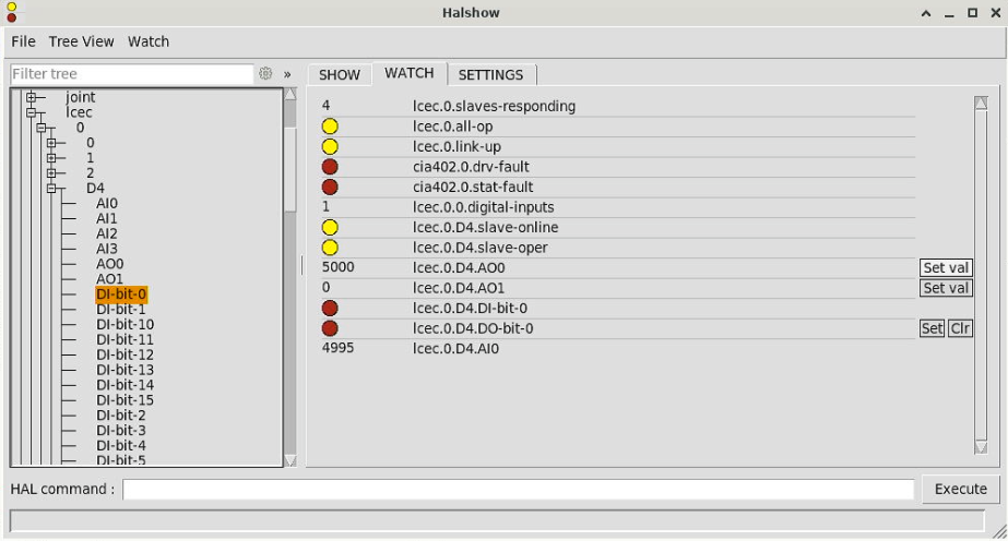

Well that was far less painful than I thought it would be.
AO0 looped back to AI0 gives comparable readings.
All it took was a bit copying and pasting, a few minor value edits, and I have the Analogue and Digital IO working with the following code-
<slave idx="3" type="generic" vid="0x00000b96" pid="0x00001400" name="D4">
      <!--EC1A-CORE1-->
      <syncManager idx="0" dir="in"/>
      <syncManager idx="1" dir="out"/>
      <syncManager idx="2" dir="out">
        <pdo idx="1601">
          <!--Digital Output process data mapping-->
          <pdoEntry idx="7010" subIdx="01" bitLen="16" halPin="DO-bit" halType="bit"/>
        </pdo>
        <pdo idx="1603">
          <!--Analog Output process data mapping-->
          <pdoEntry idx="7030" subIdx="01" bitLen="16" halPin="AO0" halType="u32"/>
          <pdoEntry idx="7030" subIdx="02" bitLen="16" halPin="AO1" halType="u32"/>
        </pdo>
      </syncManager>
      <syncManager idx="3" dir="in">
        <pdo idx="1a00">
          <!--Digital Input process data mapping-->
          <pdoEntry idx="6000" subIdx="01" bitLen="16" halPin="DI-bit" halType="bit"/>
        </pdo>
        <pdo idx="1a02">
          <!--Analog Input process data mapping-->
          <pdoEntry idx="6020" subIdx="01" bitLen="16" halPin="AI0" halType="u32"/>
          <pdoEntry idx="6020" subIdx="02" bitLen="16" halPin="AI1" halType="u32"/>
          <pdoEntry idx="6020" subIdx="03" bitLen="16" halPin="AI2" halType="u32"/>
          <pdoEntry idx="6020" subIdx="04" bitLen="16" halPin="AI3" halType="u32"/>
        </pdo>
        </syncManager>
    </slave>
Obviously doesn't include the ModBus stuff, but I have no use for that.
The lcec_configgen halPin naming did use duplicate names, and the unknown halTypes ( !!type 002e!! ) can be set to either bit or u32 depending on your own preferred usage. I've used bit for now.
