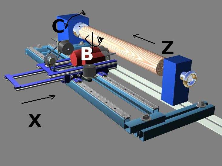

Hello to all,
Is it possible to add a B rotary axis on a lathe (I think the axes would be XZC) and configure a post-processor in fusion360?
Thank you for your help

I guess it kind of depends what that B axis actually does. How would that axis interact with the XZ and or the spindle?

The spindle will be on the B axis.

So is C a spindle and an axis as in a lathe with a spindle that can be positioned or is the B the only spindle and the C just a rotary axis? To me this looks more like a 4 axis XYZA milling setup with a rotary axis A and without the linear Y axis.

The C just a rotary axis and B the only spindle.

Ok then your machine is milling machine with a horizontal spindle and a rotary A axis without a Y axis:
your X is the Z,
your Z is the X,
your C is the A,
and the Y does not exist.
In many CAM software you can define the rotary A as substitute for the missing Y so the tool path for Y is wound around the A axis. I have no experience with Fusion360 so I can't comment on how to do it there but I would expect it be able to do that.
The post processor would be the same as for a regular 4 axis linuxcnc mill.
so you might want to change the title of the post to get more information regarding 4 axis milling in fusion360

I looked in Fusion360 and the rotation part is paying. Too bad because it's for leisure.

are you sure? I can generate 4 Axis tool paths but I never tried to post process cause ma mill only as three axis at the moment
