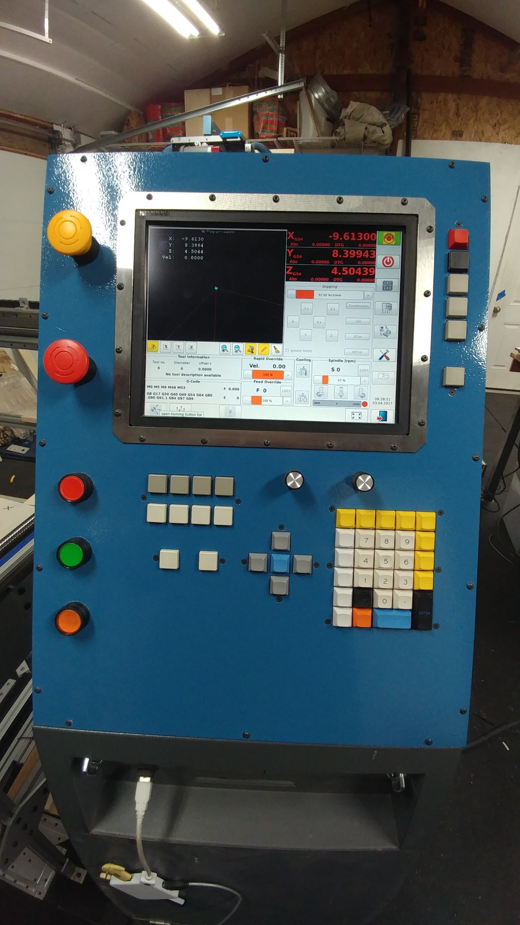

03 Jul 2018 15:22 #113324 by jbunch
Replied by jbunch on topic LinuxCNC start, stop, pause buttons ?
I set my lathe and router up with a feedhold and cyclestart button. feedhold only pauses program cyclestart will start running of the program and will also resume the program after a program pause. I wanted it to work like my Haas mill.
Here is my hal code snipit for this:
# --- Program Control ---
# --- Cycle start and resume ---
net push_cycle_start and2.1.in1 and2.2.in1 <= hm2_5i25.0.7i76.0.0.input-25
net auto_mode_is_set and2.1.in0 not.0.in or2.2.in0 <= halui.mode.is-auto
net invert_auto_mode and2.2.in0 <= not.0.out
net sel_auto_mode halui.mode.auto <= and2.2.out
net interlock_auto_mode and2.3.in0 and2.4.in0 <= and2.1.out
net pgm_is_idle and2.3.in1 <= halui.program.is-idle
net pgm_is_paused and2.4.in1 hm2_5i25.0.7i76.0.0.output-03 <= halui.program.is-paused
net pgm_is_running_invert not.1.in hm2_5i25.0.7i76.0.0.output-01 hm2_5i25.0.7i76.0.0.output-02 <= halui.program.is-running
net pgm_is_running and2.5.in0 and2.6.in0 <= not.1.out
net pgm_idle_interlock and2.5.in1 <= and2.3.out
net pgm_paused_interlock and2.6.in1 <= and2.4.out
net Pgm-Run <= and2.5.out
net Pgm-Resume <= and2.6.out
# --- Program Pause ---
net Pause-Pgm <= hm2_5i25.0.7i76.0.0.input-26
# --- ABORT ---
net Pgm-Stop <= hm2_5i25.0.7i76.0.0.input-27
The following user(s) said Thank You: thadwald
03 Jul 2018 15:43 #113328 by jbunch
Here is my control panel for a Router.
Red button is stop .
Green start and resume.
Orange lit is pause or feedhold.
