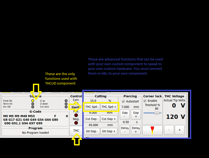

Maybe I can help with some of the confusion about the plasma screen. There are many options on the plasma screen but not all are used or necessary. Some are for advanced use with your own custom hardware and HAL component. For instance, if your Z axis and THC functions are driven by a stand alone motor on the Z axis that is not controlled by LCNC but by the THC system.
I explained all the functions of the buttons and signals but maybe did not specify the separate uses.

I suggest that prospective plasma users read this first. It is a very comprehensive explanation of the plasma process and the meaning and use of all the functions, signals and features.
Gmoccpy Plasma Wiki
None of the plasma functions are internal to Gmoccapy or LinuxCnc. Everything is done outside in HAL or in a component and or hardware. So no signals will be connected unless they are connected to your own component or the THCUD component. The intention was not for the plasma screen to do any functional work but only provide the HMI interface. Some has opted to modify the plasma.py to accommodate their own requirements and as this is not wrong to do it does mean that future updates will destroy the work done. The idea was that unless the THCUD component works for you, each user would code his own component to manage the other complex functions.
THCUD does lack the finer controls such as corner locking. This can however still be done with another component and in conjunction with THCUD.
Please read the wiki and then feel free to ask before you get stuck in. It is not as difficult once you understand the finer nuances of plasma.

Marius, as the author of the Gmoccappy Plasma screen its a shame you did not weigh in when Islander261 (John) and myself were trying to put it together 18 months or so ago. We found there was no precedents to follow at that time. Many of us using LinuxCNC have moved past using external THC's and want to use the Mesa THCAD boards and manage the THC internally.
I am sorry that you had to suffer. Dont we all at some time. I was not available to assist but the documentation explains a lot in detail.
And a lot of us still uses our own external THC and not the Mesa stuff and therefore has to manage the THC externally.
There was no explanation of how you might use the cut height and G0 rapid height settings. There are Gcode routines that bore no relationship with the GUI settings. Today, we can use External offsets but its only become part of master branch in the last month. We chose to use Sheetcam to get these values into gcode.
I am sure that the document explains the purpose but you need to know how plasma works in order to understand the features. That the document cannot teach you.
Sheetcam is a good choice, I only use and supply that to my customers.
John worked out how to change plasma.py to allow GUI settings to also be controlled by Gcode which was a great step forward as we could use the GUI or Sheetcam to set up cut parameters.
This I have a huge problem with if the intention is to merge it to the live system. The GUI settings are not to be controlled but are to provide data to an external component that must do the controlling. It is not a step forward. Changing the GUI is not the way to go. You lock other users out.
Master branch removed some pins so even the Z up and Z down LED indicators could not be extracted from HAL without writing a component (in the absence of a THCUD).
That was the idea. You control everything from HAL
As we moved down the path of writing components, we wanted to extend the system and add auto volt sampling (another fairly simple component) and kerf crossing. These features are not in the GUI.
Again. They must be done in a component. Others might not want to use that.
All of the features and functions of THC and Plasma must be done outside of the GUI.
So in summary, Gmoccapy plasma seduces the user into thinking plasma is easy until you start joining the dots in HAL. It has promise but its far from complete.
You clearly did not read the document. I stated that it was not easy and I explained many of the problems. I also did my best to explain how THC and plasma works. The GUI was never intended to control the THC or any plasma functionality. It is purely meant to give the user all the possible input and output interface in order for them to create their own system.
Remember that there are ,many ways to do THC. Not just the Mesa way.
I think in the future a new Gmocappy screen needs to be developed which is compatible with the work PhilC is doing becasue the guts of it could be prewired and support THCUD and Mesa THCAD type configs.
Unless a new screen is written that explicitly services the Mesa product and it is named so, and the original is still available, it will definitely break other systems. I fully agree with variety but exclusivity or favoring one product is not playing the game.
I am glad that you got your system working in the end but I am a bit shocked at the attitude of wanting to change things when it is not understood. Also at the fact that it can be allowed to favor a specific product in doing so. I trust that the changes has not reach the master branch yet as I would object if it is done at the cost of the current working system.
I do support the idea of separate development for specific hardware but I do not support the idea that any one becomes the mainstream system. The original screen was written to enable any user to put their system to work on the LinuxCnc platform.
Regards
Marius
www.bluearccnc.com
