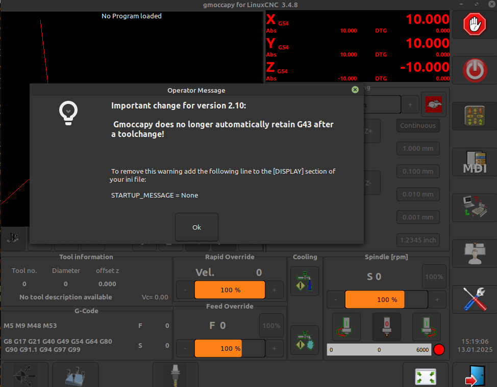

Hello Chriss,
History:
Gmoccapy had an integrated functionality. If a tool was changed, the tool correction was automatically turned on.
github.com/LinuxCNC/linuxcnc/blob/e586c3...ccapy.py#L3537-L3541
I named this functionality AUTOMATIC_G43.
The idea of this functionality is great. Unfortunately, this functionality was implemented in the Gmoccapy GUI. This caused race conditions in certain LCNC configurations and on certain hardware. Norbert had a problem simulating these bugs at all.
After long discussions, Norbert agreed to remove AUTOMATIC_G43 from his Gmoccapy GUI. However, he had a condition that this functionality be preserved at least using REMAP.
github.com/LinuxCNC/linuxcnc/pull/3113/f...d37cd778756e98de8fff
And in the configuration files for Gmoccapy, this Remap should be added.
My wish:
I added this remap to the configurations, but a lot of configurations are done using PNCconf. I wish the configurations from PNCconf included for Gmoccapy:
added in INI file:+ Python and Macro file:
I think it will be very dangerous when Gmoccapy users switch from version 2.9 to 2.10. If they change the tool and the tool correction does not change as they were used to, it can cause physical crashes of the machines. That is why I would like PNCconf to retain this functionality in version 2.10 using REMAP.
As an advantage of this PNCconf modification, I see that users will have a template for creating Remaps. It is difficult for a beginner to understand what toplevel.py, stdglue.py, remap.py are for. This way they would only modify change_g43.ngc and/or settool_g43.ngc.
I don't know how to approach this:
1) make the above changes only for Gmoccapy
or
2) make the AUTOMATIC_G43 functionality in PNCconf for all GUIs. Gmoccapy should have this functionality enabled by default.
Fortunately, we have enough time, because this will be needed only for LCNC 2.10

13 Jan 2025 04:17 - 13 Jan 2025 04:18 #318860
Replied by Aciera on topic LCNC 2.10 - Ask for AUTOMATIC_G43
I think a pop up window with a warning message on startup in gmoccapy 2.10 might be more helpful as there are going to be a number of users updating from previous versions to 2.10.
Last edit: 13 Jan 2025 04:18 by Aciera.

13 Jan 2025 08:24 #318865
Maybe something like this:
1. Insert this at the end of the '__init__(self, argv)' method in 'gmoccapy' (ie after line 516):
2. Insert this a the end of 'lib/python/gmoccapy/getiniinfo.py':
Looks like this:
startup_message = self.get_ini_info.get_startup_message()
if startup_message == None:
message = "Important change for version 2.10:\n\n Gmoccapy does no longer automatically retain G43 after a toolchange!"
self.dialogs.warning_dialog(self, _(message),
"\n\n\n To remove this warning add the following line to the [DISPLAY] section of your ini file:\n\n STARTUP_MESSAGE = None ")
elif startup_message.lower() != 'none':
print('startup_message = ',startup_message)
self.dialogs.warning_dialog(self, _(startup_message),' ')2. Insert this a the end of 'lib/python/gmoccapy/getiniinfo.py':
def get_startup_message(self):
message = self.inifile.find("DISPLAY", "STARTUP_MESSAGE")
if message:
return message
else:
return NoneLooks like this:

13 Jan 2025 09:19 - 13 Jan 2025 09:22 #318868
The idea was that the user can also define a custom startup message like this:
[DISPLAY]
STARTUP_MESSAGE = My message is ... !
So instead of creating all this code just to alert users to a version change it could actually be used for other things.
Changing the wording of the message is trivial.

14 Jan 2025 04:32 #318936
by JT
Replied by JT on topic LCNC 2.10 - Ask for AUTOMATIC_G43
I added a popup message warning users about the issue with a link to this thread so they can choose to add it or not

14 Jan 2025 08:58 #318948
by newbynobi
Replied by newbynobi on topic LCNC 2.10 - Ask for AUTOMATIC_G43
This kind of message after an update has never been used before. IMHO it should go into the update script not in the GUI code!
And do we want user to edit a text file like in old DOS times? The popup needs a checkbox with "do not show again" and after clicking the message ist gone for ever.
