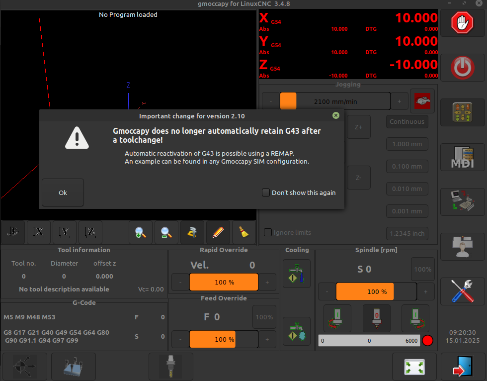

Not every user used to the old behavior that switches to 2.10 is going to use the update script. The point is that EVERY user that starts Gmoccapy the first time in 2.10 gets the notice.
Sounds good to me. The state of whether to show the message or not would be stored in the .pref file I suppose.
However I don't have the time to figure out the popup with the checkbox right now so if somebody knows how to do that then please go ahead.
thanks
The popup needs a checkbox with "do not show again" and after clicking the message ist gone for ever.
thanks

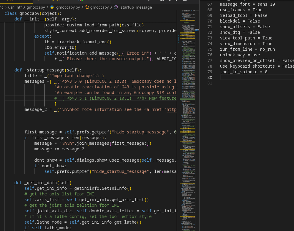

I think it's good to have an information system that notifies also about new features that are disabled by default (for compatibility reasons).
I implemented such, based on Acieras snippet.
It is able to hide the messages you have read but displays new ones id there will be any in the future.
You can try it out using this branch: github.com/hansu/linuxcnc/tree/gmoccapy-info-message

Looks like this
Last edit: 09 Feb 2025 09:03 by HansU.
- Posts: 4818
- Thank you received: 2176
09 Feb 2025 09:18 #321051
Replied by Aciera on topic LCNC 2.10 - Ask for AUTOMATIC_G43
I like it.
