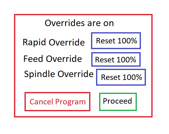

Suggestion / request:
Overrides
When starting a program running (cycle start): user is prompted that an override (rapid, feed, or spindle) and asked whether they want to continue with override, or want to reset to 100%
I could imagine make an optional warn dialog with a settable limit. For all overrides? Feed, rapid and spindle?

05 Jul 2025 04:30 - 05 Jul 2025 04:35 #331295 by pippin88
Replied by pippin88 on topic Gmoccapy 3.5.1
Overrides
Yes, something like attached.
Warning pop up if any override is on.
Last edit: 05 Jul 2025 04:35 by pippin88.
09 Jul 2025 07:26 #331559 by HansU
Replied by HansU on topic Gmoccapy 3.5.1
"Reset to 100%" would not work if you are using analog signals for the overrides.
So it will be only options for proceed and abort.
09 Jul 2025 07:55 #331561 by pippin88
Overrides are just set via physical up and down buttons, or via GUI in my setup.
New machine will sue encoders to have physical knob.
If easiest, a pop up warning that overrides are set, and buttons to cancel program, or proceed, would be very useful.
