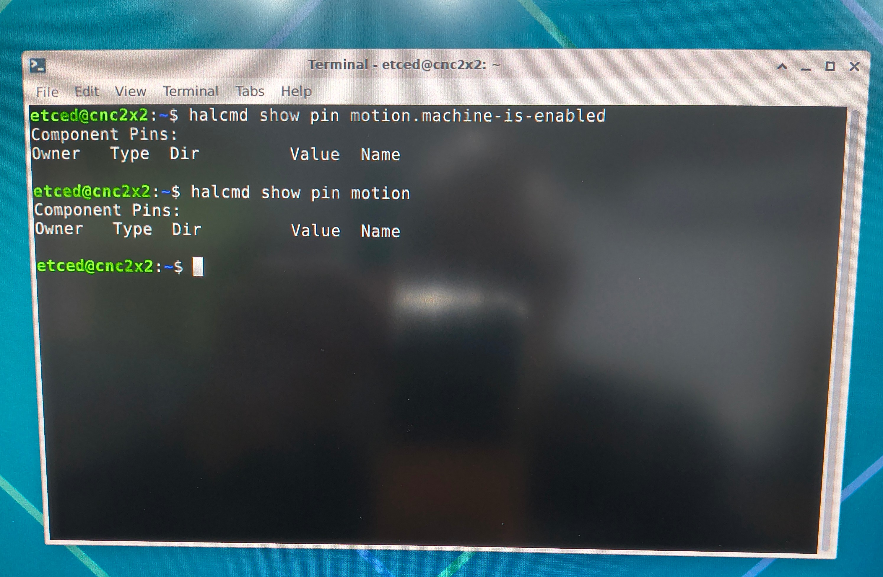

Replied by tommylight on topic can not jog axis in Gmoccapy
What is pin "machine-is-enabled" connected to in hal?

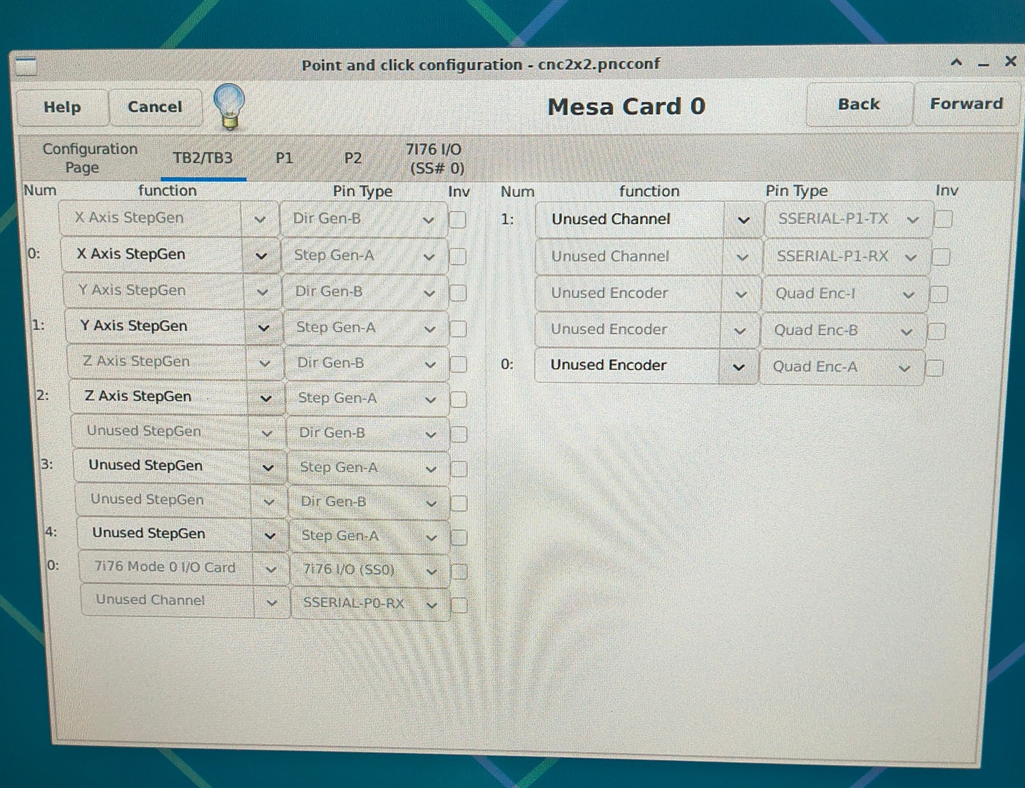

Since I am a linuxcnc newb I hope that the below pic is what you are asking for.
I have CL57Y drivers , currently they are wired to: PU+ PU- DR+ DR- . The MF+ (enabled +) and MF- (enabled -) are not connected.
If they do need to be connected do I connect them from MF+ to the +5v and from MF- to GND on the TB2 terminal?

NO, do not touch the wiring if it works with Axis GUI.
Upload the config files here so we can have a look, the working and non working ones.

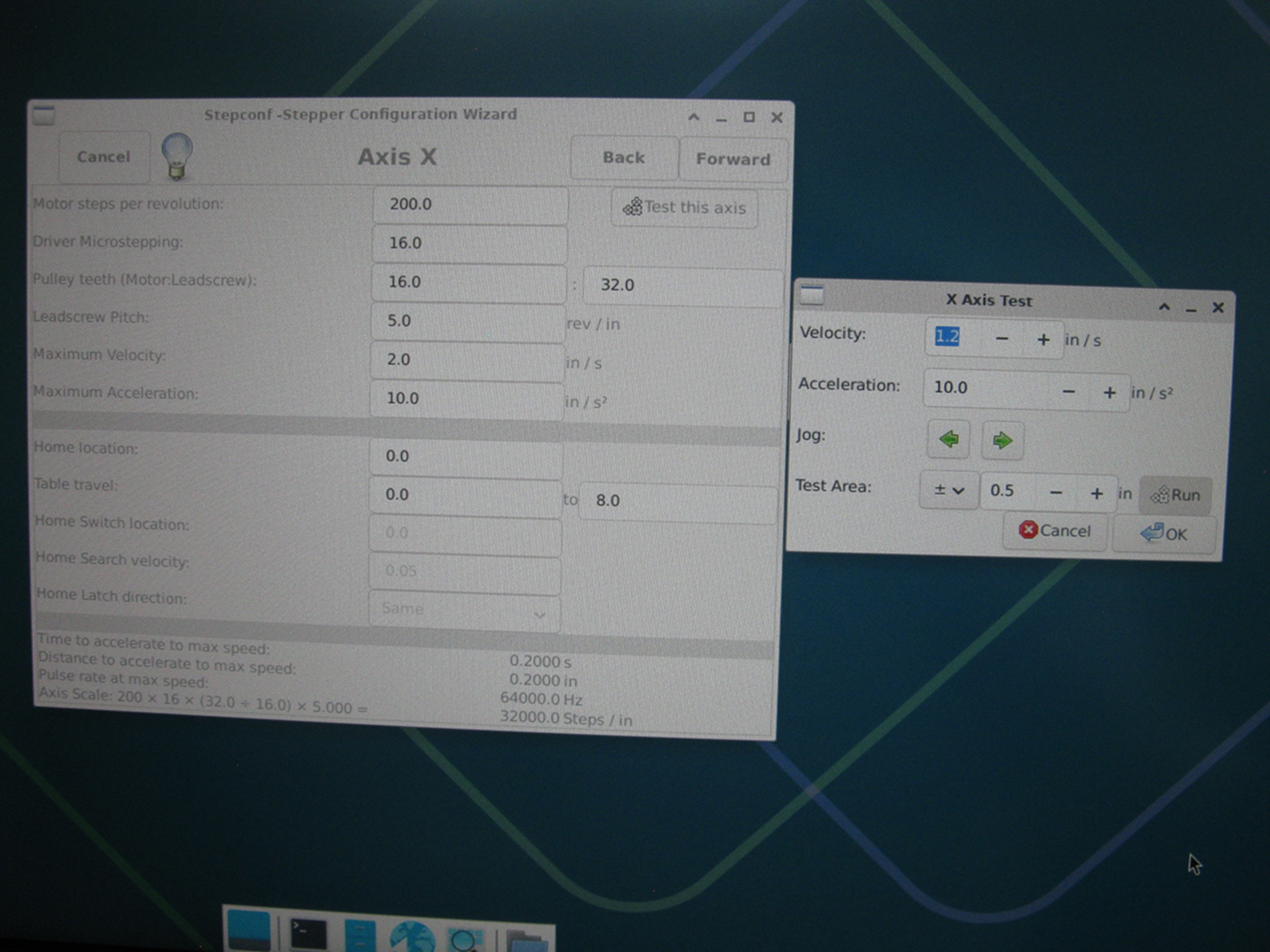

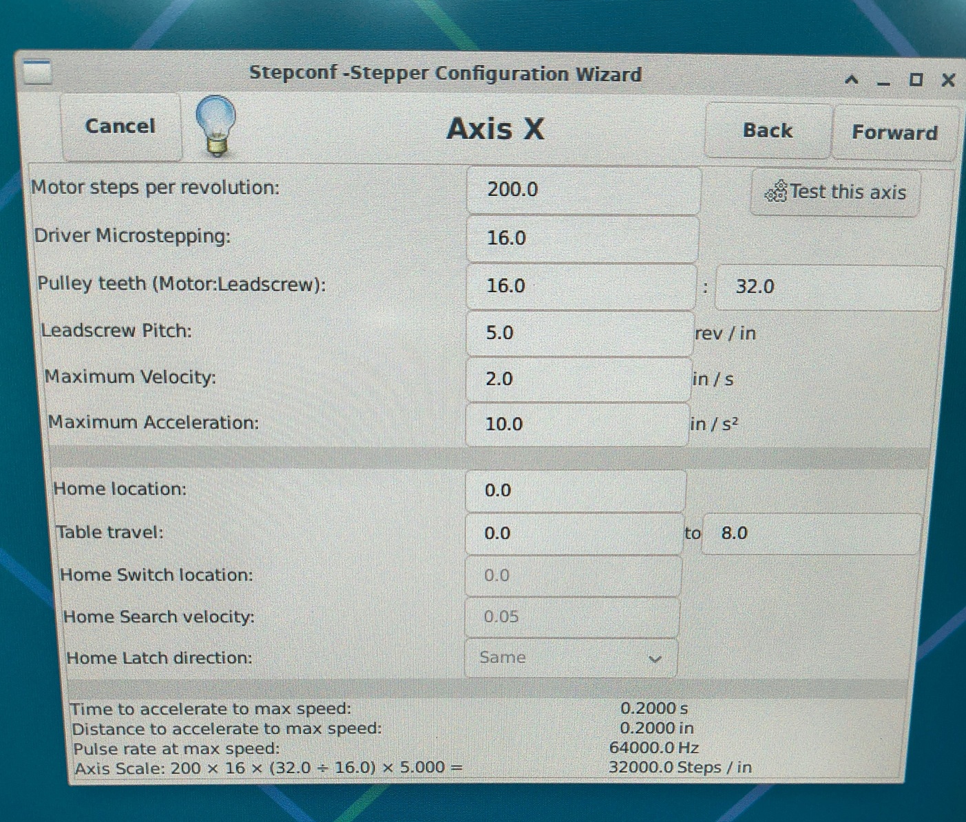

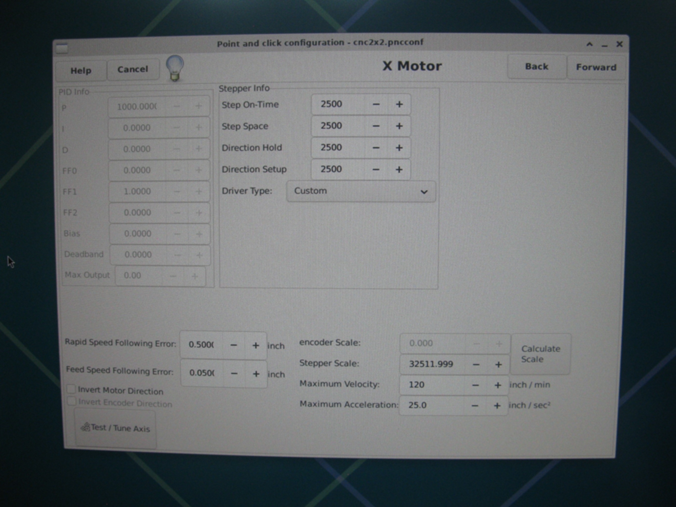

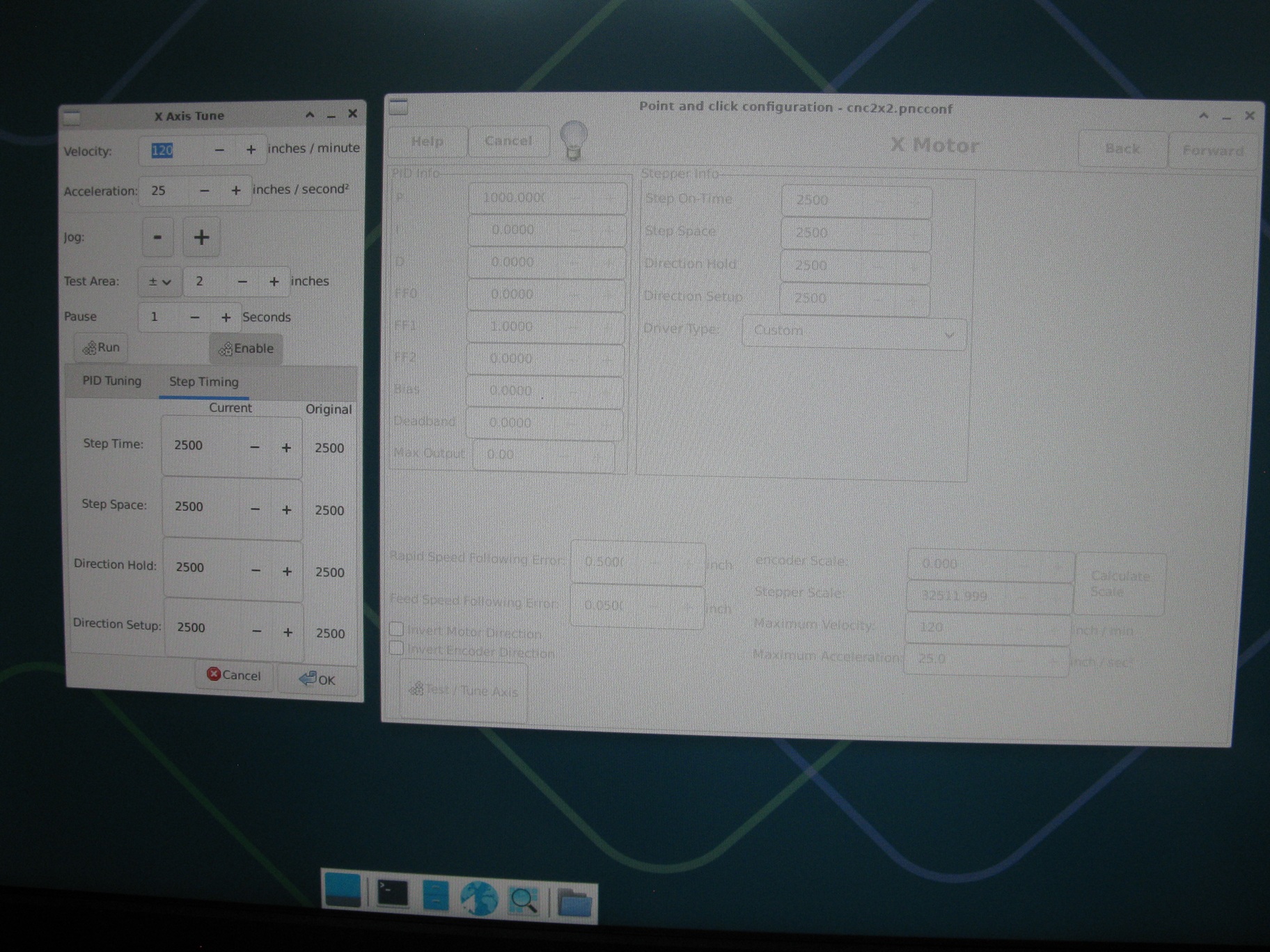

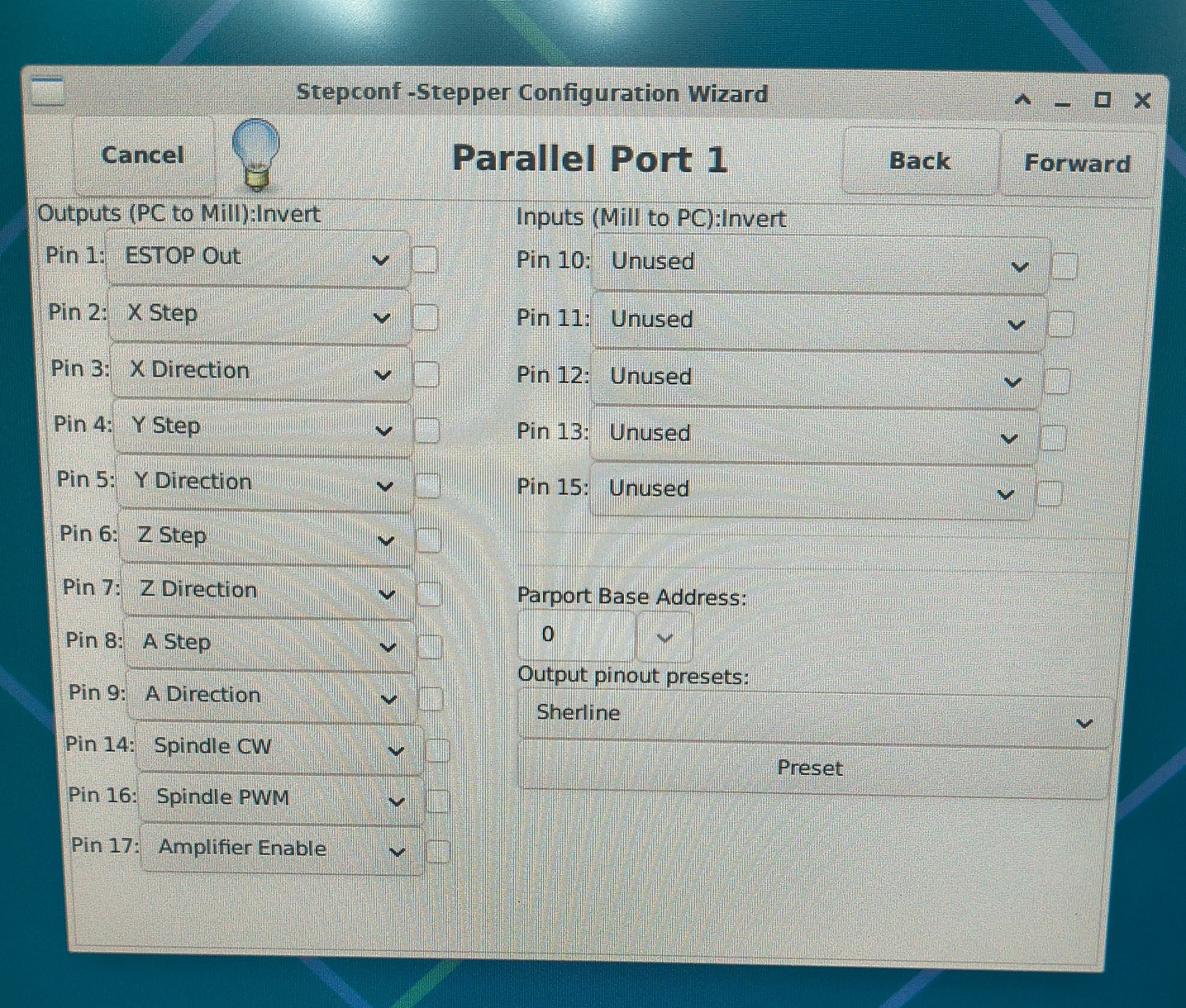

I just noticed that in the PNC config wizard "test this axis" that I can jog xyz. However in the Step config wizard "test this axis" I can not jog xyz.

Step config files, where xyz jog does not work.

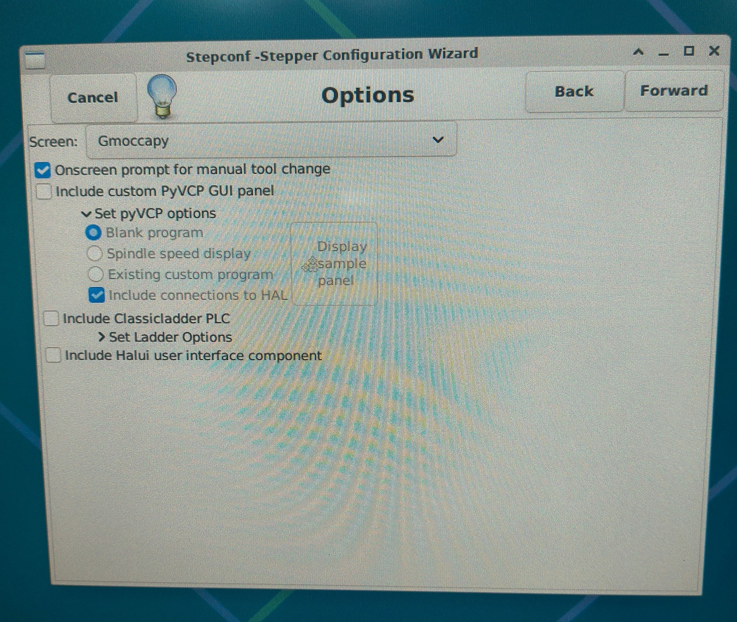

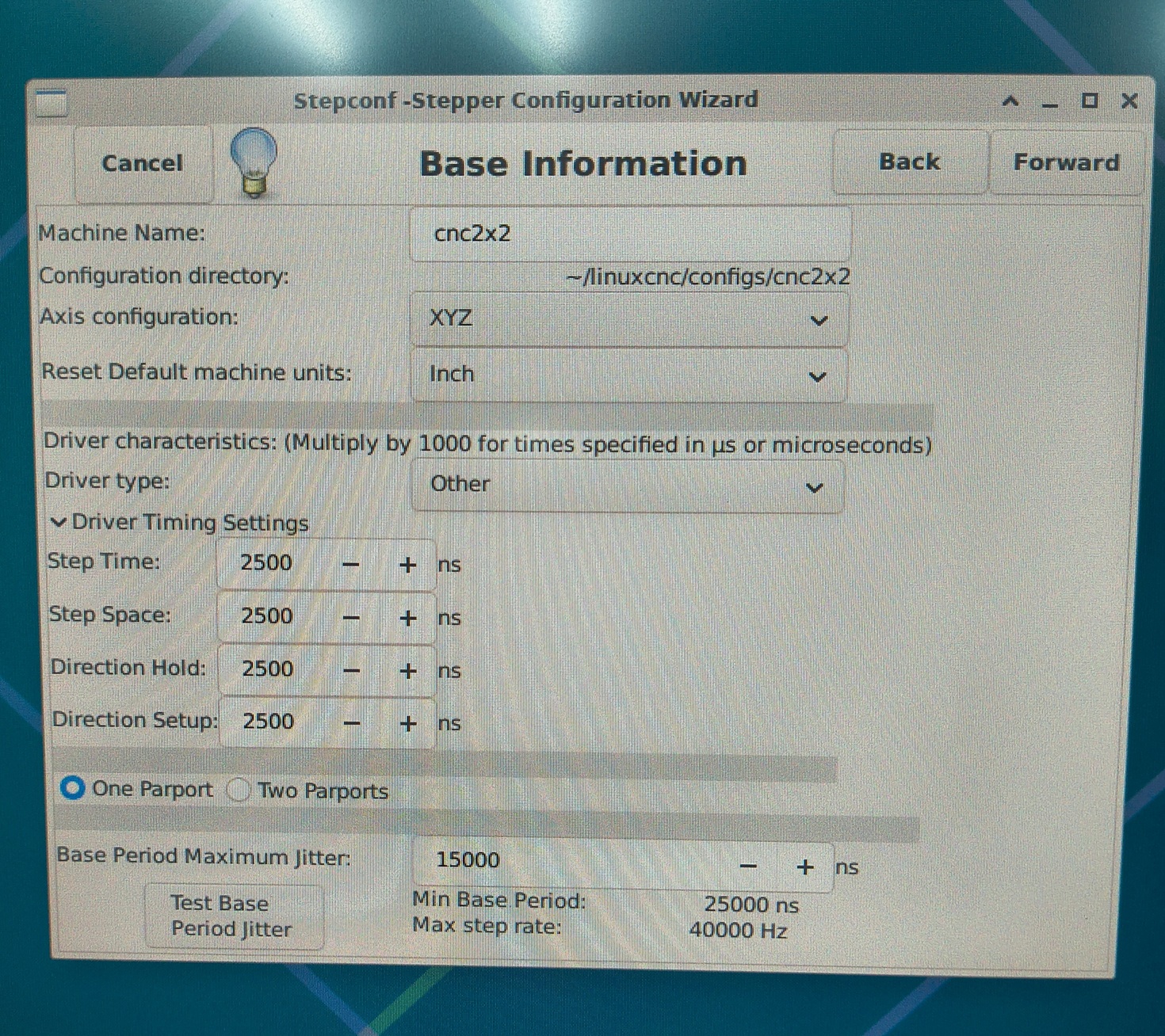

This is confusing, why stepconfig?
Stepconfig is for parallel port setups, only.

Ok, that makes sense, I deleted the step config file. Currently I can jog XYZ in the pnc config "test this axis" .
Gmoccapy jog does not work but shows movement on screen.
