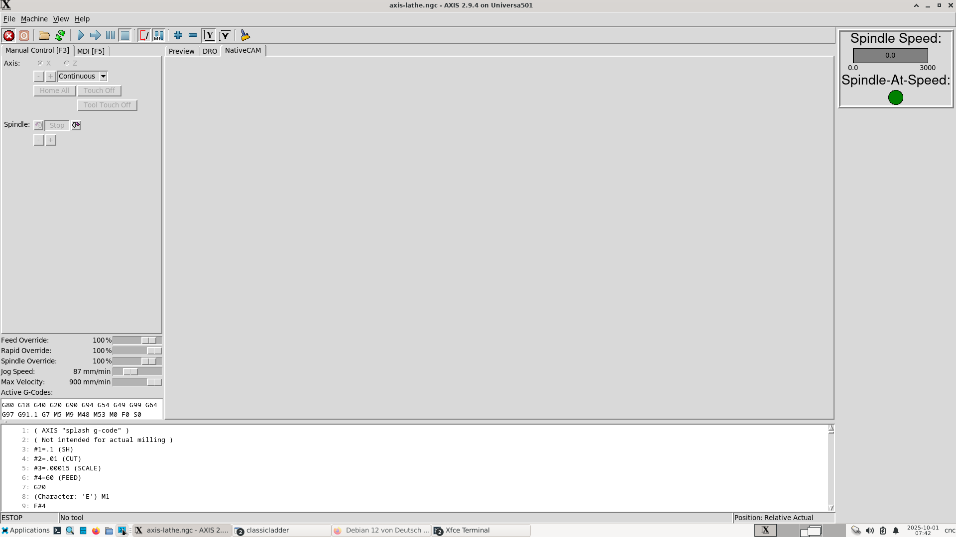

Hello everyone,I managed to get Nativecam loaded and running on the 2.9.4 iso, using the
github.com/freemoore/NativeCAM
download, and Giovanni’s instruction pdf plus all the corrections along the way. I ran a huge victory lap when I saw the Nativecam Tab in Axis not blank but how it supposed to look! But…..as usual the fight is not over and my troubleshooting skills are limited by my total lack of experience with Nativcam as I have never used it before.The problem is the Nativecam project is not dynamically updating in the Axis preview ,tab and if I try exporting the project as gcode the .ngc file is mostly composed of stuff that looks like this:
I’ve been asking the AI questions about how Nativecam is supposed to work and I think its been mostly correct but is often describing how it “used to work” and not necessarily how it works now. My gut tells me the problem has something to do with a symbolic link or a missing ncam.ngc file. Any thoughts are greatly appreciated!-Doug

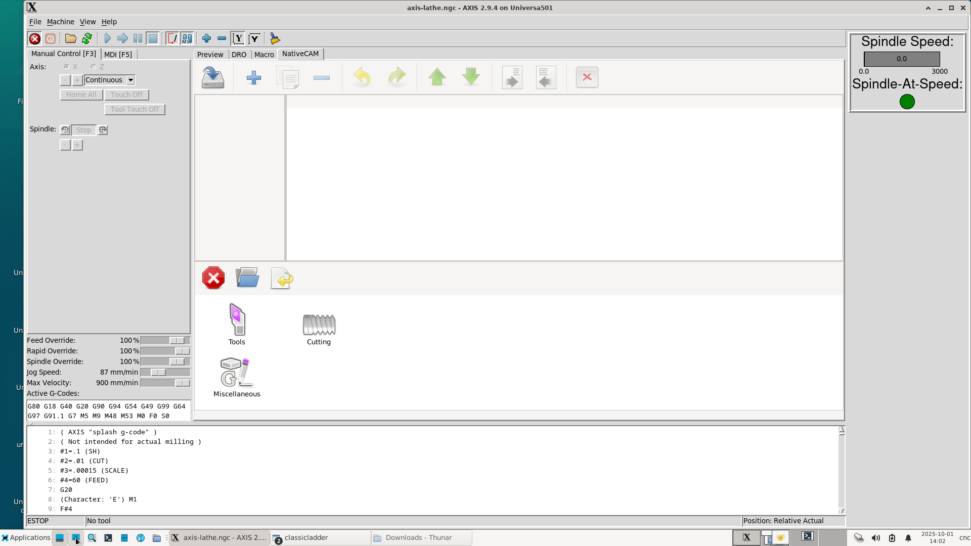

I'm trying to reinstall LinuxCNC on Debian 12, but I can't get NativeCam to work. I'm missing the menu and actions in the left pane. Does anyone have any ideas?

I suppose you are using German as interface language.
Have you tried to use English?

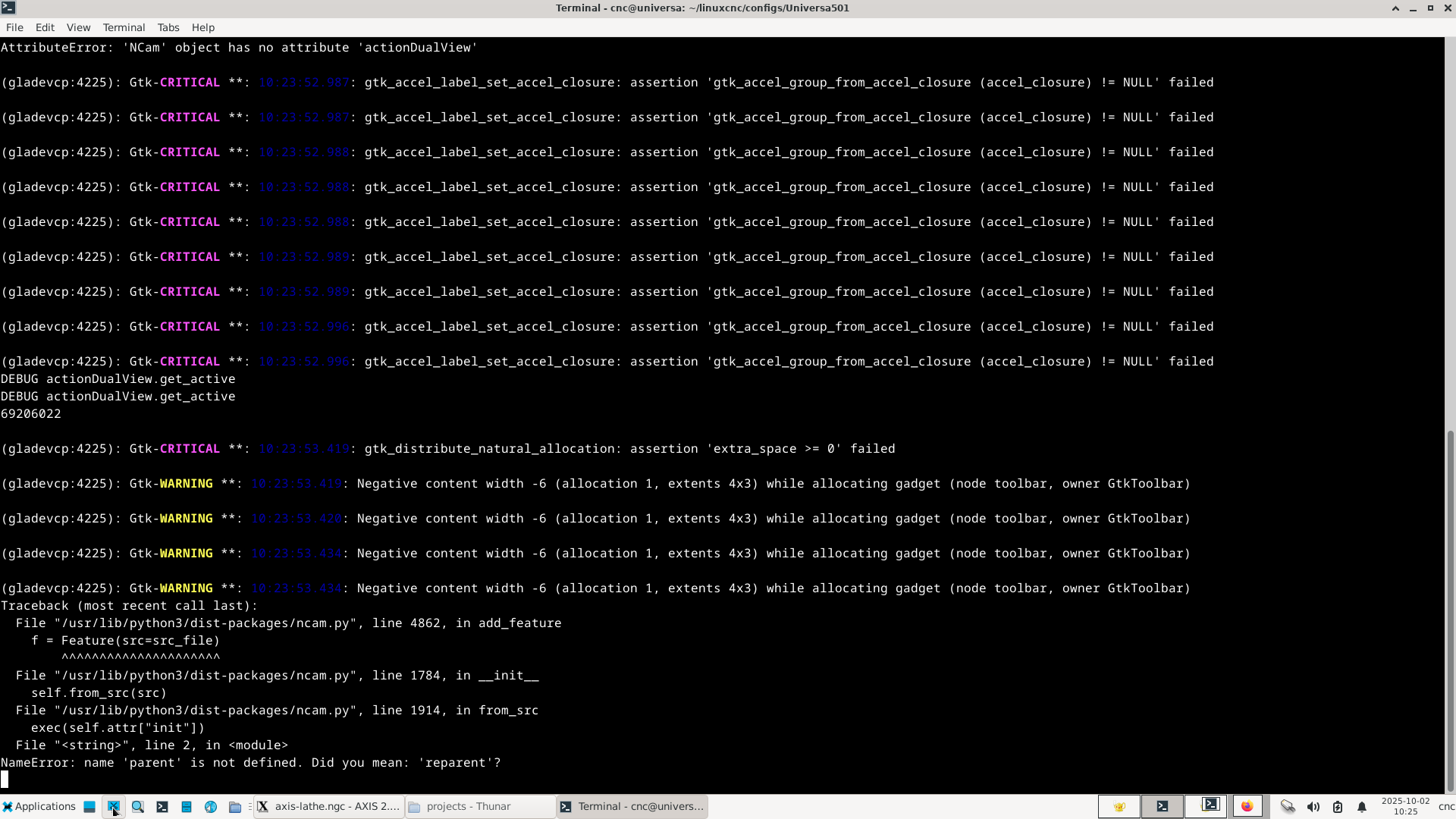

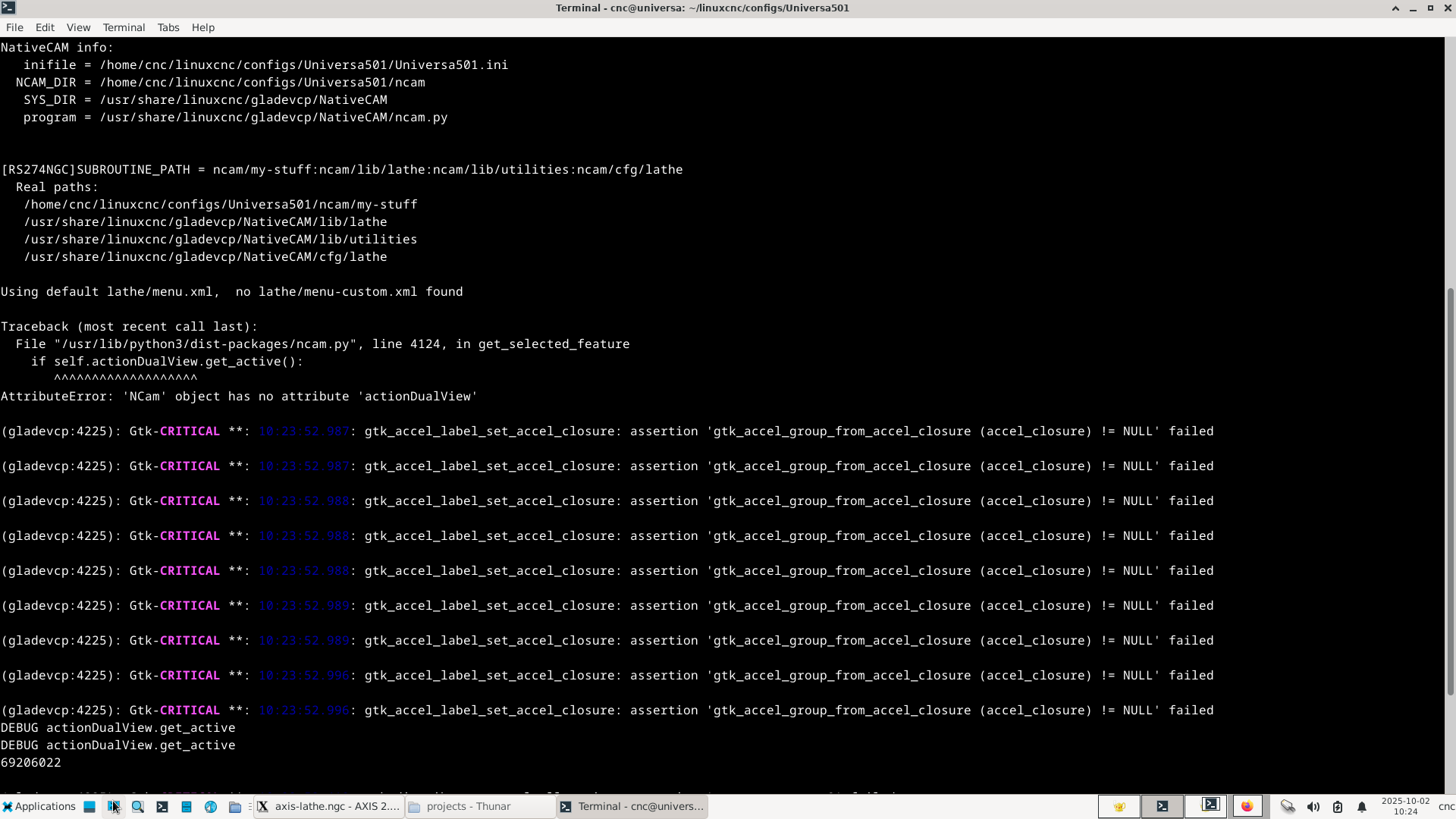

Giovanni, the default_template.xml file was missing. I used your file from the other thread and now the menu and workspace appear, but I can't add a tool change. The following error message appears when I start linuxcnc in the terminal.I looked at the tool-change.cfg, and it says version=1.15, while the other cfgs say version=1.14.And one more point: in an old default_template.xml from 2019, there are two sections:

I think something is wrong with these 2 cfg files
turning.cfg
tool-change.cfg
both don't work, the rest seems ok
File "/usr/lib/python3/dist-packages/ncam.py", line 1914, in from_src
exec(self.attr["init"])
File "<string>", line 2, in <module> <<<<<<<<<<<<<<<<<<<<< Which module??
NameError: name 'parent' is not defined. Did you mean: 'reparent'?
Only in this files, "parent" is used.
I deleted these blocks with "parent" as a test, and it worked. However, I don't know what the potential effects might be; I'm not familiar with this.
turning.cfg
tool-change.cfg
