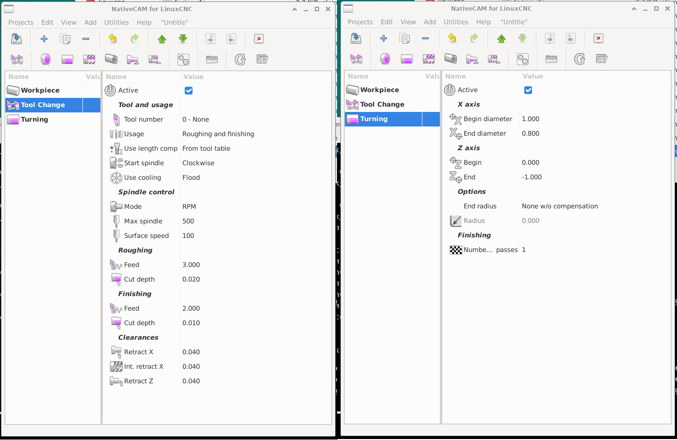

Does anyone have lathe working?
Run - python3 ncam and mill loads
Run - python3 ncam -c lathe and get the attached errors

I followed all the steps you listed and applied the fixes. Now it loads both standalone and imbedded.
The SYS_DIR sets itself to /usr/bin so i changed it in ncam.py to be "/usr/share/linuxcnc/gladevcp/NativeCAM"
In lathe everything works except change tool and straight turn. When I select these icons they give the following error:
File "/usr/bin/ncam", line 4955, in add_feature
f = Feature(src=src_file)
File "/usr/bin/ncam", line 1736, in __init__
self.from_src(src)
File "/usr/bin/ncam", line 1864, in from_src
exec(self.attr["init"])
File "<string>", line 2, in <module>
NameError: name 'parent' is not defined. Did you mean: 'reparent'?
Any idea how to reslove this is appreciated. Cheers

I have found 2 problems: in turning and tool-change operations.
I found a workaround since at this moment I have no time to really understand and find a solution for the errors.
So, please do not consider it a solution.
In the folder /home/your_user_name/nativecam/cfg/lathe/ you should find the
config .cfg files.
(Or maybe the files you are using are in /usr/share/linuxcnc/gladevcp/NativeCAM/cfg/lathe/)
Edit the turning.cfg file and search for the word "parent" (without quotes).
(maybe you could make a backup copy before editing)
I have found it in line 71, 99, 100
Place a semicolon (that it means comment) at the beginning of each line containing the word "parent".
Save the file.
Same procedure for the tool-change.cfg file.
Please comment lines 76 to 80 and 198 to 203 containing "parent"
The turning operation and the tool-change seems to work.
I don't know if there would be side effects.
Hope this helps.
Regards
Giovanni

Thanks! Unfortunately for turning this change allows it to run but breaks the code for this function.
