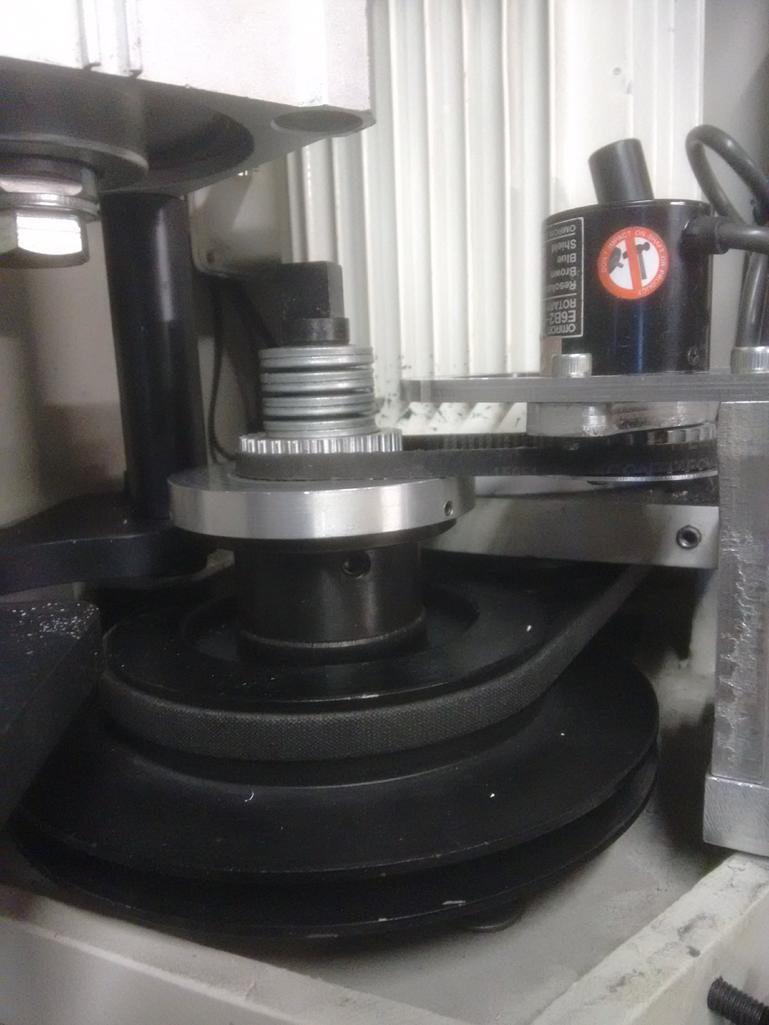

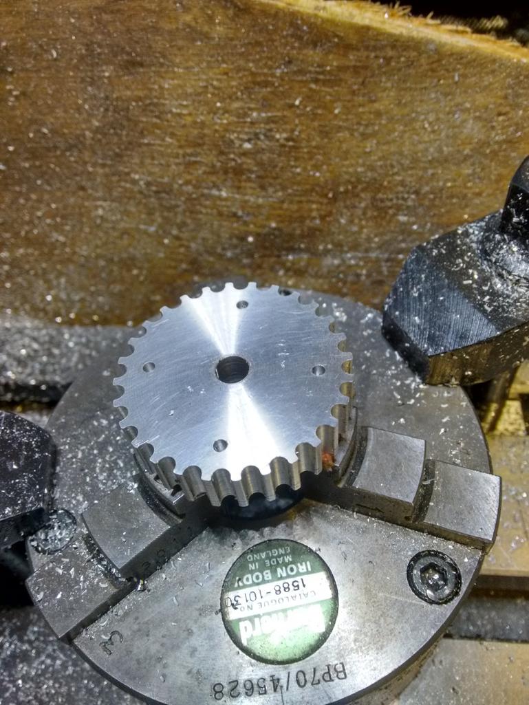

Fitting an encoder on a Tormach 1100

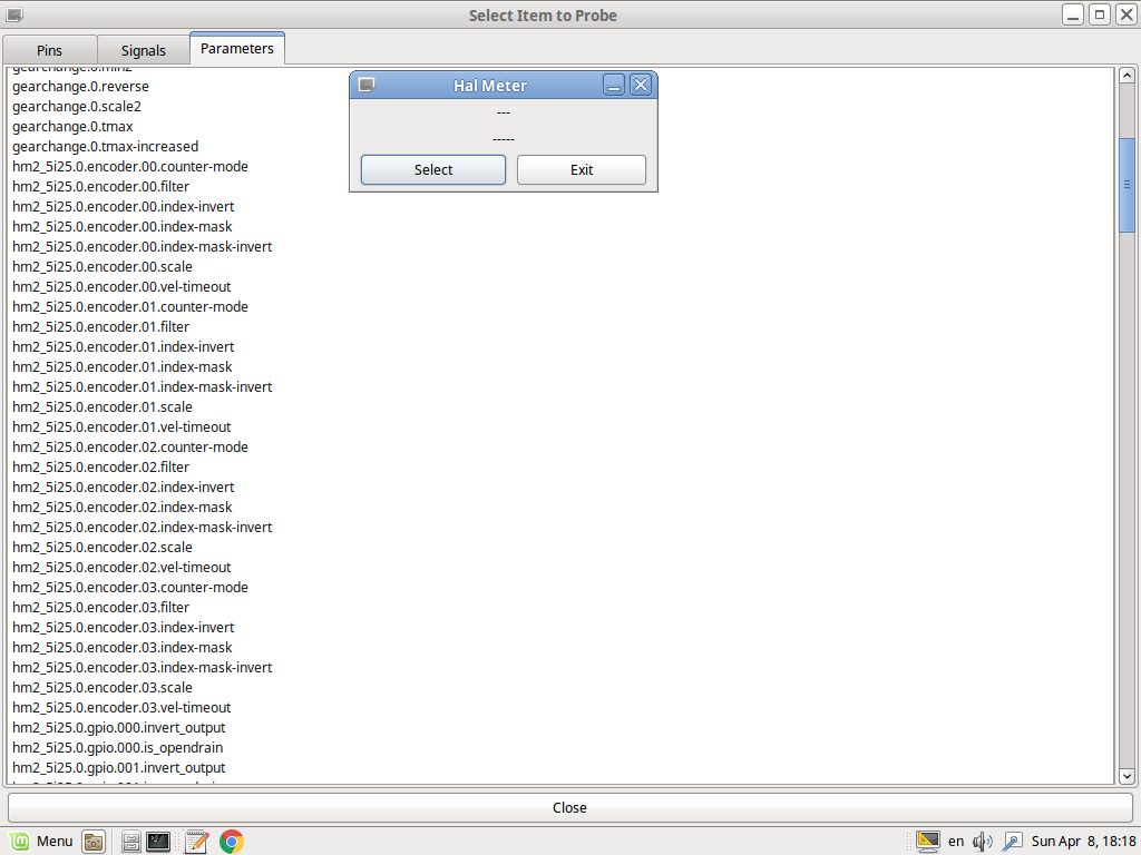

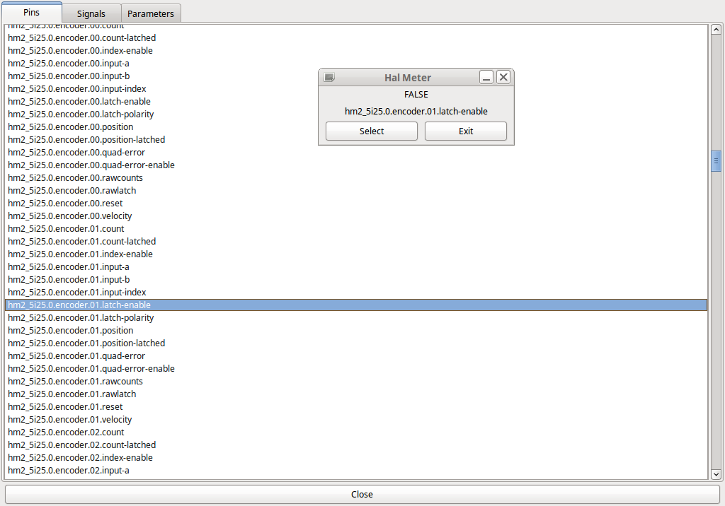

08 Apr 2018 17:29 #108612
by Clive S
Replied by Clive S on topic Fitting an encoder on a Tormach 1100
Thank you Andy & Peter for your patience.
I am having trouble getting halcmd to work ( I can see it on the machine in various places) but I have managed to print this from halmeter which i believe is the correct pins and
I have loaded 4 encoders but initially I would like to use encoder.0 to use the spindle for rigid tapping it has 2000p/r I could change it for 1000p/r if needed. Then if I can get that going first I would like 3 MPG's as well.

08 Apr 2018 17:43 - 08 Apr 2018 17:44 #108613
Replied by PCW on topic Fitting an encoder on a Tormach 1100
OK so as a start you will want to:
setp hm2_5i25.0.encoder.00.scale 8000
( a 2000 PPR encoder has 8000 quadrature counts per turn )
You can verify this by hand rotating the spindle, and "halmetering" hm2_5i25.0.encoder.00.position
if scaled properly, the encoded position should change by 1 for each turn of the spindle
Last edit: 08 Apr 2018 17:44 by PCW.
08 Apr 2018 17:44 - 08 Apr 2018 17:45 #108614
Should be all you need.
Replied by andypugh on topic Fitting an encoder on a Tormach 1100
net spindle-position hm2_5i25.0.encoder.00.position => motion.spindle-revs
net spindle-velocity hm2_5i25.0.encoder.00.velocity => motion.spindle-speed-in
net spindle-index-enable hm2_5i25.0.encoder.00.index-enable <=> motion.spindle-index-enable
