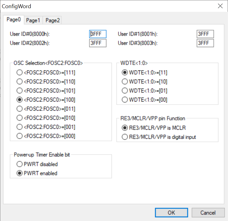

Since Tormach made it Public they supported Right ot Repair and Subsequent call out video they Released most all their schematics and firmware files. Still waiting on the VFD files, VFD Unlock Codes, Pic Chip Config Bit Settings.
Their Github is at github.com/tormach/Repair-Information

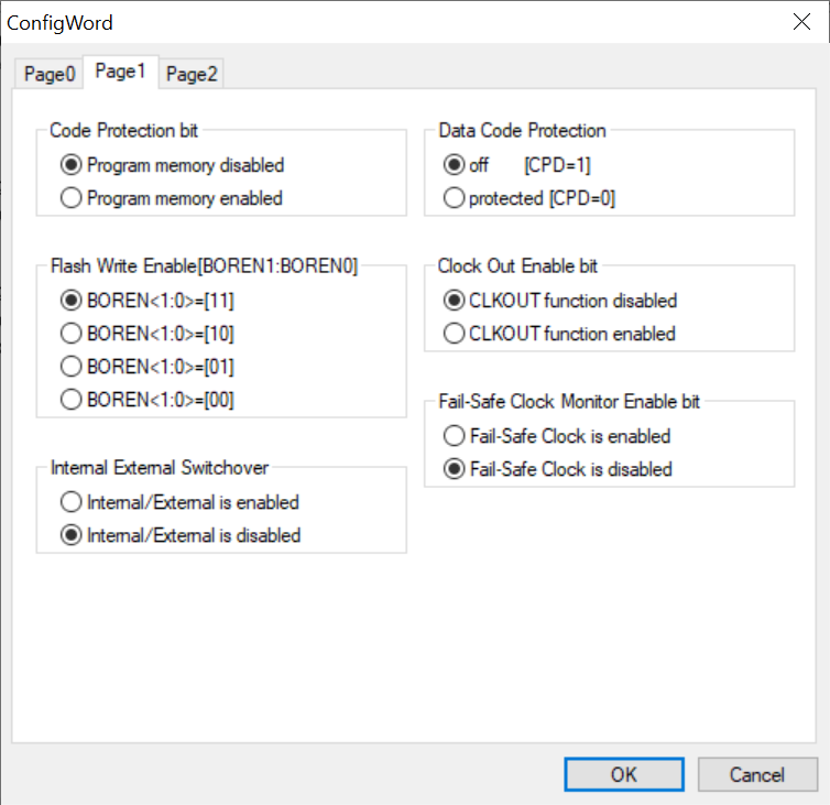

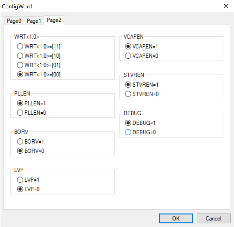

I did update my Lathe Control Board's PIC16F1947 Firmware
Config Bits Read Form My PIC16F1947:
I also updated my PCNC 1100 Series II Boards PIC16F872 to a Series III Seems to be Working fine.
PIC16F872 Config Bits Read Form Working Series II Chip.
File Name SeriesII_V1.HEX
