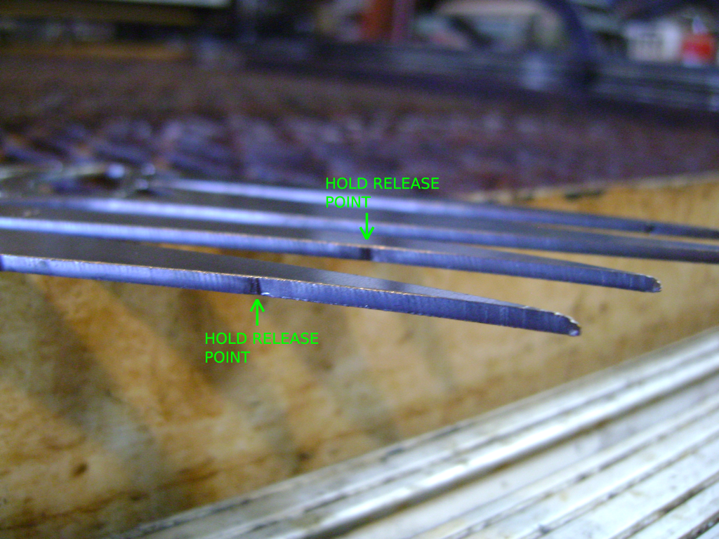

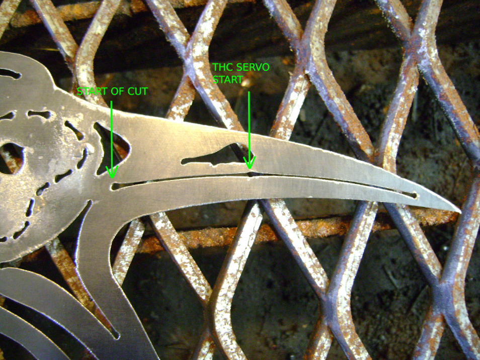

Hello
I have found some strange behavior when cutting that didn't show when I was testing with straight lines. The torch is making a small "divot" in the cut when the THC starts servoing after starting the cut and when it starts servoing again after a corner, velocity or kerf crossing hold. The "divot" is small and only visible from the bottom or side of the part. This is cutting 14ga ( about 2mm) hot rolled steel sheet at 220ipm at 45A. All the hold controls are done in HAL components so I don't think there is much delay happening. Sorry,I don't have any halscope plots of this happening because it is so hard to get the triggering right when cutting out a whole sheet of parts. I will start on a dedicated test at some point down the road that I can monitor with halscope.

01 Jun 2018 21:47 #111415
Replied by tommylight on topic THC Servo Start
That is strange, if the THC servo is on the servo thread maximum delay should be about 0.1 to 0.2mm at that speed, i can not figure out why is that taking so long ( roughly guessing from the picture, over 1 second ). Can you test that on a straight line? Might that be because of the radius ( arc ) at the beginning and active corner lock ? Can you test it with corner lock disabled ?

01 Jun 2018 22:02 #111417
by islander261
Replied by islander261 on topic THC Servo Start
Tommylight
Thank you for the reply. The point at which the THC starts servoing is correct. I have a about .75s delay between the arc ok or ok to move signal from the plasma power supply before the THC starts servoing. The marks from the corner hold being released are in about the correct place. I have not tested with no corner hold (I actually use a velocity hold instead of a hard distance) yet but expect to see no hold release mark when I do. I didn't have this happen when I did all my straight line testing while getting the THC working correctly.

01 Jun 2018 22:02 #111418
Replied by PCW on topic THC Servo Start
How is the hold done?
If you have a PID loop with I term, you must disable the PID (say by tying its command and feedback inputs to the same value) when its not in control or you will get integral windup, causing a major glitch when you re-enable the control loop
