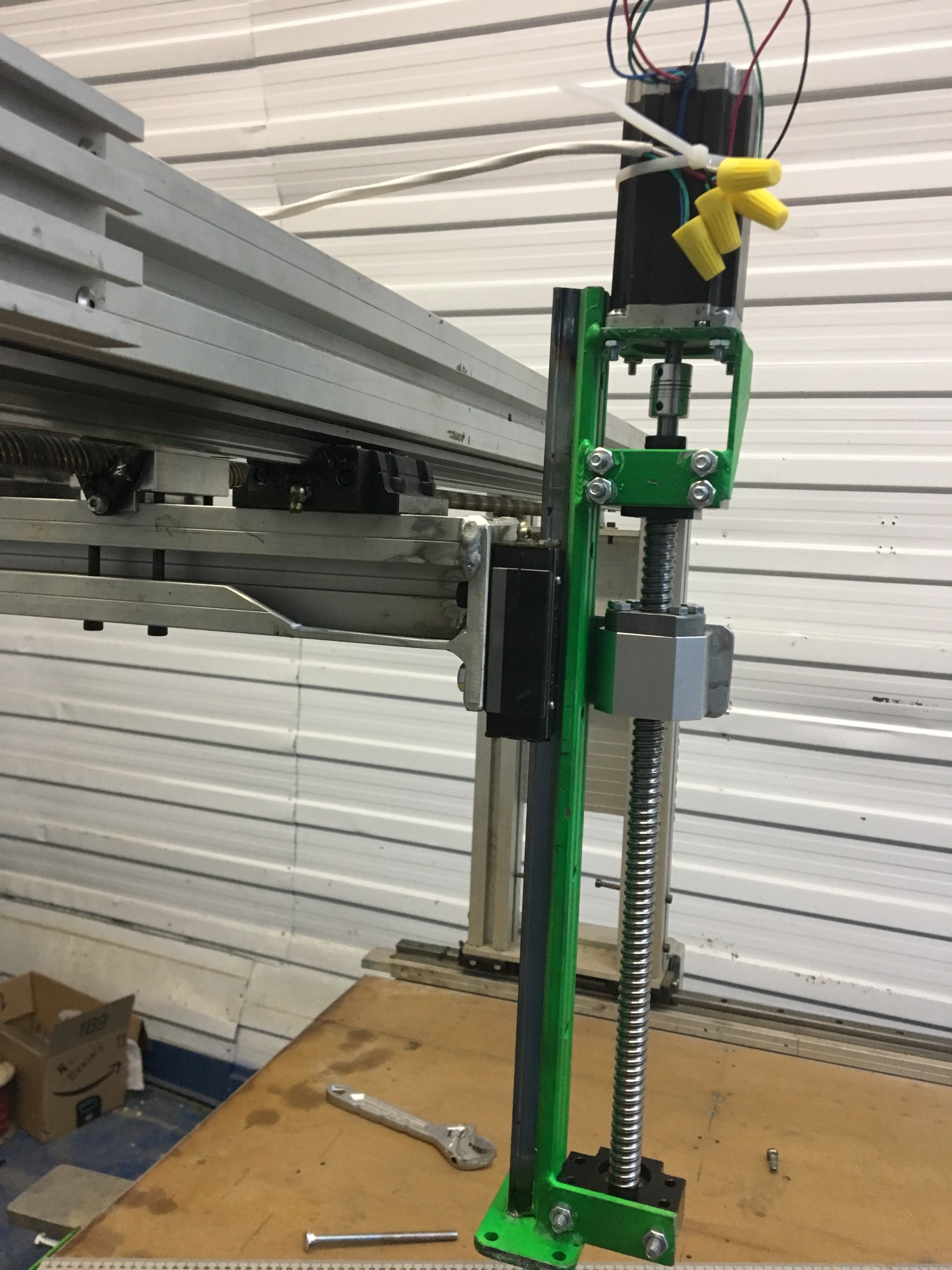

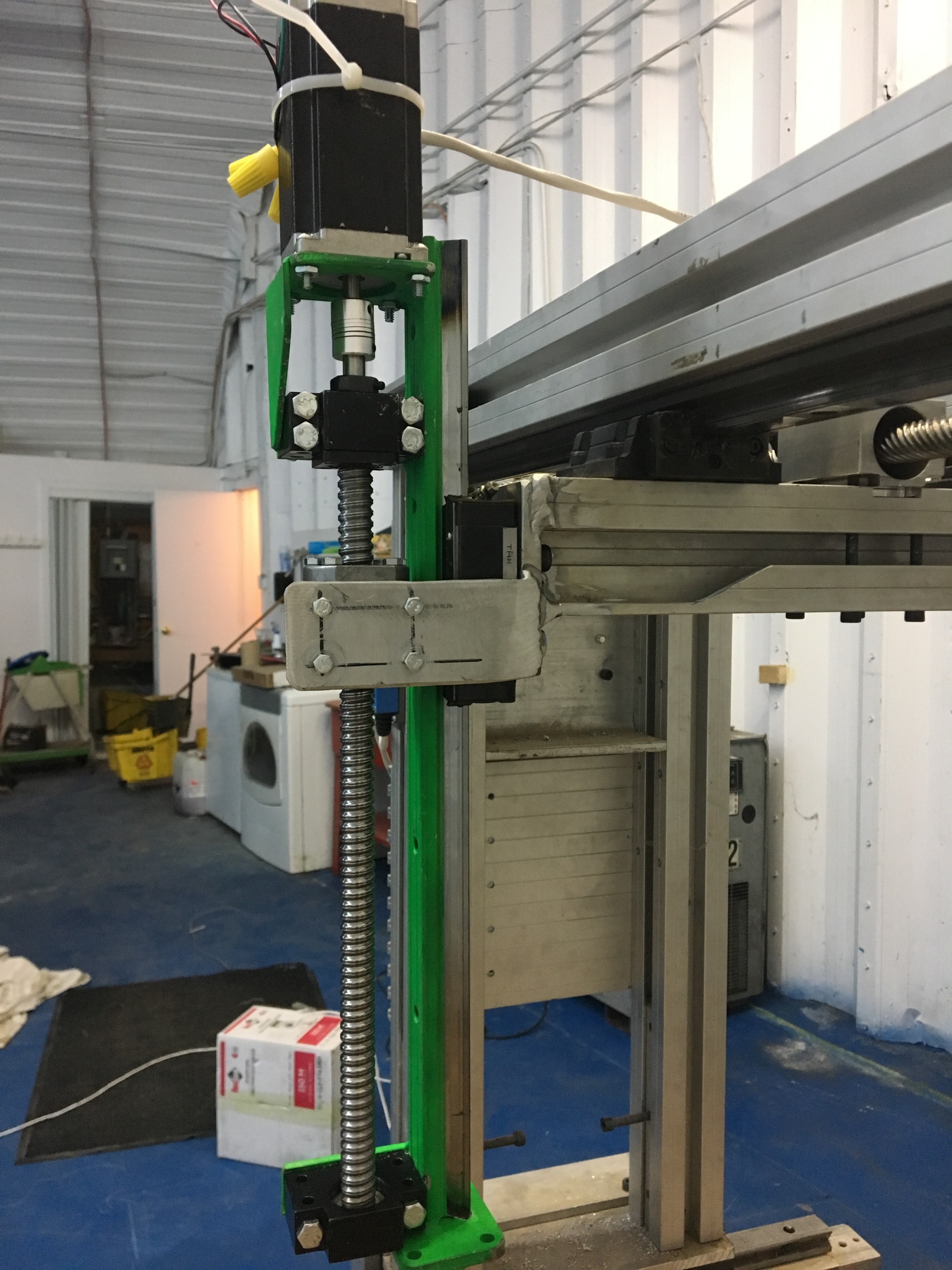

I should have started a build log earlier.
5X10 plasma table with linear bearings mesa 5i25 - 7i76
I will start taking pics. Just installed the Z tonight so I will embed a video.

Replied by rodw on topic New Plasma Build
Bevins, nice.
I would recommend you replace the helix misalignment coupler with a oldham style coupling
A high quality helix style is good for 1.1 Nm torque and the blue one here is good for 5 Nm The maths said there is about 3.3 Nm torque on acceleration on a 269 oz/in NEMA 23 stepper. Flex in the coupling could result in overshoot when servoing for torch height control.

Haven't decided yet what we are doing for the head. Probably a floating head, not sure yet though.
Replied by bevins on topic New Plasma Build
Nice !
No floating head ?

Yeah, Don't know what I am doing yet with that. I am just happy to get it this far so fast......
THC is another thing I have to work out.
Bevins, nice.
/SNIP

Even if you do have ohmic sensing, you really need the floating head as a backup. I used a short piece of HGR15 Hiwin rail and a carriage as I bought a much larger piece of rail second hand so I had some offcuts.
Nice !
No floating head ?

Yes, you need a floating head switch on your Z axis ( helps to save torch parts as well) I am the odd guy out here. Mine is set up as the Z- limit and is sensed during probing and used if the ohmic sensing doesn't trip. I must say now that I have my very complicated probing macro (actually a subroutine) working I have had very few probes that went to the float switch. I must confess that I am using a commercial set of Z axis mechanics.

That will be heaps. I think the piece I used only had 3 mounting holes and you have 4. I barely have 1/2" of travel but its enough to trigger a proximity sensor (or micro switch). You can actually see how little of the rail protrudes above the green carriage in my photo.
