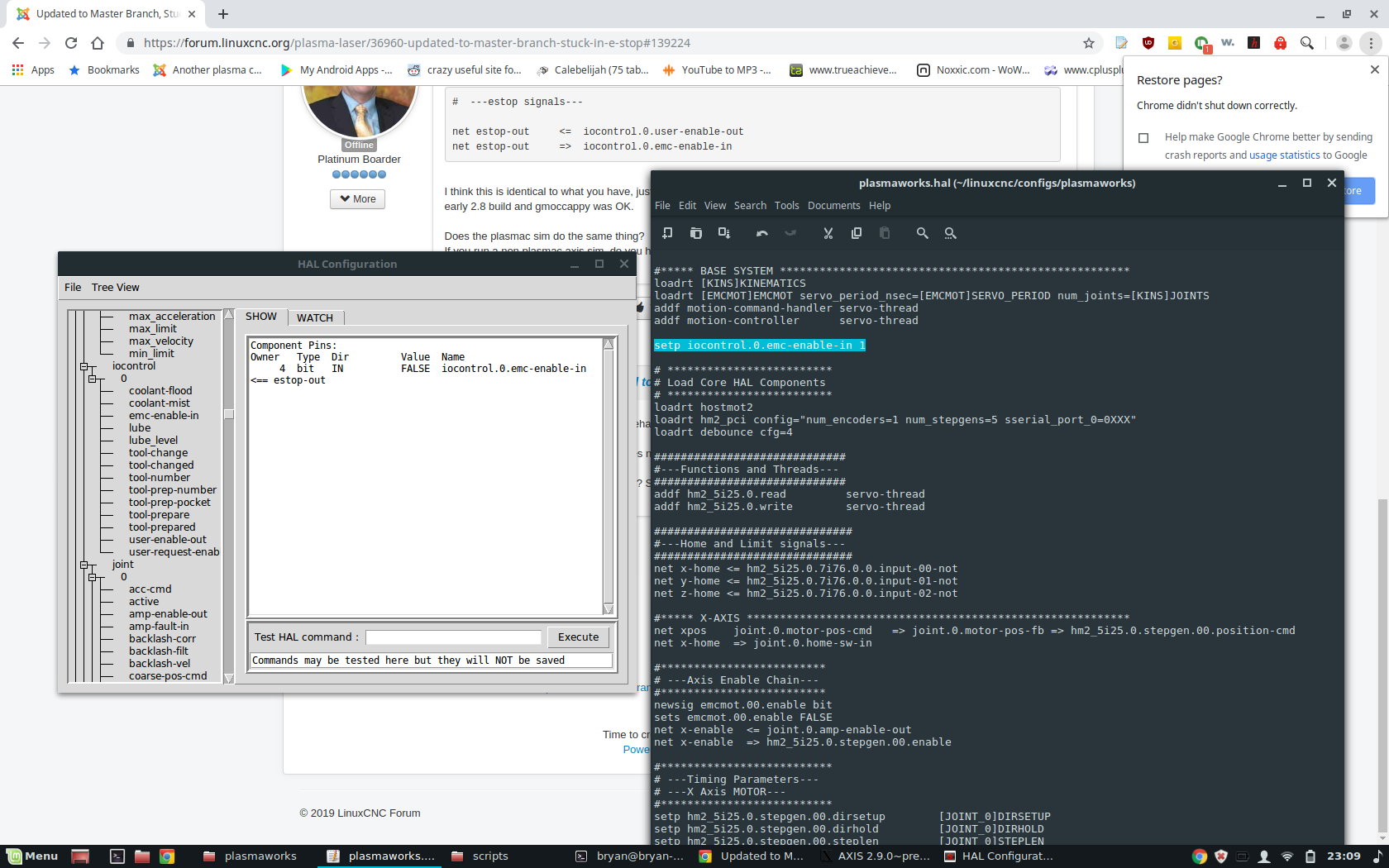

Just updated everything to 2.9.0 so I could pull the Plasmac updates more easily. I ran the plasmac configurator.py and updated my .ini file.
When I start linuxcnc and verify that it's running 2.9.0-pre0, axis starts up but I cannot toggle out of e-stop.
If I change my config to use Gmoccapy, I can get out of e-stop and everything appears to be working (I have motion).
I had a working configuration before I updated.

I tried the change and it has the same behavior.
The plasmac axis sim works fine, as does non plasma axis sims.
Perhaps it's something with my axis files? Seems strange that gmoccapy works and axis doesn't.
Edit: Looking at the pin "iocontrol.0.emc-enable-in" it's reading FALSE. Shouldn't this be TRUE due to the setp I have in my HAL? Perhaps it's getting set to 0 somewhere else?

# ---Axis Enable Chain---
newsig emcmot.02.enable bit
sets emcmot.02.enable FALSE
net emcmot.02.enable <= joint.2.amp-enable-out
net emcmot.02.enable => hm2_5i25.0.stepgen.03.enable hm2_5i25.0.stepgen.04.enable
Why does joint 2 connect to stepgens 3 & 4?
I'd be tempted to run pncconf and get a working config and then cut and paste the stepgen stuff into your hal file as there were significant changes between 2.7 and 2.8/2.9 But if you opened ran your original 2.7 config, the config files should have been converted to the new format

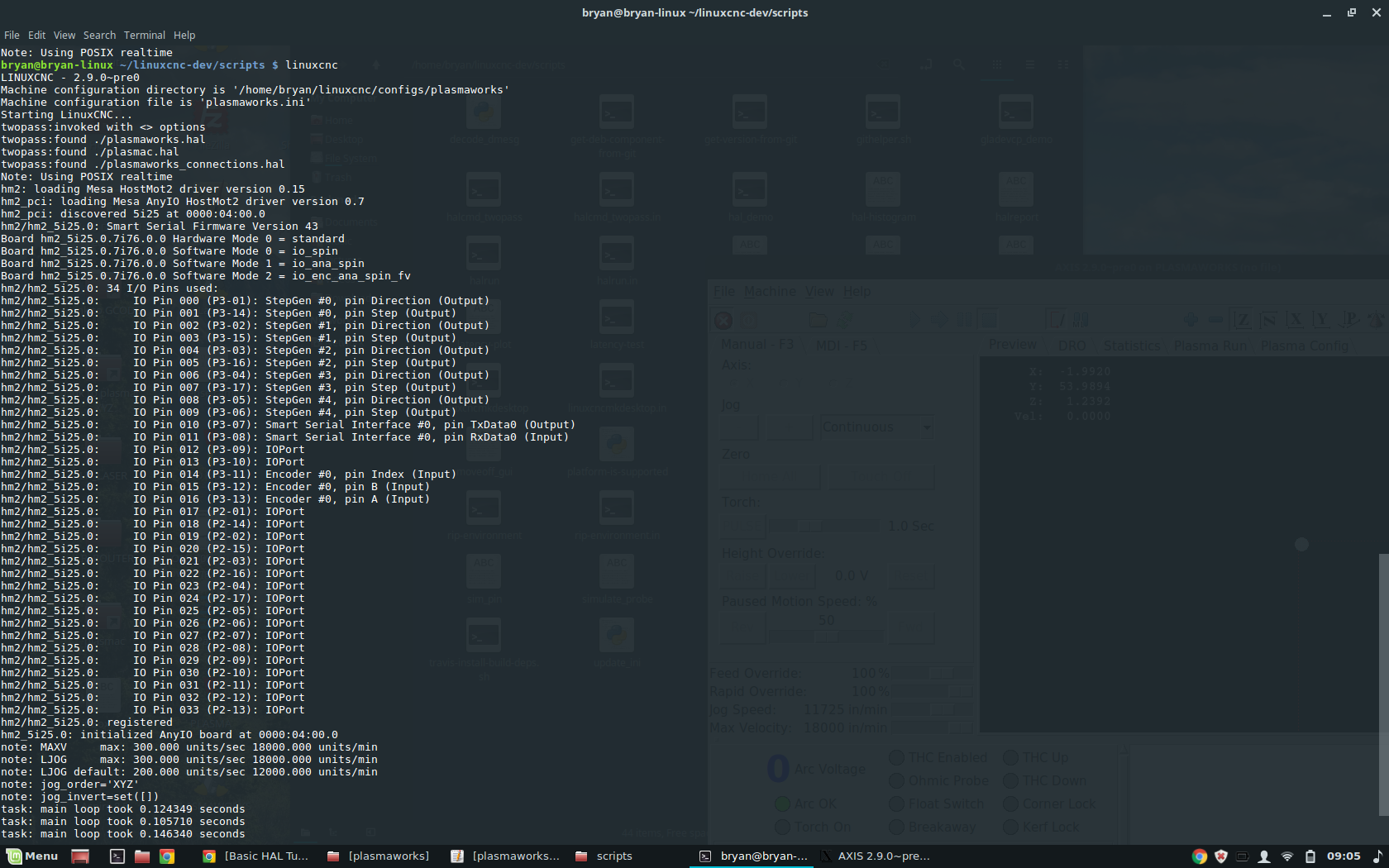

13 Jul 2019 13:15 - 13 Jul 2019 13:49 #139251
by Uthayne
Yes, if I comment out the Axis line and uncomment gmoccapy, it works as in I can move my machine around. Nothing plasma related is loading but I assume that's because I'm missing some python files in my dir possibly? I couldn't find a plasmac_gmoccapy.py like the plasma_axis.py.
No errors are shown when loading Axis.
As a test I started a config I have for the same machine (same hal file, and mostly same ini), but when I use it as a router (no plasmac stuff). Still on 2.9.0, it comes out of e-stop just fine. It appears to be something specific to plasmac+Axis?
I'm going to try starting from scratch, converting the functioning sim over.
Edit: Starting with the Axis sim (/home/bryan/linuxcnc-dev/configs/by_machine/plasmac/axis), I converted everything to a working machine. Copied the exact same machine.hal file (called plasmaworks.hal) and remade the symbolic links to the /plasmac/ folder. Totally stumped why this worked when all of my hal and ini files are the same. Going to have to take a closer look at the differences in the other files.
Machine is out of e-stop and moving around and all of the plasmac related stuff (tabs and panels) seem to be functioning. Will attempt a cut later today.
Replied by Uthayne on topic Updated to Master Branch, Stuck in E-Stop
Are you saying that if you change axis to gmoccapy in the ini file you posted then it works?
Do you get any error messages in the terminal when you try running axis?
