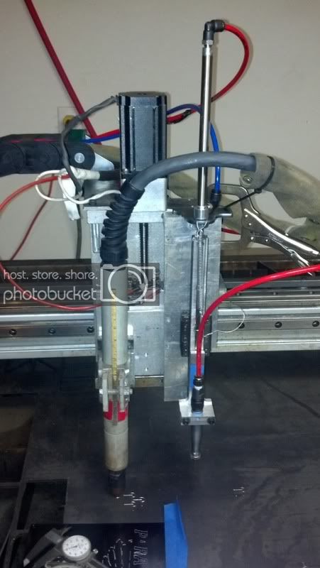

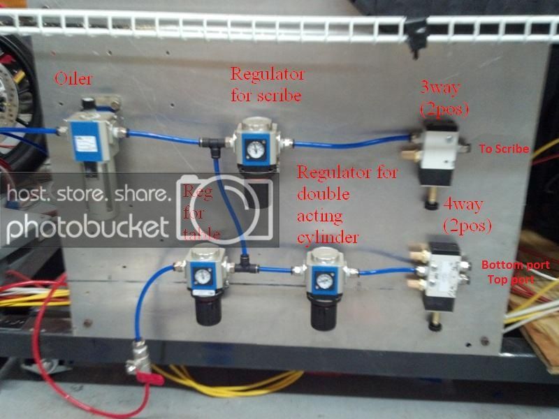

- thefabricator03
- Visitor
10 Aug 2019 01:04 #141831
by thefabricator03
The way I have my system setup I need two signals, One to turn on the scribe and one to turn on the downward motion of the scribe holder.
Although I have read that some guys get away with one signal for both. I like my setup as I can test each part of the system separately.
Replied by thefabricator03 on topic Air Scribe with PlasmaC
Do both air circuits operate from the one signal or is a separate signal required for each air circuit.

- thefabricator03
