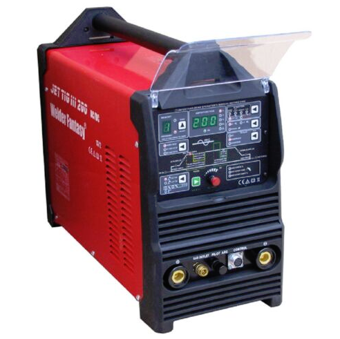

- tecno
- Posts: 1850
- Thank you received: 127
20 Aug 2019 11:03 #142584
by tecno
Replied by tecno on topic THCAD
- robertspark
- Posts: 915
- Thank you received: 216
20 Aug 2019 11:08 #142585
by robertspark
Replied by robertspark on topic THCAD
I've got one of those... but it's only tig
- tecno
- Posts: 1850
20 Aug 2019 11:13 #142587
by tecno
I really like this one a lot. Have torch with Amp setting and footpedal, like the low A start capability on this welder.
- robertspark
- Posts: 915
20 Aug 2019 11:21 #142588
by robertspark
yes I like mine too
this is mine manuals are all on line
www.r-techwelding.co.uk/tig-welder-ac-dc...-digital-tig-210ext/
