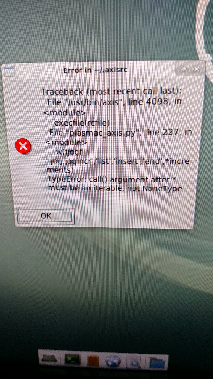

What does the popup say?
Can you try to run from a terminal then post all the terminal output form the linuxcnc command to the end.

note: MAXV max: 5.000 units/sec 300.000 units/min
note: LJOG max: 5.000 units/sec 300.000 units/min
note: LJOG default: 5.000 units/sec 300.000 units/min
note: jog_order='XYZU'
note: jog_invert=set([])
File "/usr/bin/axis", line 4098, in <module>
execfile(rcfile)
File "plasmac_axis.py", line 227, in <module>
w(fjogf + '.jog.jogincr','list','insert','end',*increments)
TypeError: call() argument after * must be an iterable, not NoneType

21 Aug 2019 13:19 #142721 by rodw
Replied by rodw on topic 7i96 and PlasmaC Permission Denied
but there seems to be some stuff missing. Nothing is shown below the Axis on the left of the screen. The monitor panel, button panel and control panels also are missing.
Thats pretty normal if there is a python error in a screen handler. I'm sure Phill will get to the bottom of it now as the error tells him exactly where to look.
21 Aug 2019 22:18 - 21 Aug 2019 22:26 #142745 by phillc54
Replied by phillc54 on topic 7i96 and PlasmaC Permission Denied
At this stage your best bet is to make a copy of your config directory as a backup.
Pull the latest version.
Run the Configurator from a terminal , this way if the configurator outputs any errors you can see them in the terminal.
Run a New configuration with the same name you used before so it overwrites that config.
Sorry, I think I had a shocker over the last couple of days...
Edit: If that doesn't get you going could you zip your complete config directory and post it.

22 Aug 2019 01:46 #142756 by phillc54
Create a base machine with the 7i96 configuration tool and get it completely running without any plasma connections.
When you are happy with the performance then use the PlasmaC Configurator to create a new config based on the INI and HAL file of the base machine you have running.
I would suggest to run the Configurator from a terminal so you can catch if any errors occur.
I would be happy to have a look at the INI and HAL file of your base machine before you run the PlasmaC Configurator.

22 Aug 2019 04:12 #142770 by phillc54
I changed one line in the HAL file. It was the same one giving you problems before. It seems there may be a problem with the 7i96 config tool when it formats this line. You should probably ask about that on the forum.
I commented out the PYVCP = plasma.xml line in the INI file, PlasmaC uses GladeVCP for it's panels.
I have no clue what the [INPUTS], [OUTPUTS] and [OPTIONS] sections are. They may be for the 7i96 config tool to keep track of what it has done. The shouldn't create any problems.
I also see a reference to an io.hal file, could you post that please.
Wait until I check the io.hal file before you continue.
