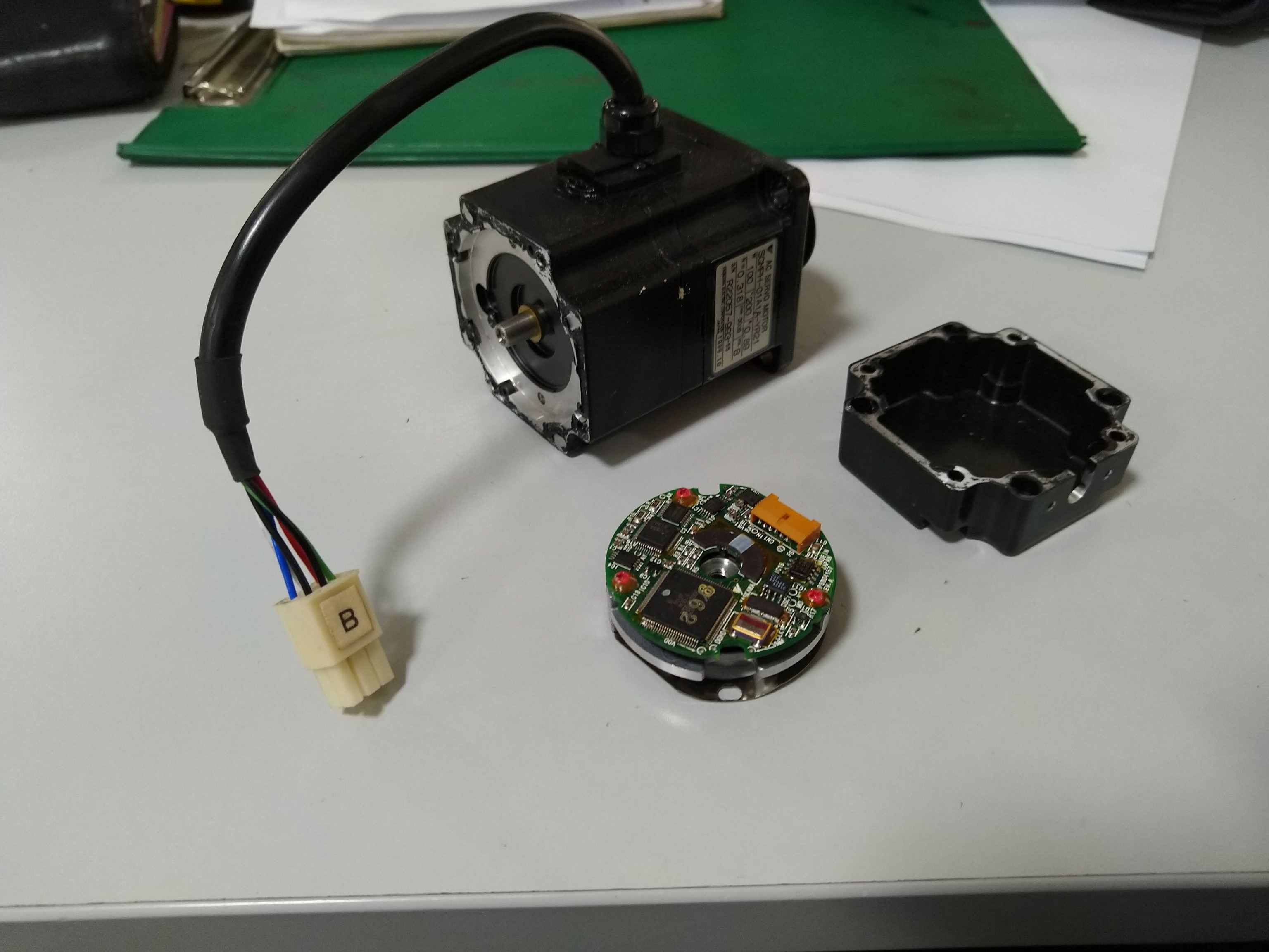

I agree he should test them first by hand to determine the type of motor,
But just thinking out loud based on this AC servo I have on my desk, the encoder is mounted behind the motor frame with a cap cover.

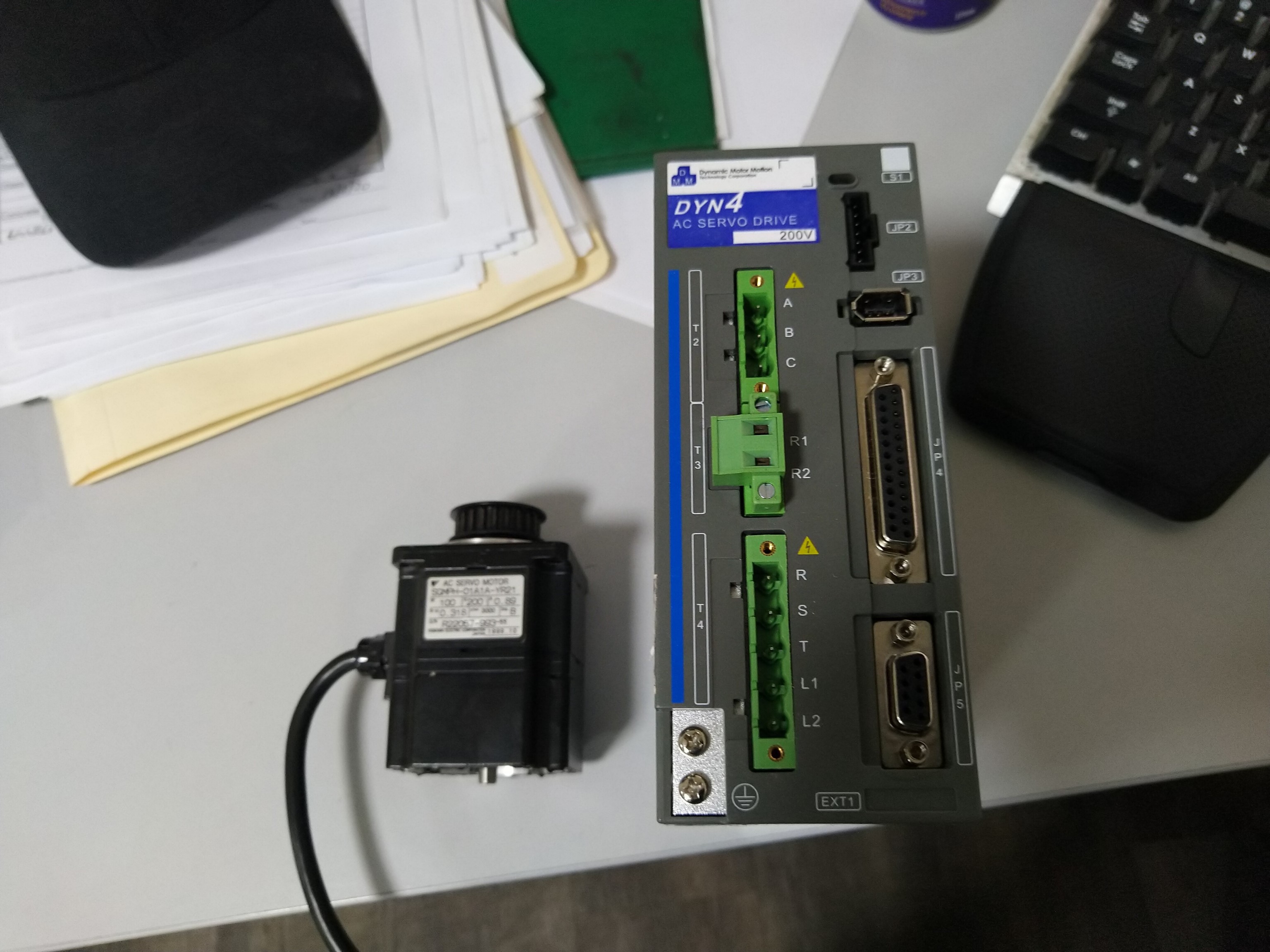

Not to hi-jack OP''s thread (although I am good at doing that) but its funny you mentioned DMM.
I have this drive on my desk that I am about to use to retrofit some old Yaskawa AC servos. If this works out like I hope it will be a viable work around for my old AC servo motors. Although I need to fit the DMM absolute encoders, the encoder is not very expensive. The guys at DMM have been very helpful and have explained how they use the DYN4 drives with other makes of motor.
Replied by thefabricator03 on topic Rebuilding Plasma CNC
i had to laugh a little when i seen this. i posted on cnczone to someone who asking for an opinion between clearpath and DMM . i told them i would go with the DMM with a DYN4 drive and have a real servo system in stead of something i would consider a closed loop hybrid stepper system in the clearpath as a choice.
