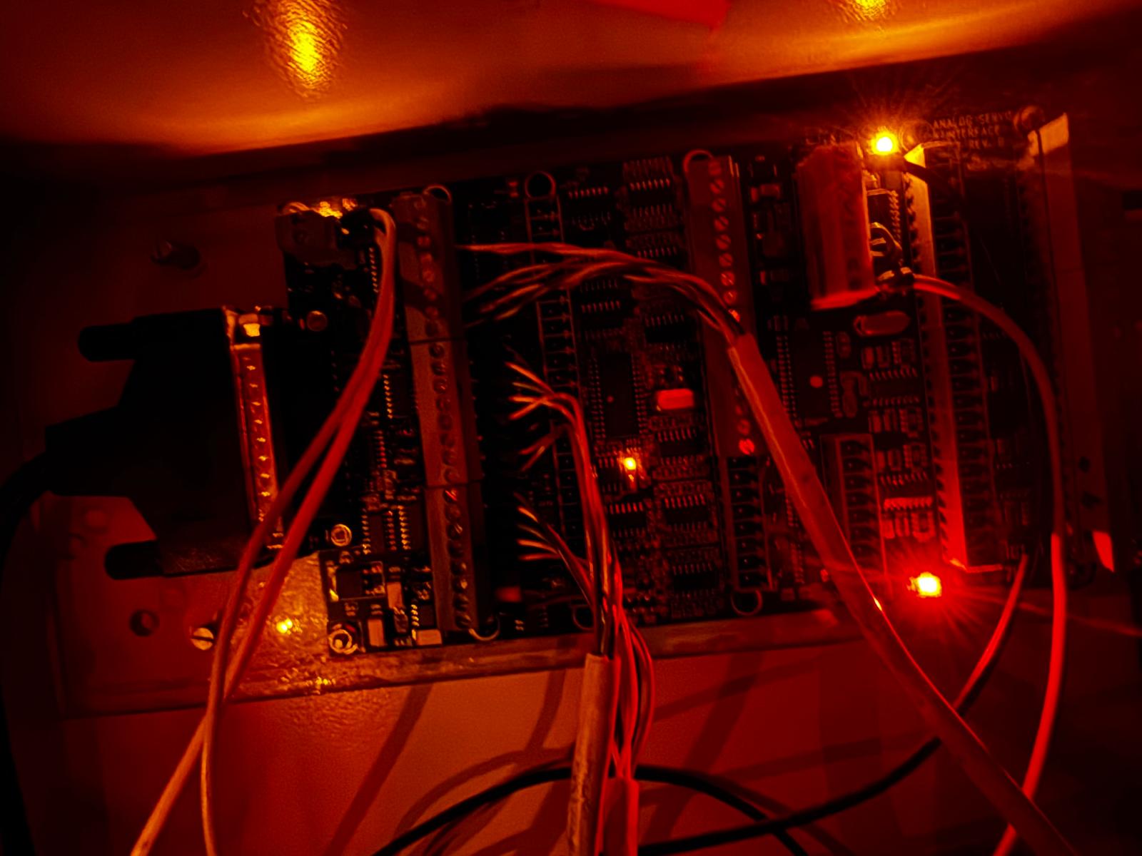

10 Jul 2025 22:41 - 10 Jul 2025 22:59 #331678
by Esaber
Replied by Esaber on topic Esab Ultrarex UXD-P2000 Upgrade Project
I see. This happened after we tried to cut with max 105amp current on the plasma to be able to cut 20mm.
I can replace any parts if you give me the part numbers. This is the second 7i77 !! It took more than 2 months I think to get this one.
And I will need any useful guidance you can think of to avoid this kind of issues in the future, please.
The mesa 5v is now supplied by an external power supply. It was provided by the pc psu up till this issue occured.
So to sum up the current situation:
When i click machine enable linuxcnc detects voltage on aout0 and aout1 and activates the soft estop. This explains why even when I disconnect the analog outputs the machine does not jolt but linuxcnc still thinks the machine is running away. Am I getting it right?
and here is a picture of the mesa leds. One red led on the bottom right side and the others are yellow.

10 Jul 2025 23:37 #331679
Replied by PCW on topic Esab Ultrarex UXD-P2000 Upgrade Project
OK there's only one yellow LED on in the center of the board.
so that means analog power issues.
Most likely problems are:
U33 (74ACT04) bad ( can be damaged by a 5V surge to 6.5 or 7V )
Q3,Q4 (FDN337,NTR2101) bad ( can be damaged if U33 fails )
A bad OP-AMP = U3,U8,U14,U20,U28,U35 (MC33179) for channels 5,4,3,2,1,0
Note that if an OP-AMP failed, it's most likely the ones you had
connected.
I would try replacing U33 first and then rechecking.

12 Jul 2025 23:25 #331740
by Esaber
So I replaced the u33 and still no luck.

19 Jul 2025 20:49 #332036
by Esaber
So I found a 7i77 on ebay. Put it in and all is good. I then tried qtplasmac and converted the old file to qtplasmac but no luck enabling the machine ! I did set the estop button to mode 2 but estop does not move and power button does not move. Same ini file settings work fine in linuxcnc axis mode. I have a physical estop by the way.
