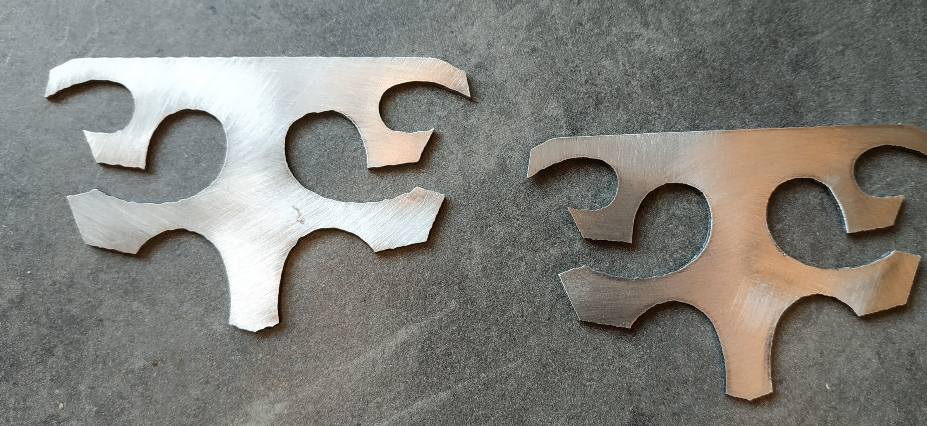

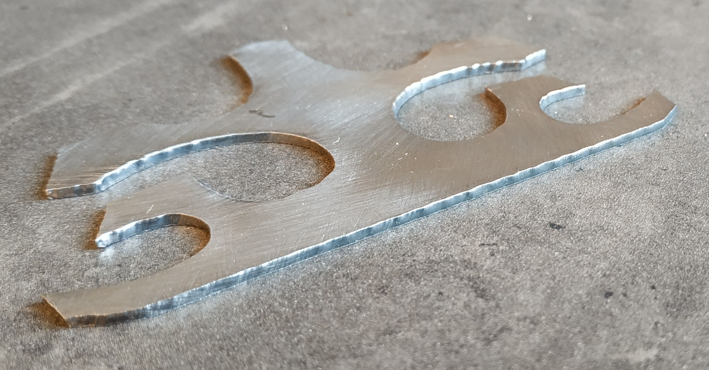

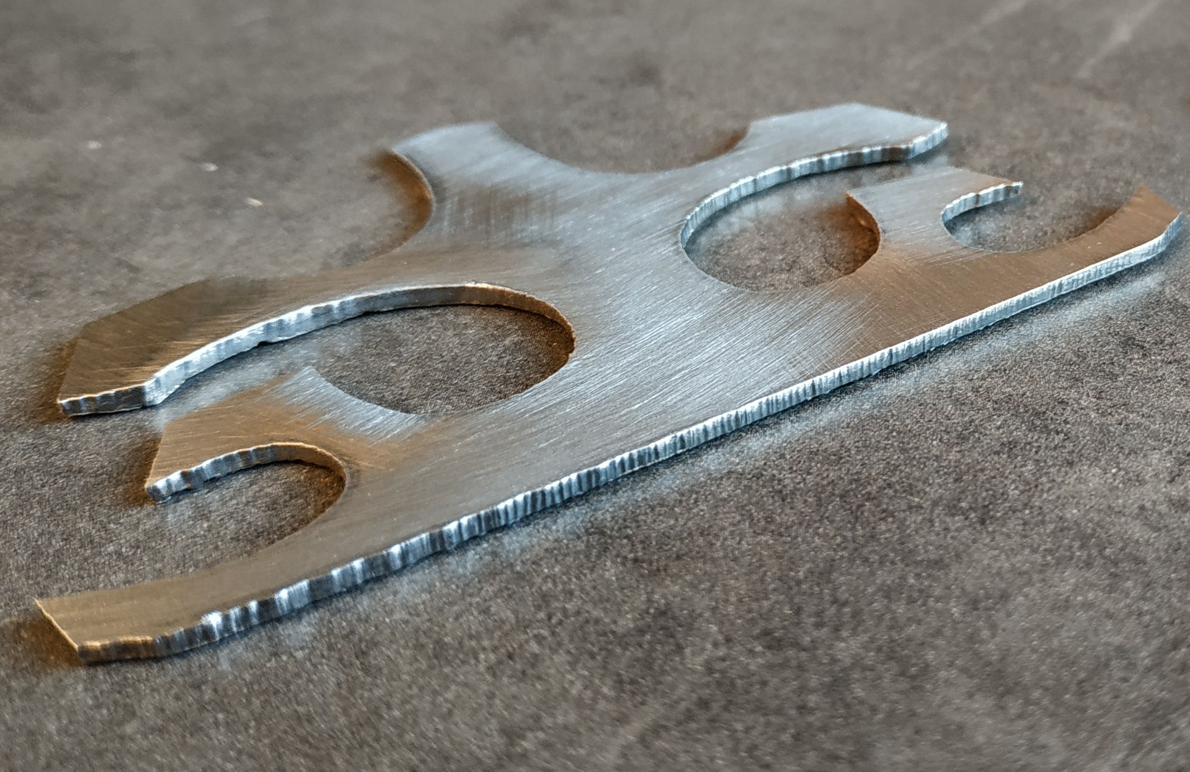

I have upload a video with the issue and some pics of a testcut
file.io/VjqzlbHP0nJc
I am not really happy with the result.
This is cut with 1000 mm / min
and this with 2000 mm / min
What do you thing is the problem, is the machin not stiff onough?

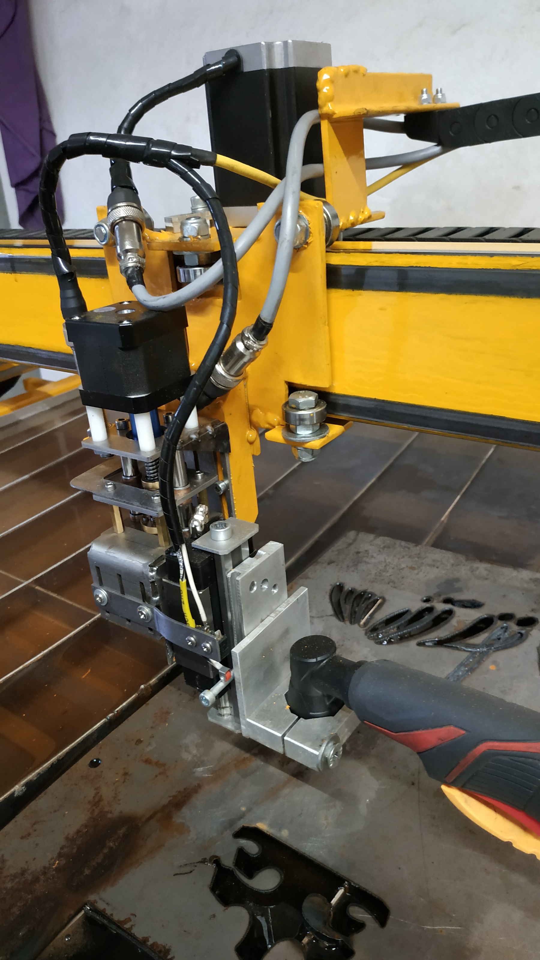

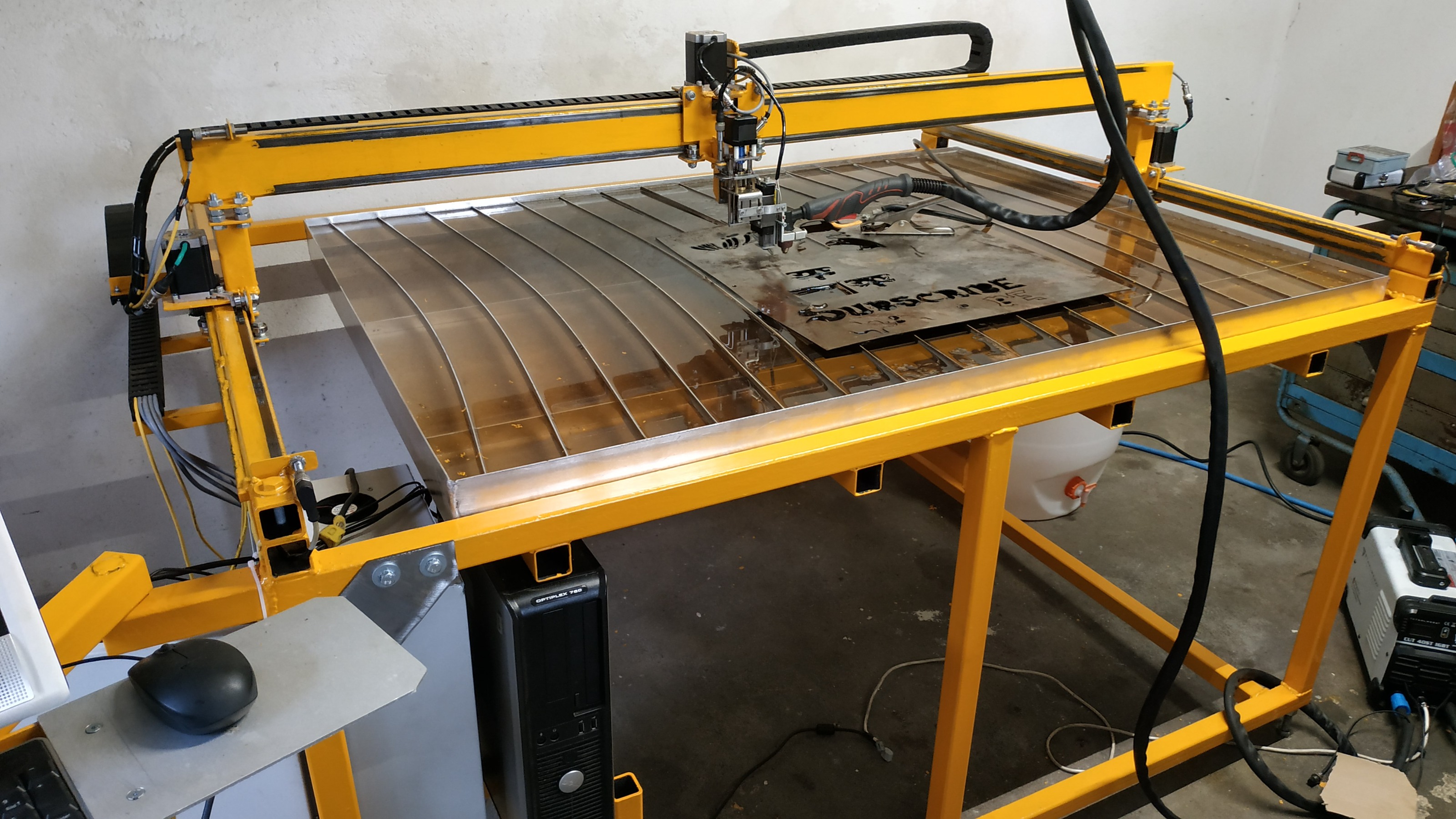

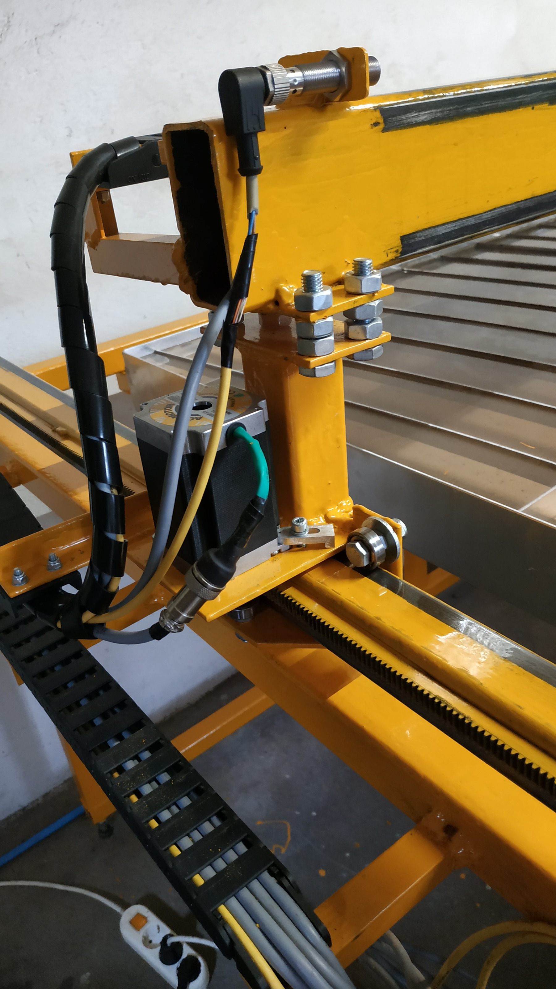

- Posts: 22003
- Thank you received: 7488
11 Jul 2021 07:36 #214236
Replied by tommylight on topic New Plasmacutter
Pictures of the machine ?
That is from vibrations for sure, but what acceleration are you using ?
Try lowering accelleration a bit, but anything under 200mm/s/s is to low for cutting thin sheets.
