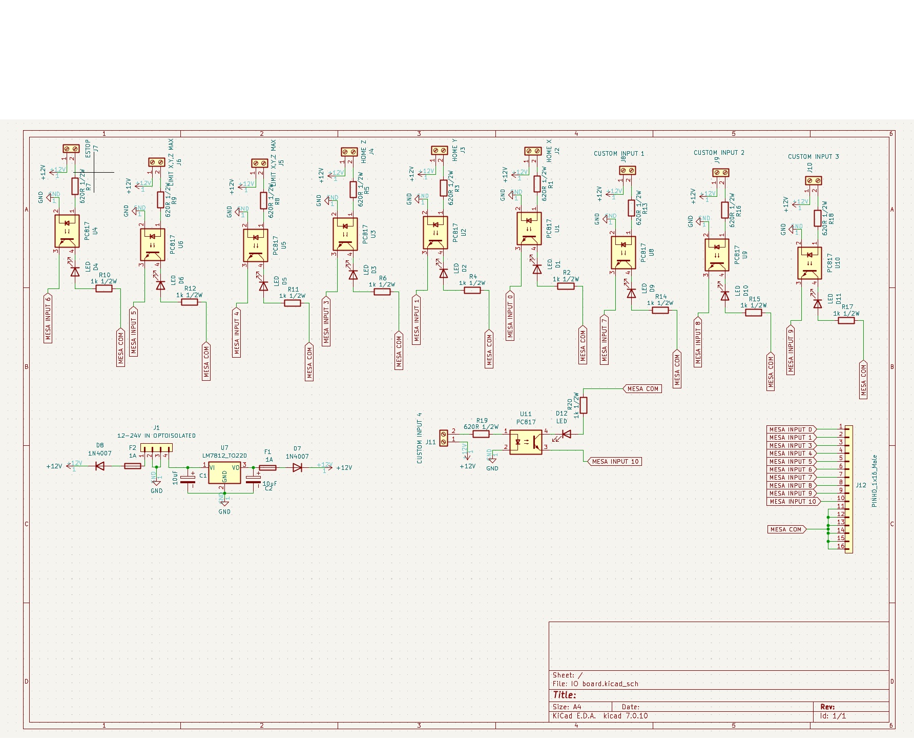

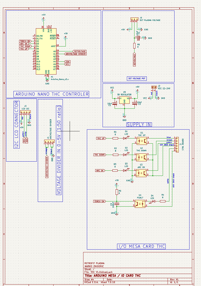

Here are some of my designs do you have any recomendations?I am planing to use 7i96,Kind regards

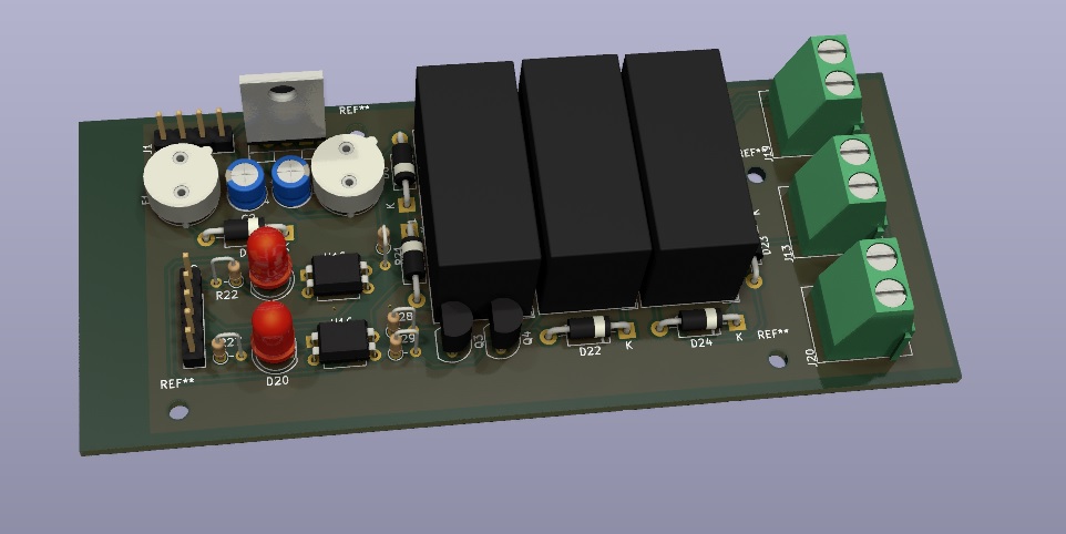

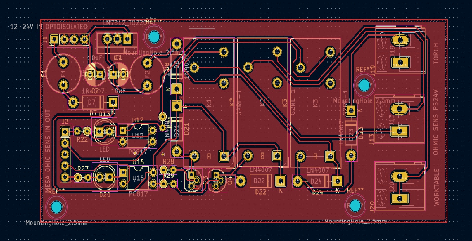

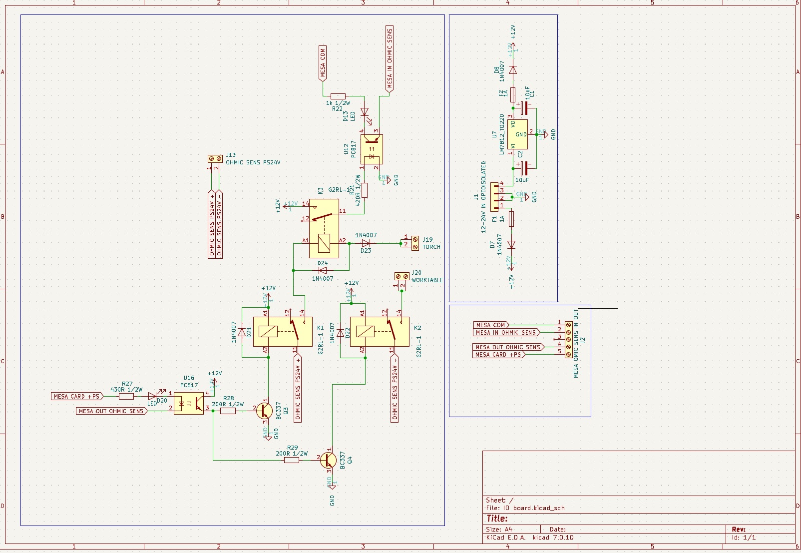

My idea for ohmic probing.
See attached pictures
Kind regards
Kind regards
