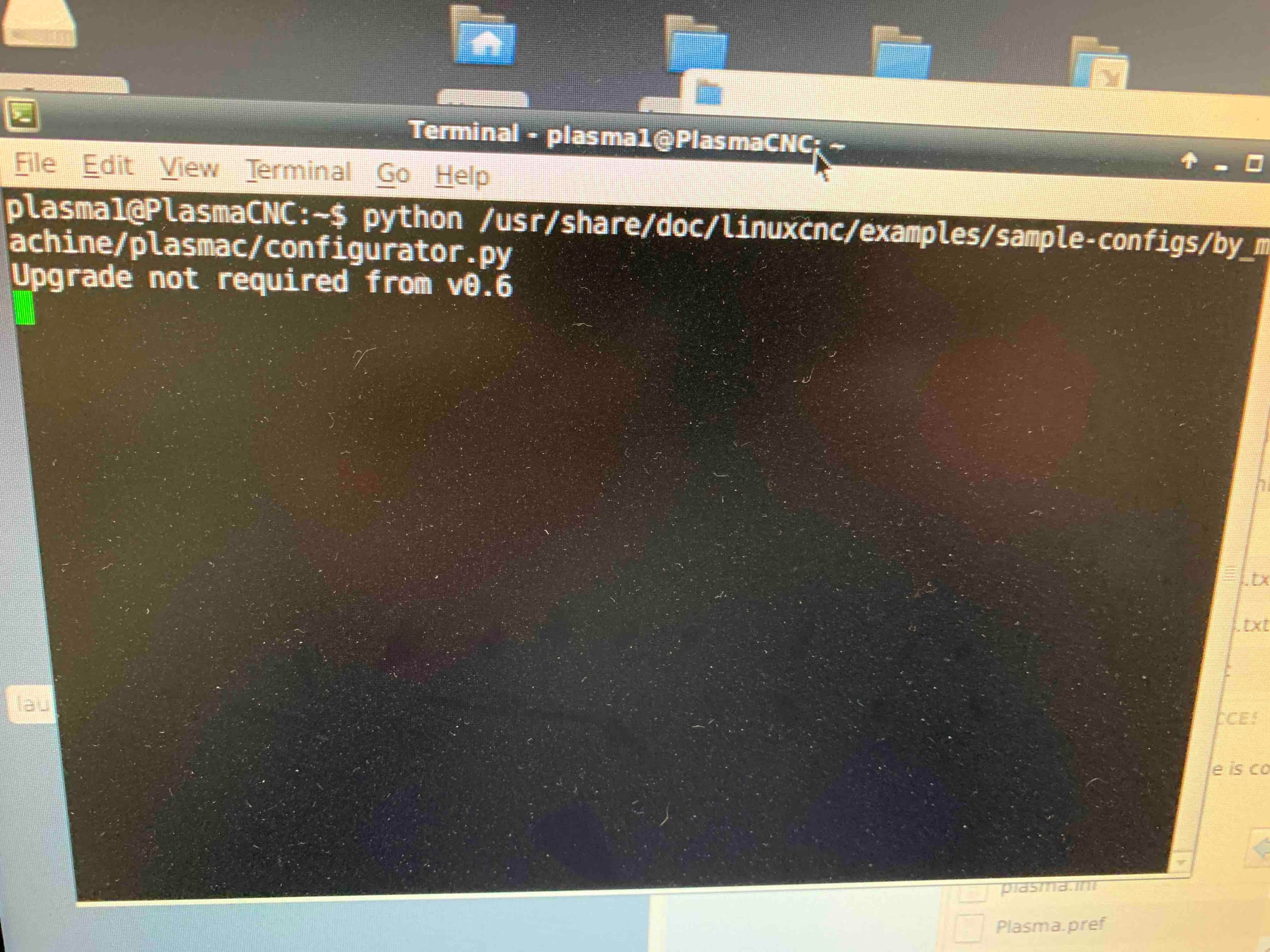

I am trying to make sure I have the most up to date version of PlasmaC as recommended after a LinuxCNC update.
I ran the configurator.py from terminal, and I get "Upgrade not required from v0.6". I'm confused because according to the version history, Plasmac is on V0.86. Please see the attached pic for reference.
Am I doing something wrong?

No, it is all good.
I am doing something wrong.
Every time I update I increment the version BUT the configurator is only required for some updates so it has only been required six times.
It is on the todo list to synchronise those numbers.

No worries, thanks for the sanity check!. Now to get my Probe test issue straightened out...
