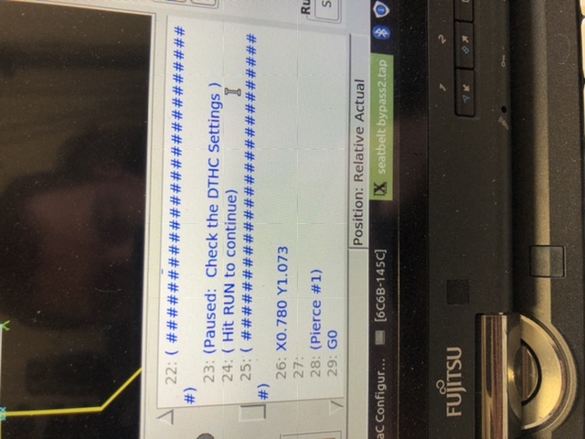

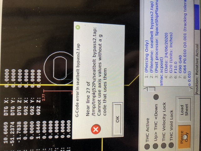

24 Jun 2020 18:44 #172609

24 Jun 2020 18:59 #172616
Replied by tommylight on topic G code error
The gcode is missing the obligatory G0/G1/G2/G3 before the X/Y/Z values, so that will not work on any machines.
What are you using to generate that gcode ?
- Nate
- Posts: 50
24 Jun 2020 19:28 #172619
by Nate
Replied by Nate on topic G code error
Sheetcam TNG
- Posts: 12159
- Thank you received: 4151
24 Jun 2020 19:32 #172620
Replied by rodw on topic THC not showing on screen
I think you are using the wrong postprocessor. Did you find this one?
forum.linuxcnc.org/plasmac/38438-plasmac-post-processors
