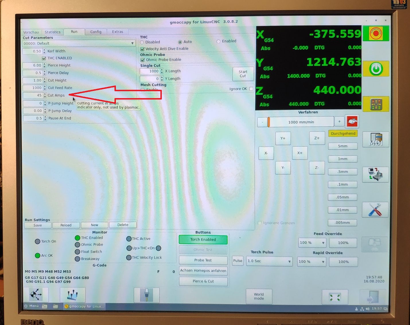

Hello,
I would like to ask whether it is still possible to transfer the current value from the cutting parameters to a plasma generator via a 0-10V analog output?
I have a Telwin Plasma 100 which can take the current strength via a 0-10V input.
According to the field description, this is not intended in plasmac. Is there a reason for that? Can it still be activated?
Many thanks.
Hermann
Many thanks.
Hermann

PlasmaC only uses the cut current if you have Powermax RS485 comms enabled.
You could use the associated HAL pin to do what you wanted, there are two pins available:
1. a float pin named plasmac_run.cut-current-f
2. a S32 pin named plasmac_run.cut-current-s
