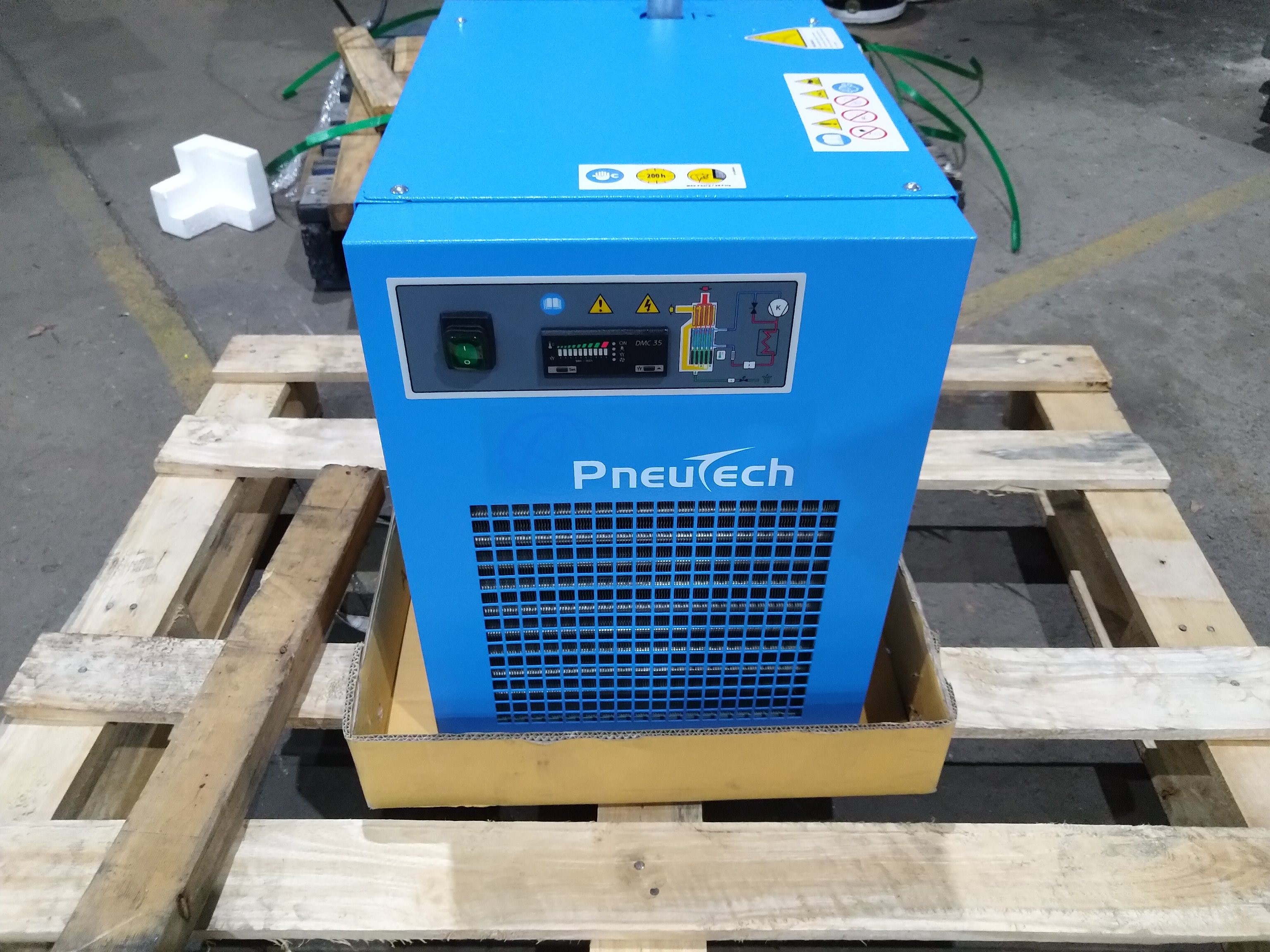

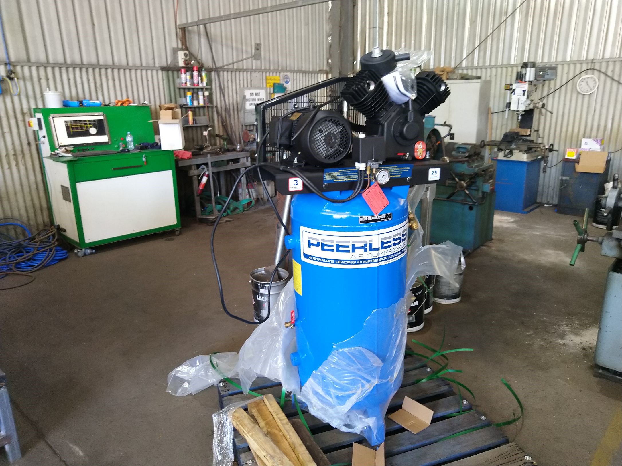

Just to add to Toms wisdom, When in doubt buy one of these
And dont forget the dryer!

Those should do nicely !

I have learnt the hard way about how much air plasma uses. Our larger compressor has a very hard time keeping up with running workshop tools and the plasma at the same time. When the plasma is working all day it really cops a flogging!

Very true. But the up front cost turns people away. When you look at the fact that they produce dryer air and you can get away with a much smaller dryer they start to look better.
