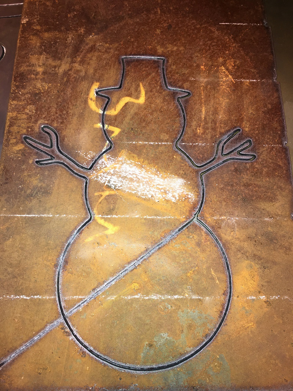

Another lame question from a complete newbie - I have done two test cuts from g-code so far.
After a fresh start of LinuxCNC, when I load g-code, home all, enable torch and start cut by pushing the "play" button the head and starts moving but only X and Y directions. It does not probe nor cut.

So I've added M03 S1 to g-code and I've cut the first file - Christmas crib, all went fine, the torch was lowered and g-code followed,
Then, without restarting LinuxCNC I've executed Snowman's cut and the plasma torch was lowered at the home position, pierced the plate and the torch was on and dragged to the expected pierce position and then the cutting commenced.
After the snowman, I've executed cut of the crib again and it did the same as on snowman - pierced at the home and moved torch at hight speed cutting to the first path from the file.
G-code of both attached.

In the folder where the Inkscape gcode is being saved, create a new EMPTY file and name it "header"
Inkscape will have an M3 always at the top of gcode, so the above will make sure not to have it.

Hi Tommylight, thank you for your help.
I will remove the code above and try to cut again.
(Header)
(Generated by gcodetools from Inkscape.)
(Using default header. To add your own header create file "header" in the output dir.)
M3
(Header end.)I will remove the code above and try to cut again.
