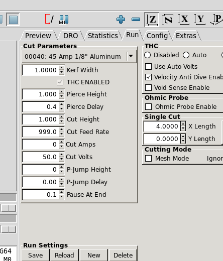

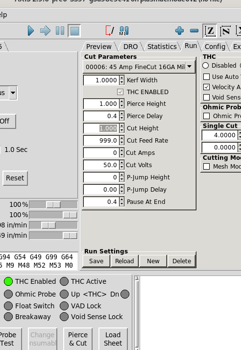

Hello, I need help with toolsets. I've added a toolset from the sticky to sheet cam and it appears to work. But when I add the same tool set to Plasmac they do not come across the same - almost everything is set to 1.0000. Thanks.

The tool file and the material file you posted match up with each other except for material #7.
The images you show do not correspond with the material file you posted.
When you saved this material file did you give it the correct name and did you put it in your config folder.
The file name should be <machine_name>_material.cfg

18 Jan 2021 02:32 #195743
by phillc54
Replied by phillc54 on topic toolsets
I think you need to run the materialverter again but you need to select imperial output.
